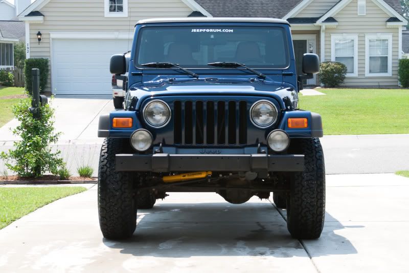

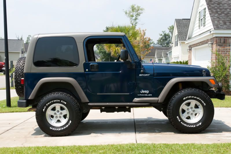

My friend, Jon, helped me add the OME 2" lift, and I bought the BFG's today. Don't think I need the body lift.

Looks clean. But you might be able to get away with a 1" MML and 1" BL to get rid of your tummy spacers

I have those parts in my garage. Haven't decided if I'm going to put them on yet...maybe.

Looks nice.
i needed the body lift to keep the front tires out of the fenders. flex out the front and chances are your going to run into the same thing. additionally, if/when you add weight to the front with a bumper and winch, the extra space will be nice to have. you could always go with a 3/4" spacer in the front to level it out some.
what OME lift did you go with? light, medium, HD?
how do you like the ride?

I went with the Medium. I may add the lift for these reasons and because my spare hits the rear bumper. It's riding really well and the new tires got rid of my death wobble. To "correct the geometry of the front," the guy that put on my tires said I should get a new front track bar bracket, pitman arm bracket and longer stabilizer links for the front, but I think it's riding fine. He didn't think the tires would cure the wobble, but so far, so good. Any thoughts there?

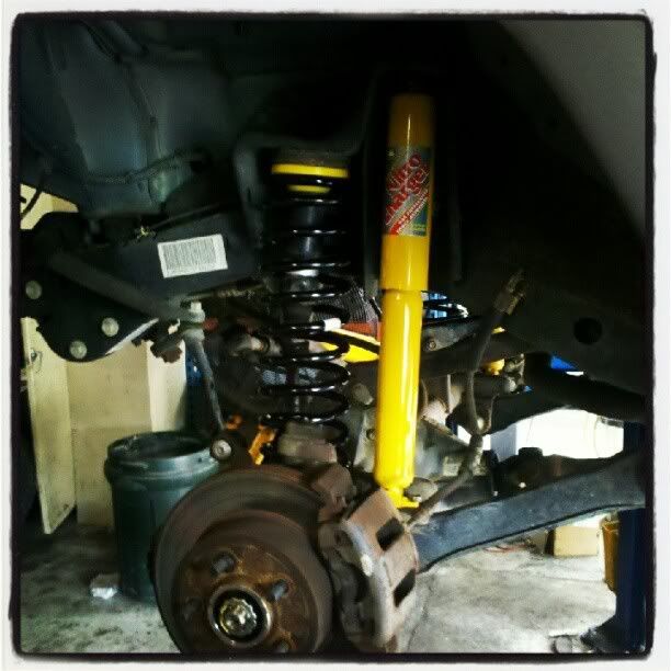

Also, here's a pic of a front shock and spring.

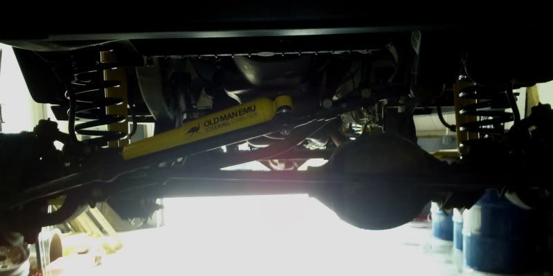

Here's a bad cell phone photo of the front suspension, taken when the Jeep was on the lift.
