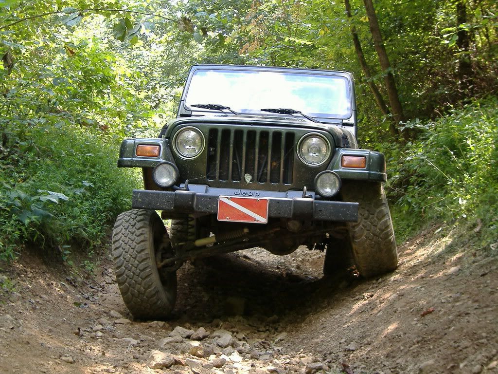

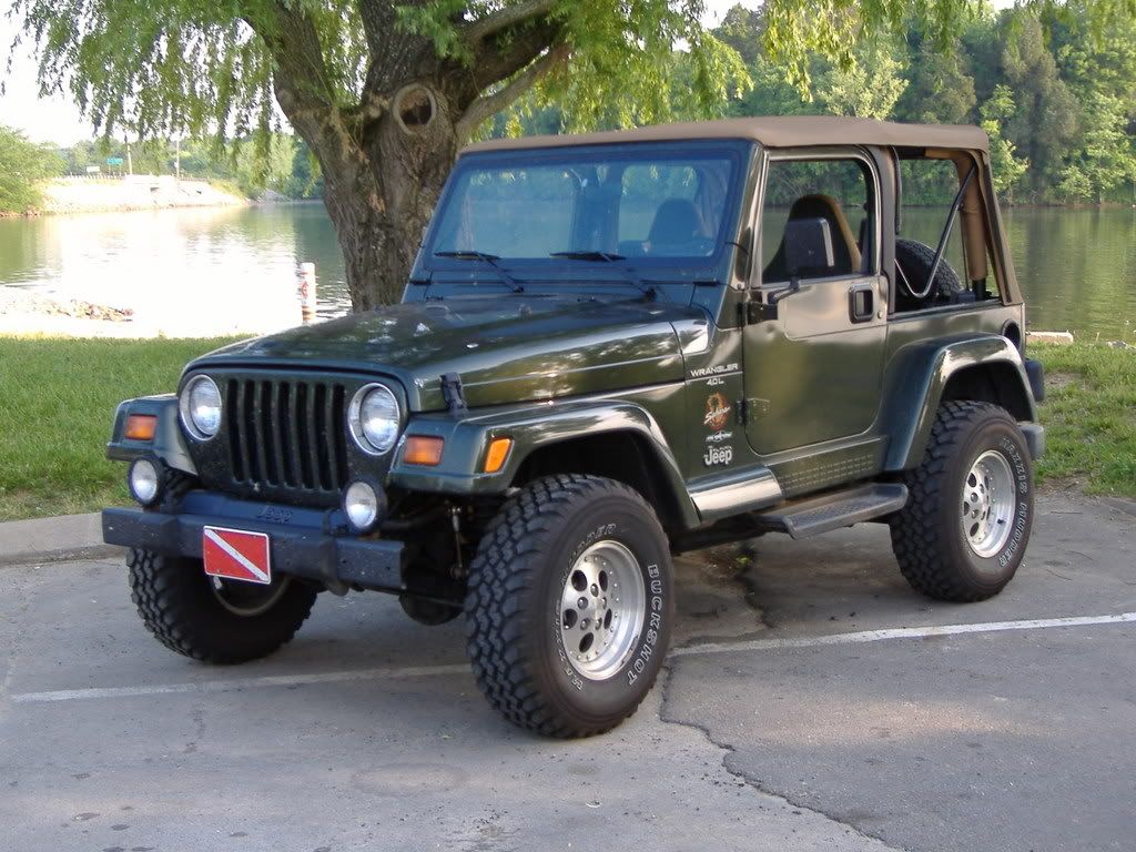

Here are some old pics for you. It technically has 3" lift, 2" BB plus 1" BL. The tires are 32x11.50xR15 on the stock rims. I had to use wheels adaptars to get the backspacing right. If you need some more info on this set up, tool around www.4x4xplor. He has some good write ups on this mod.
