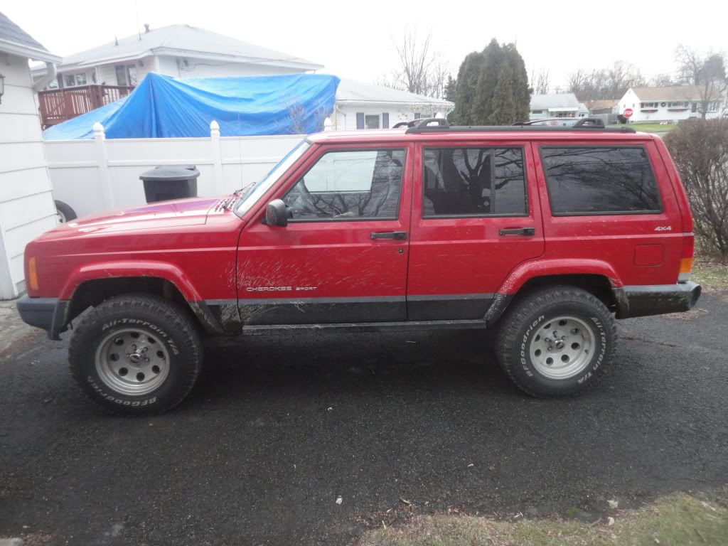

I am not going to try and tell you which is better because I really don't know. All I can do is tell you that I have had the Rocky Road Outfitters 2" budget boost on my XJ for about five years now. It has proven very durable and the ride quality has not changed. I have run 30" M/T's since the install and rubbing only occurs at max flex.

I have spacers in the front and add a leaf rear. it's fine and i clear 30" tires. needed to trim just a little

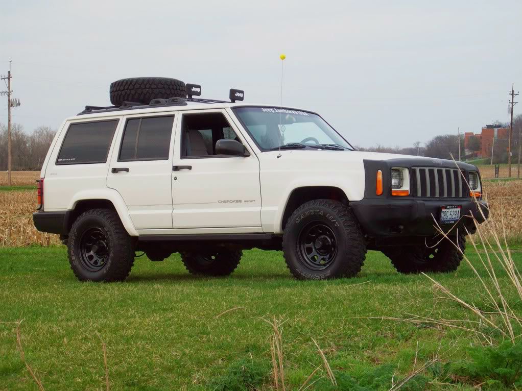

2.5" Full Old Man Emu suspension... rides oh smooth!
If you plan on bumping up your suspension in a year or so after you install the 2", I suggest you just go with a coil spacer and AAL. For me though, I know I wanted to keep this height for the next few years so I didn't mind spending a little bit more money on top notch suspension components.

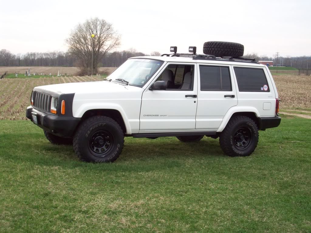

Thanks a lot! I am was really considering the rocky road 2 inch lift, did you get the complete lift or the slightly cheaper one? and thanks I had really been wondering about if i needed to do any trimming with 30's. (to the second white Jeep) what did you trim?
cwashka is offline   Reply With Quote
Unread 12-18-2011, 10:22 PM   #6
MCObray
Location: Orygun
Posts: 1,527
No trimming needed. I rub a little at full turn on the control arms, but when flexed I am tucked in the wheel wells.

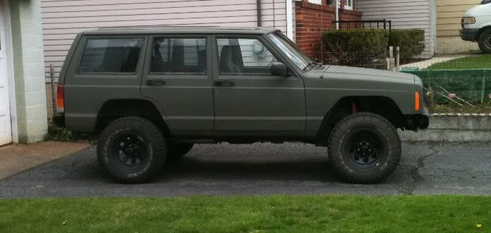

I have 2" spacers up front and 1.5" Shackles in the back. I replaced the rear leafs with rancho springs because the stock ones were sagging horribly...I think they added around 1 inch of lift so I have like 2.5" in the back and 2" up front. I also trimmed extensively. I'm running 31x10.50's with no issues an ample room.
