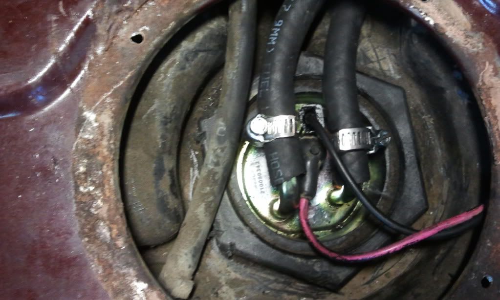

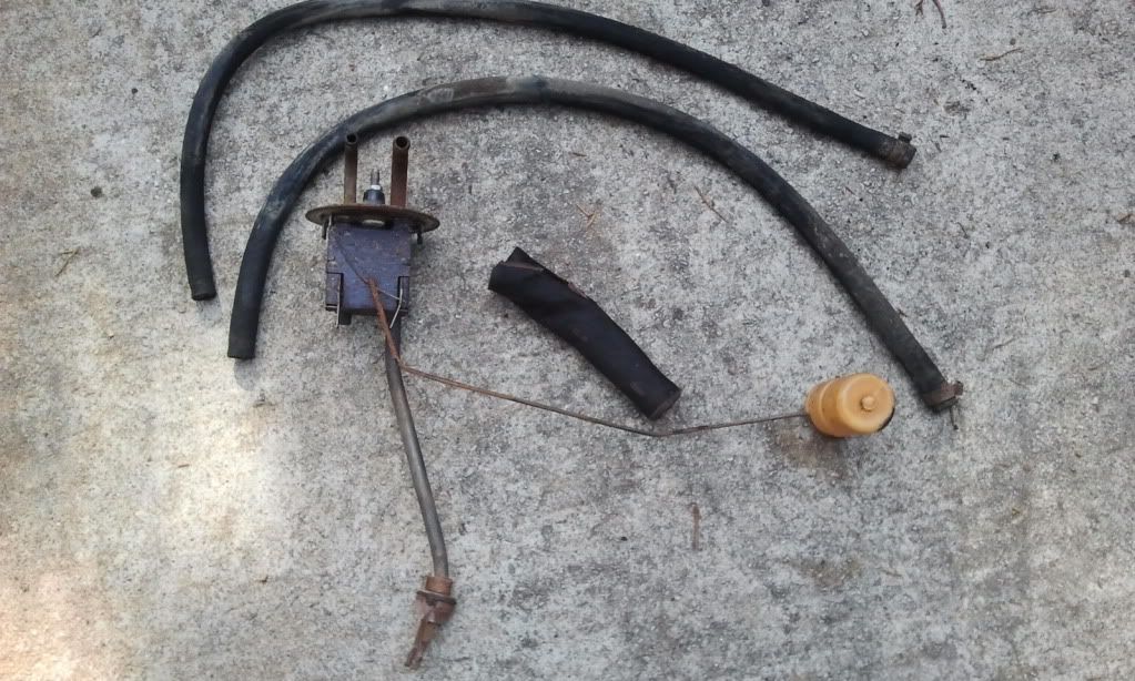

Replaced the original fuel tank sending unit and all the lines. The lines were on the verge of disintegrating in my hands, and the filter sock was gummed up and torn. I guess the tear was the only way the fuel could get by- seems like the truck starts much easier now.

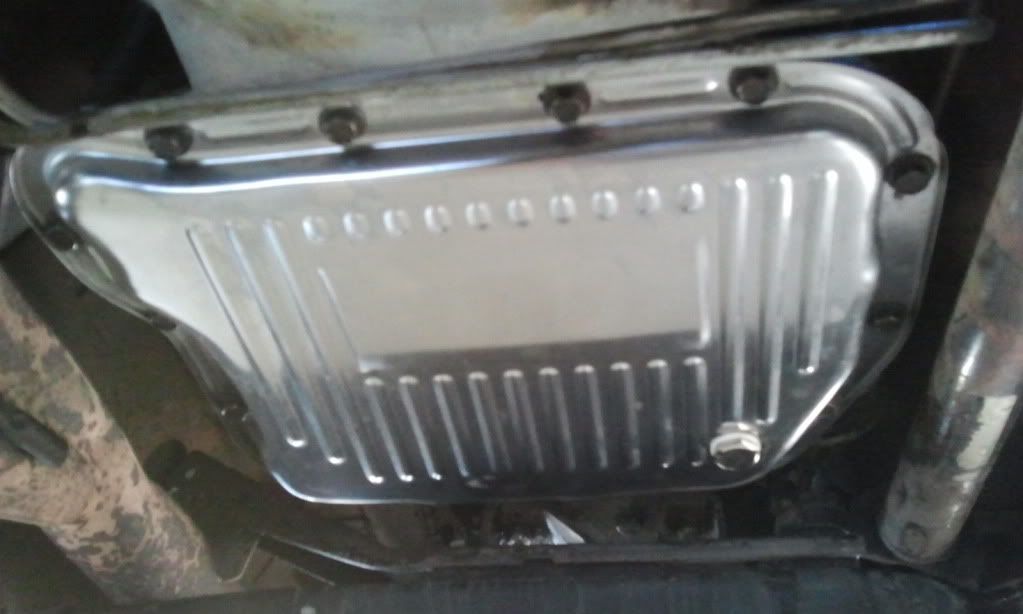

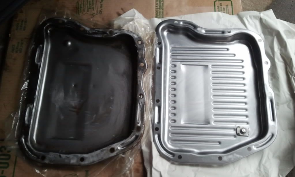

Then, I added a shiny new trans pan from Rock Auto to replace my old bent, warped and ground down old pan. It set me back a whole $21 plus has a drain plug.
