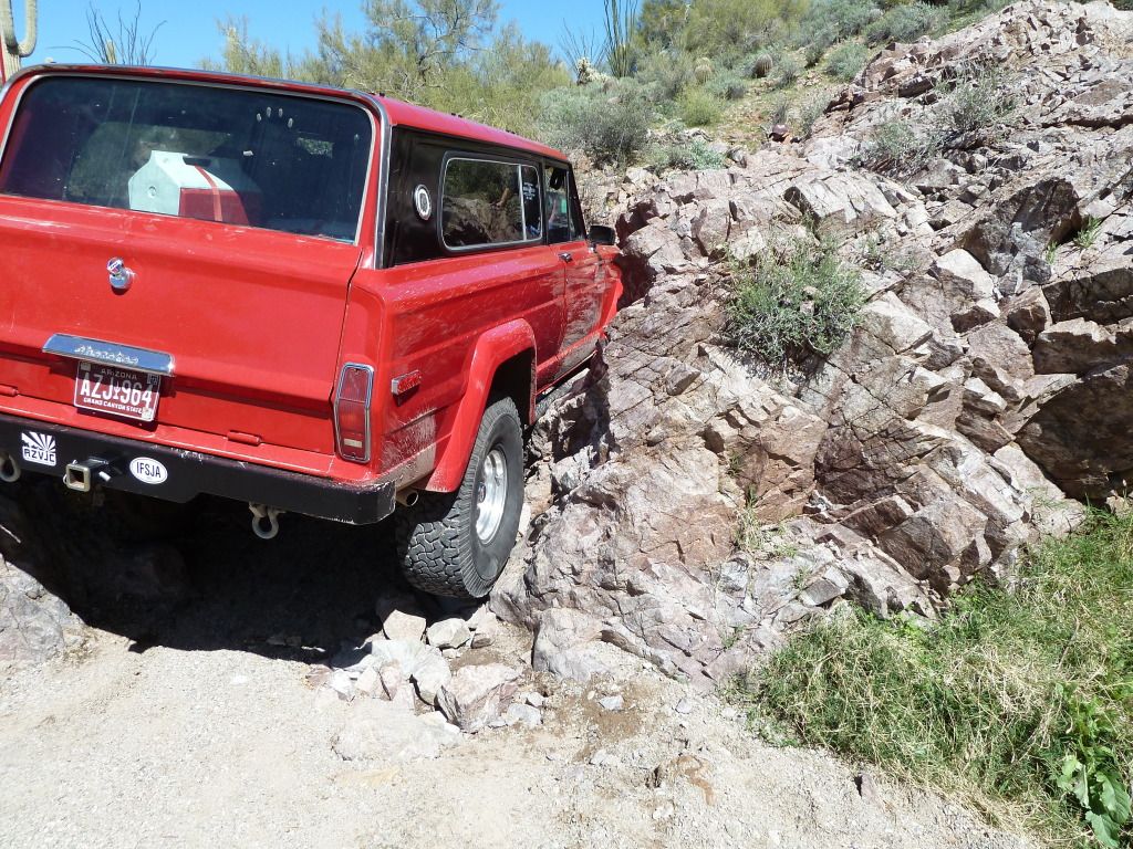

Cool. It looks like you are set up to go wheel'n. Here in AZ exhaust exits in front of the rear tires would get crushed:
Here is a poser shot but you can see once Imove forward that rock is close
Imagine this slider as your exhaust tip
I ran single above the rear spring. Again, a exit in front of the tire would not have survived this:
Here is a better shot of the exit
I haven't smacked it yet.... yet.
So just a thought, if you are going to wheel it, form should follow function(ality)
Well. In East Texas I don't encounter too many rocks. Just tree roots and stumps. I don't seriously wheel like that though. I would say the wildest I will get is deer lease trails and occasionally rescuing baby Jeeps at the offroad park in Gilmer.
I would plan on keeping them tucked up. Don't care how much is showing. If necessary I can put sliders on to cover them. Although I'm not sure how hot that would get. If 3" out the back is cheaper than duels I'm going for it.
