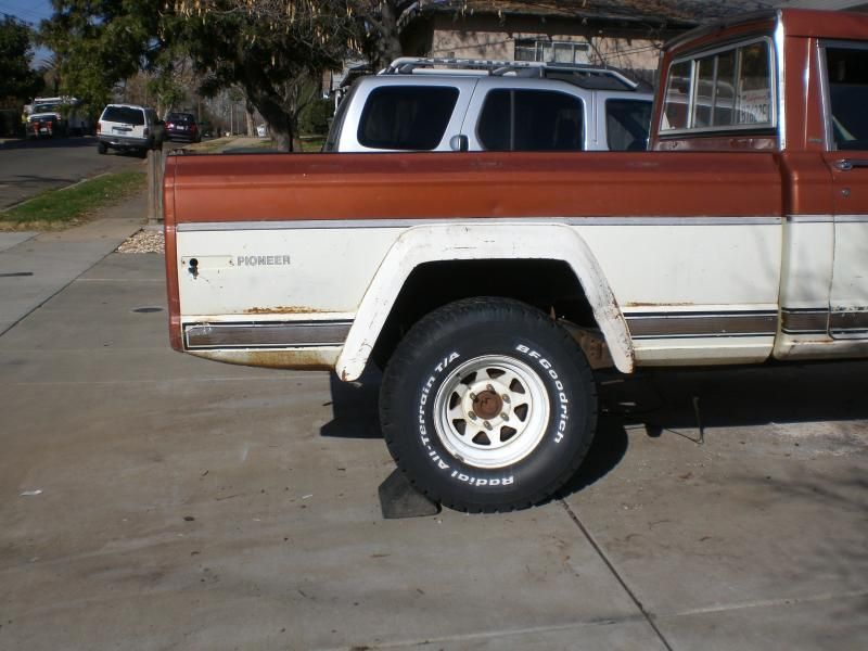

ok guys..so flame away..i have googled and searched til my eyes bleed...i am no computer guy...so here goes...i have my '74 j10 i have been slowly building/cleaning up...here's my question...after washing the underside n preppin for undercoat...NOT fun job. anyways..under the filth i see my springs up front say "RANCHO" in white writing on top of leafs...i currently have 32x11.5-15 meats on it from when i got it..i can include sum pics soon...wondering if or how i can tell what kit or lift is on this thing?? ANY help and/or patience with this j10 newb is MUCH appreciated! I have ordered my new wheels from summit and tire size/brand search is next....so BEFORE i buy 32'' tires maybe i have room for 33'' already! i didnt think i had a lift! shows what i may or may not know..learnin EVRY day on this thing....thanks guys! measure spring length maybe? heights of front and rear..axle? bumper? etc...

WOW! now that is one sweet J10! Thanks guys for the responses and help! Looks like i have 7'' from the very top of my worn 32'' bfg tires to fender wells..front and rear...cant find any numbers on the springs..only lettering...number may be under the axle...i see no blocks in rear...but maybe an add a leaf been done..? how many springs should it have stock..? any ways to tell if PO did an add a leaf...(good thing i held off on ordering tires and shocks!) yikes...pics comin...(WORTHLESS without em

Measure from the bottom of the fender to the center of the wheel/hub. This takes out any discrepancies in tire size and wear.

ok..looks like about 21'' from center of hub to top center (meaning closest to tire on fender flare of course...thanks guys! hopin this may help!

I just ran out and measured mine. It was a little difficult as the tires stick out further than the fender but it appears to be 22.5" front and rear (with a 3" spring lift).

Thanks a million! That definitely helps me..i had same problem..tires stuck out..i eyeballed it best i could..i was around 21-21.5''..im starting to think PO did sum liftin not exact on how much..but SOME! thanks again guys for all ur help..any further info/input GREATLY appreciated..i will letya know once i get her "done"..tires and wheels n such..wont look NEAR your beauty..but these J10's ALL are gorgeous!!.. rusty or showroom clean... glad to be a part of this! thanks all!
