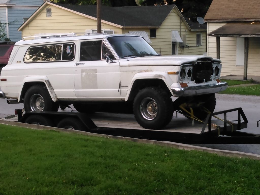

Picked up a 1980 Cherokee Chief, not bad shape, needs a motor and floorpans. supposedly was an Arizona State Parks vehicle before making its way to SW Missouri
I have a 360 to drop in it already so that's set, a few dents to pop out and floorpans.
I've looked at BJs and C2C floor pans, any suggestions on which way to go from y'alls experience?
BJs are twice as high but look primered and predrilled.
Its got some home fabbed shackle reversal and drop mount up front that I will undo to drop it back down. For now its just a motor, floorpans , and some interior to get it on the road for a buddy whos got no wheels

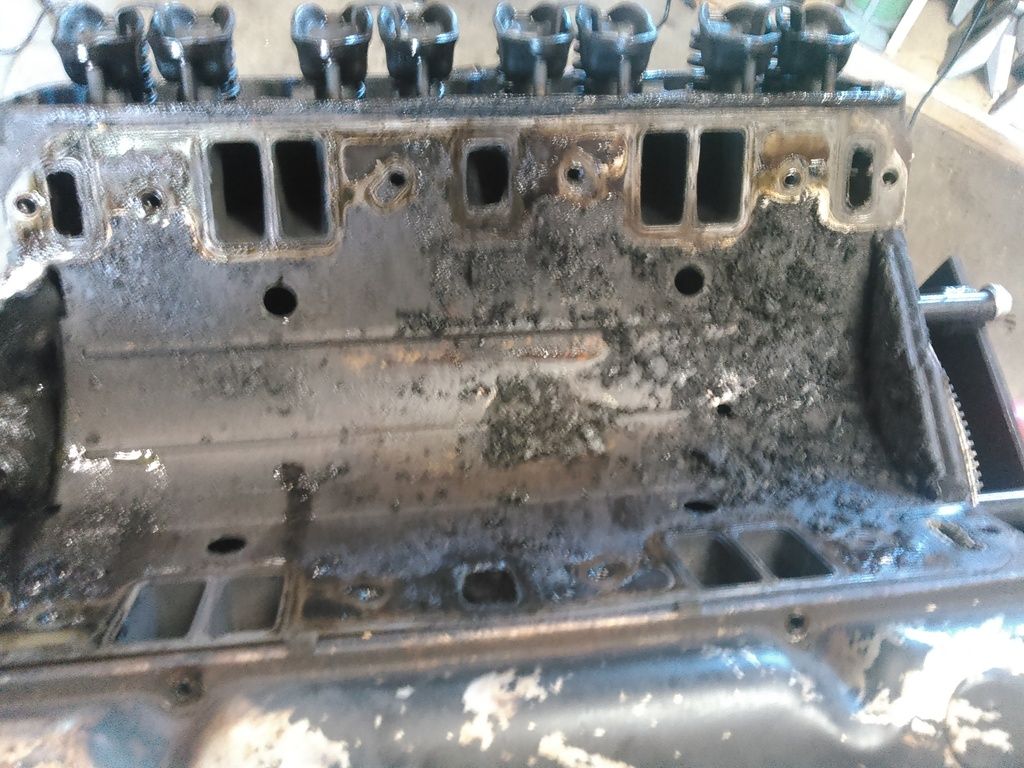

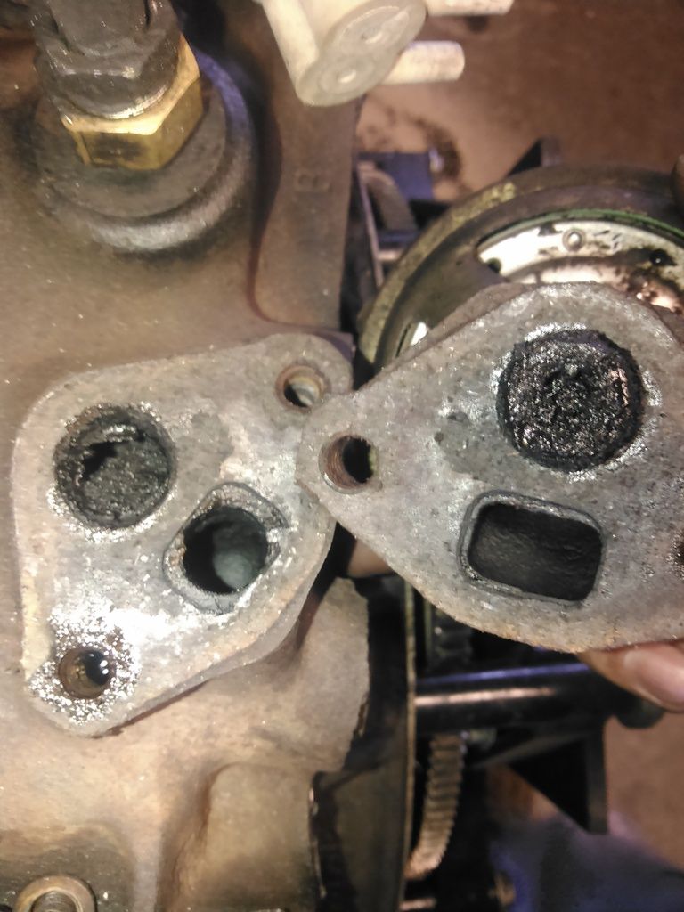

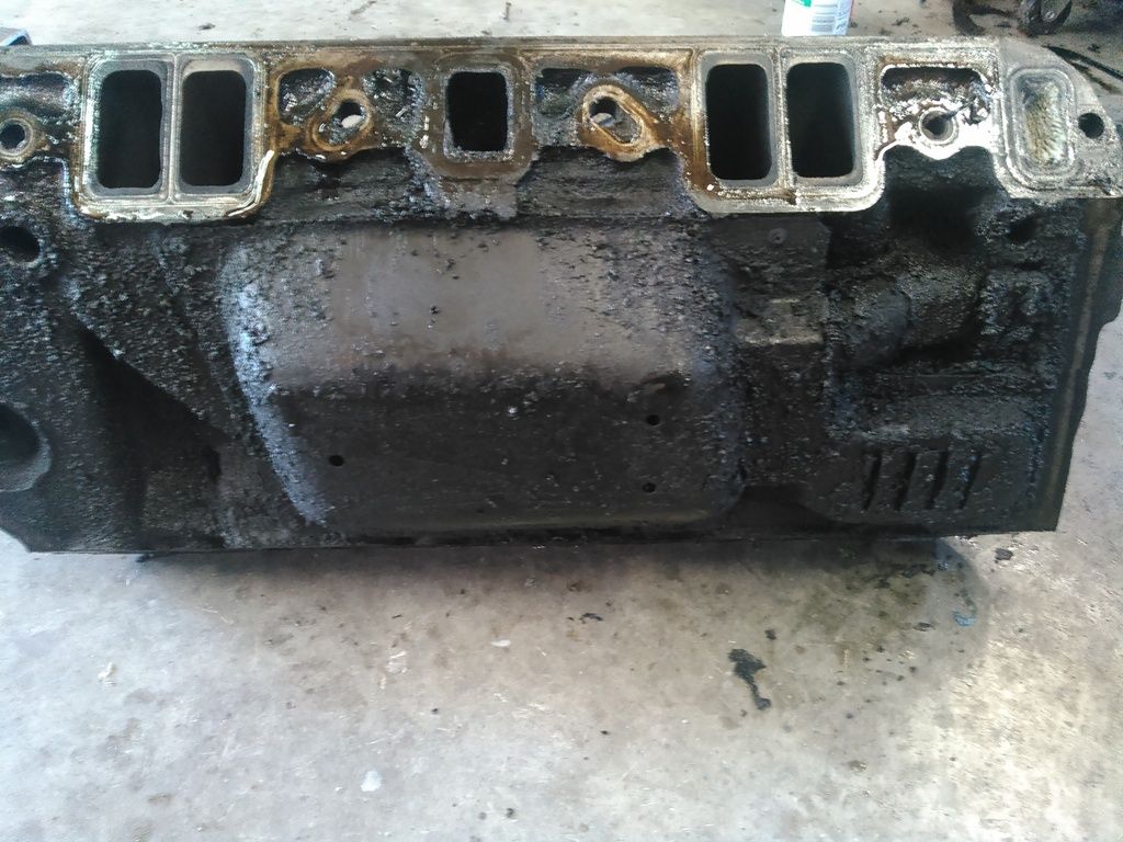

OK, little update. Got the 360 tore down to short block, all new gaskets and seals. Was all kinds of baked crud on valley oand and underside of intake. Cylinder walls looked in good shape besides the ridge at the very top 3/8"... a couple cylinders had excessive carbon on the piston tops, I cleaned all pistons and mating surfaces. Valves looked good and not much carbon on them.
What would cause all this buildup inside between valley pan and intake?
The EGR seems to be freely moving, IDK if it had a PCV before but I got one to go on now.

Crud like that happens from lack of oil changes, and also happens when the engine gets really really hot and you shut it off imediatly without sitting for a bit for it to cooldown. The oil litterally dries up and burns.
This is why if you have a car in the heat with the a/c running and its getting past 210f, its a good idea to turn the a/c off let the car idle to cool down and then shut it off after it drops in temps, not just park once you get to your destination and turn it off.. The engine will have hot spots and can bake oil. Have you noticed when you turn a hot car off and then come back like 5 min later and turn it back on the engine temp is much higher for a second then goes down when coolant flows ? Thats the hot spots im talking about.
When oil burns it turns into sludge basically so if you live in a hotter area and the engine always get hot its best to do oil changes more often. You also see this where oil doesnt flow very well. Oil breaks down the hotter it gets

Ok , so the oil was probably very rarely changed then. It ran when I went to look at it and the guy flogged it pretty good, no sputter or hesitation, no smoke, good throttle response, but when I picked the motor up it was oil soaked so I figured it needed gaskets somewhere.

As mentioned, lack of maintenance can cause a ton of sludge buildup, but depending on the age and the condition of the engine its probably not really a big deal.

I personally think the way the lift is looks great, if you raise the rear it would look odd..
Also blocks on leaf springs are dangerous, so is lifting the body on the frame, i just wouldnt do it. If your rear looks too low to you, the leaf springs are old and sagging most likely, in which case blocks would only hurt the springs more. Just my 2 cents but im sure someone else can chime in.
Can you take more pics of the Jeep without it on the trailer ? Also how do the crank look and the oil pan ? And the oil pump in the front of the block assuming this is an AMC360. is it cruddy in there as well ?

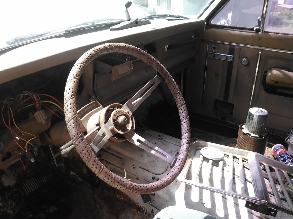

Dash needs gone through
Rear seat is in good condition but fronts need a refurb

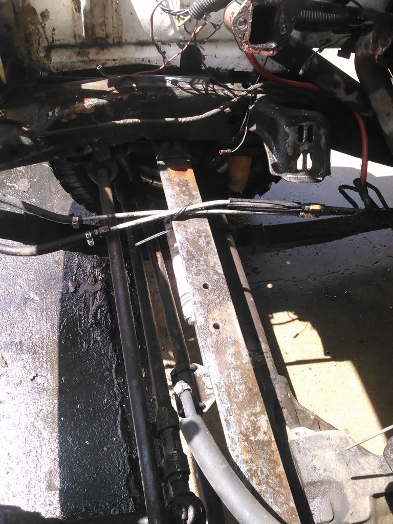

this homebrew crossmember I think was added by the PO who had a 401 in it... IDk about keeping it in, will have to see if oil pan and filter clear it.

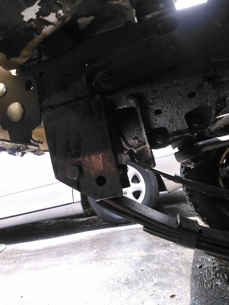

Here is the front dropped hanger

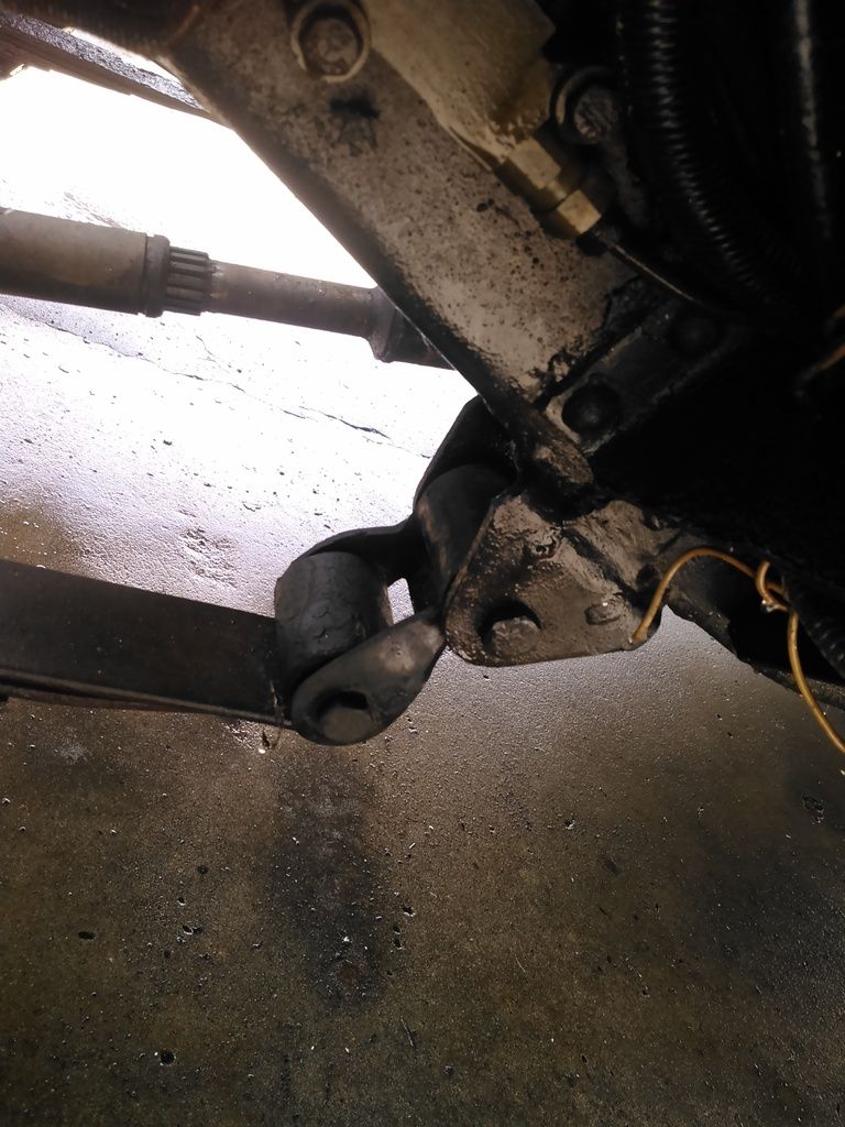

Here is the shackle moved to the rear hanger to equal the lift and a shackle reversal

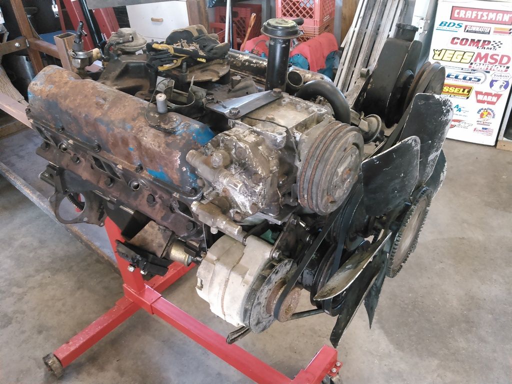

The 360 back together with all new gaskets and seals
