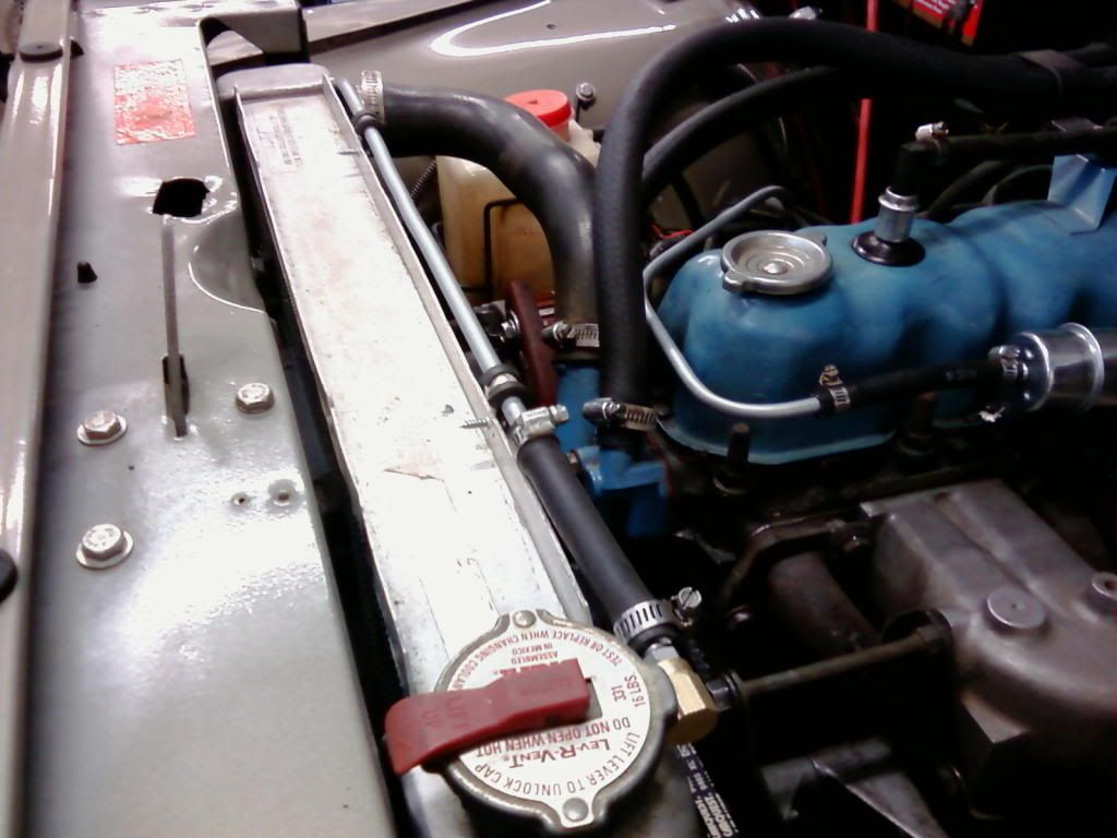

I addressed the leaky heater core next.

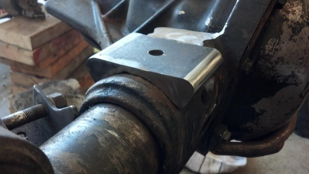

As some of you know, the Wagoneer front D44's are spring under, and have the passenger side perch cast into the center section. This makes going spring-over more difficult that starting with a housing that began as a SOA. Many Chevy front D44's are spring-over and have the passenger side offset I needed, but I started this build as a mild CJ with a SUA. I read quite a bit on the IFSJ website, which encouraged me to go ahead and do the spring-over on the Waggy axle. I started by building a new perch.
One of the great things about the waggy 44's is they have about 13* pinion angle, if you place the knuckles at 0*. I ground the top of the housing flat at an angle that would leave me about 7* pinion angle and 6* positive caster.
I carefully stick welded it but I didn't use special nickel rod and did'nt have a way of cooling it in slowly. Everything I read said that in this application, which doesn't see a lot of side forces (It's clamped in place by the spring pack and u-bolts), it'll be fine. We'll see.
I built another for the driver's side. It had to be taller than the factory perch because the new passenger side was sitting up on casting material.
I set the new YJ springs on the housing for the fun of it. I didn't plan to post pictures of this build and didn't always clean up my work area prior to snapping photos.
The finished driver's side perch. I built it using the original perch as a foundation and adding 3/16's plate as needed.
