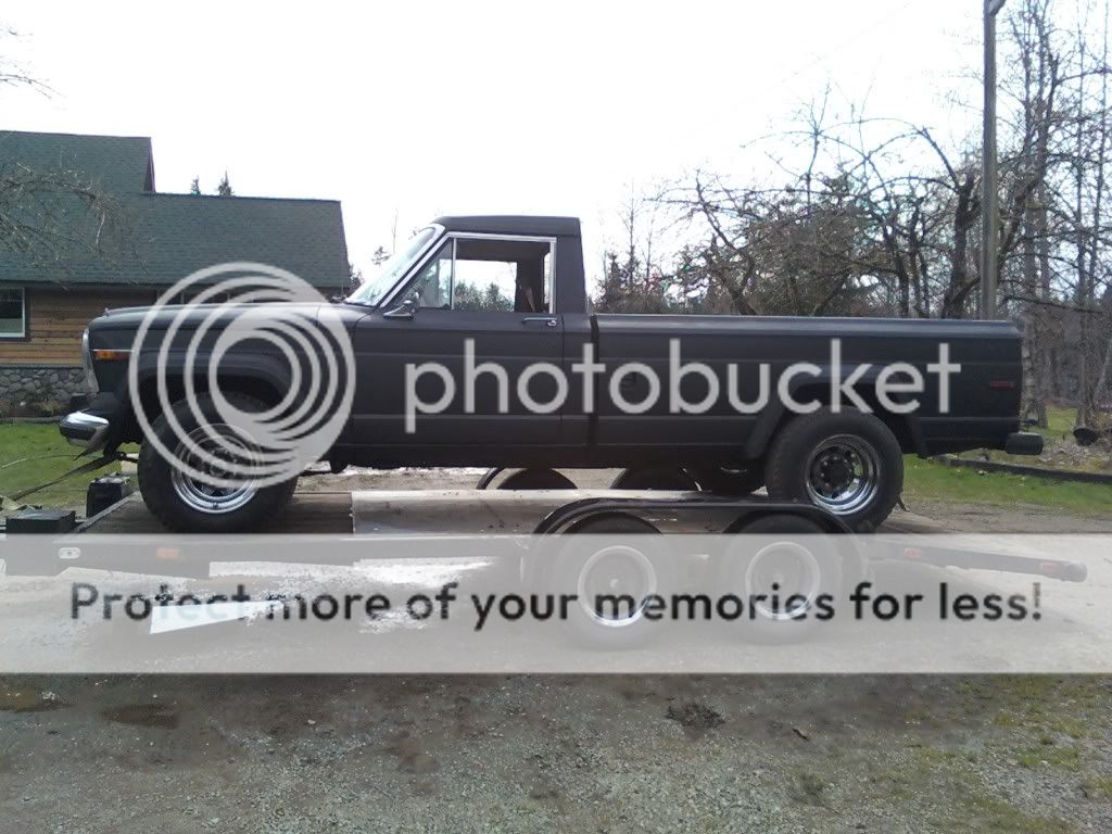

i just put a brnad new 360 in my 1987 J20. i got it started and moved it in teh driveway and turned it around... turned it off fixed a couple o fthings. then startesd it again... it was moving then it died.. it woudl nt start again for the life of it.. it came close but didnt go all the way... i have had 2 huge backfires so far.. and i'm scared to try and start it again.. ive messed with the timing to try and get it correct but...idk it backfires really loud... anythign you guys can think of? please help.. this truck brnad new everytign and i really want to drive it..
here is a picture of her
