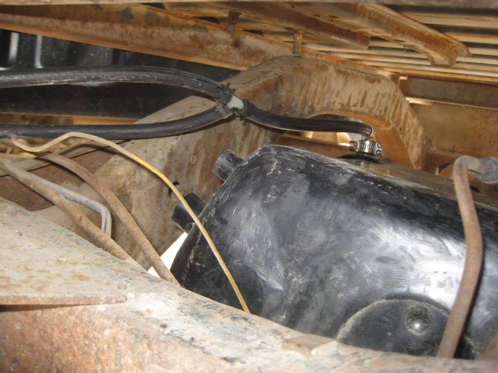

Lifted the tank back up, much easier when empty! New fuel lines at tank for supply, return and vent hoses. I guess the original tanks had 2 vent hoses to the rollover valve, but the new tanks only have one, so there's a new little tee to make 2.
New supply and return hoses at the sender.
New vent hoses.

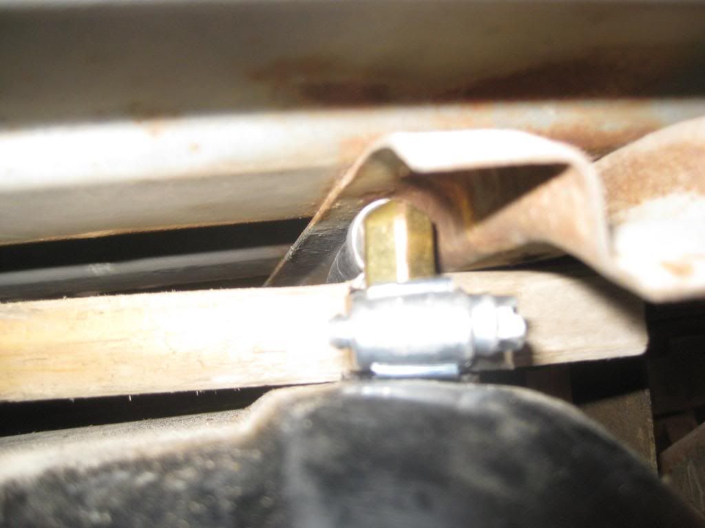

Now why were those 2 pieces of wood on top of the tank? Because the vent tube elbow hits the bottom of the bed if there's nothing there to stop it. So I stuck one piece of wood next to the elbow to keep it from smashing the bed, or pushing the elbow back into the tank.
I didn't put the other piece in the back, but should have, because the tank is a little loose in there still even with the straps tightened all the way up. WIll have to do that in the future.

There's got to be a better way than using pieces of wood, any ideas? Maybe some hard rubber or formed plastic to keep the tank tight but still leave a little space for the vent elbow......

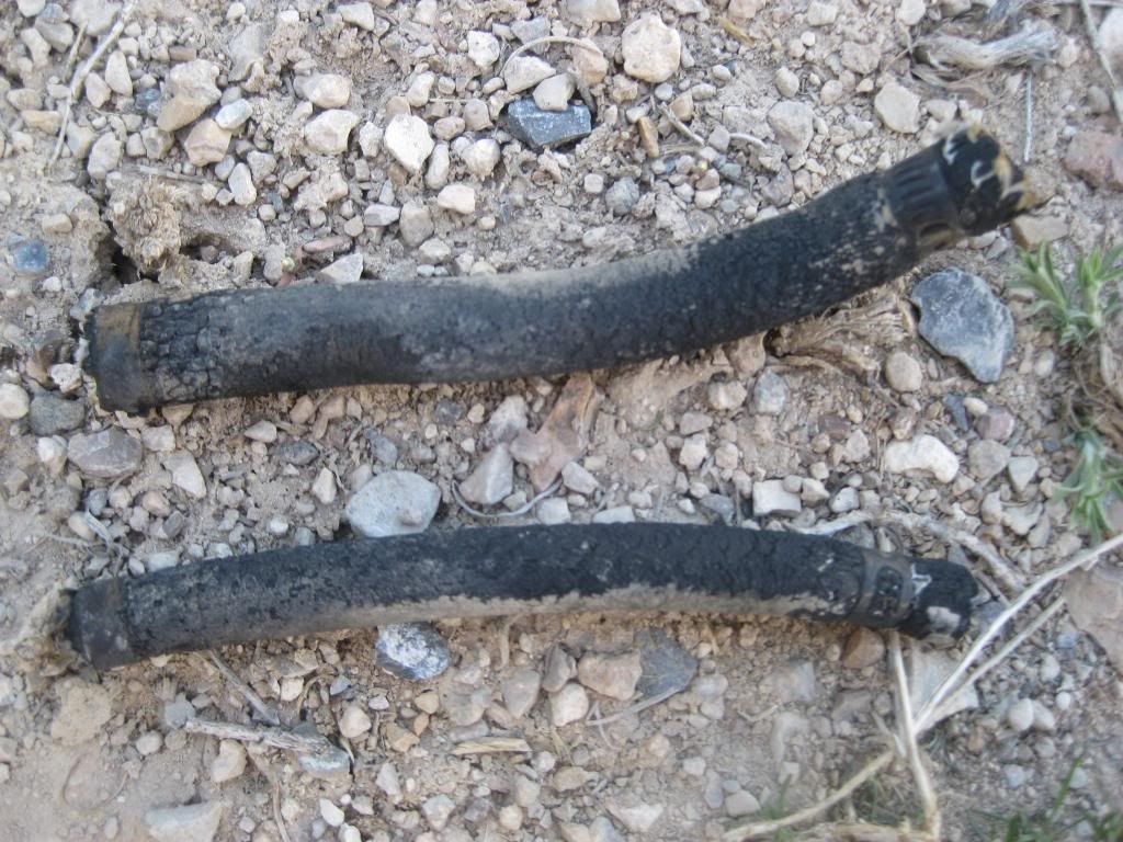

On to the filler & vent hoses.
I went from and old mess to a new mess, but at least the hoses are new now.
Old mess. Lots of hose clamps!
Universal fuel filler hose to side fill tank.
Filler hose makes a trap of gas at the bottom of the hose before turning back up to the tank, which gave me a torso of gas when I yanked it off . Vapor hose cracked, broken.

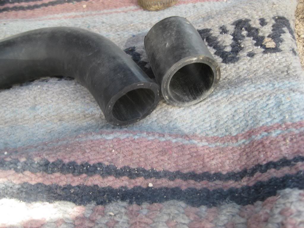

Went to install the new filler & vent hose, all the bends looked right but when I tried to fit them on they were about 6-8" to short! so after I blurted out a long list of profanities, my dad helped me find some pipe laying around the property, and made them work. Also on one end of each of the new hoses, the ends were flared larger and would not fit snug on the tank or filler neck, so I cut them off! I don't know why these hoses were wrong, maybe I'll have to get some for a newer J truck, '80 and up I think are different, and with the new tank, maybe that's why, I don't know, will have to try to find some correct hoses in the future but for now these work.
Cut the flared ends off both hoses.

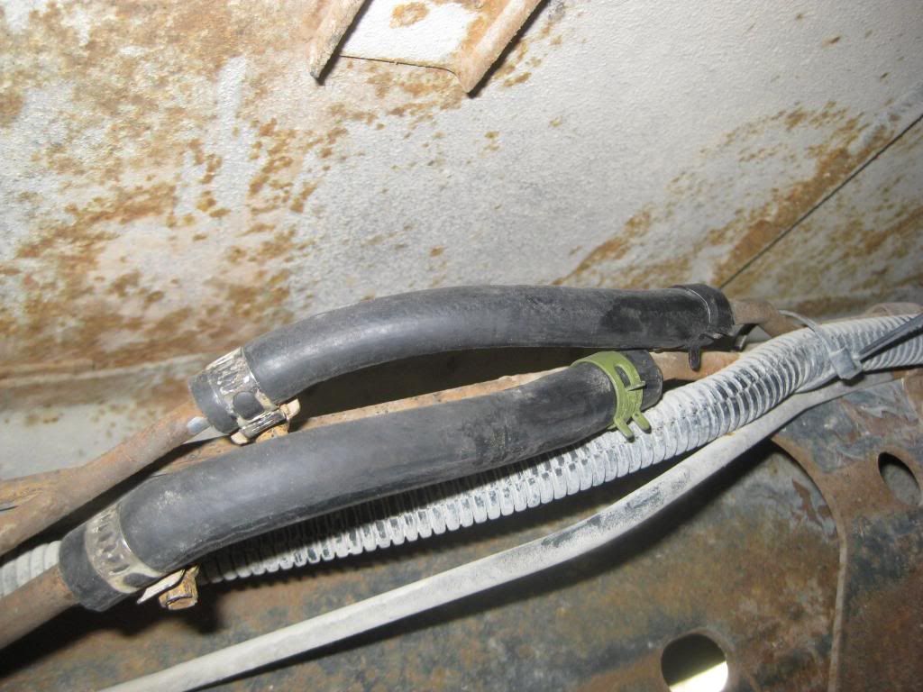

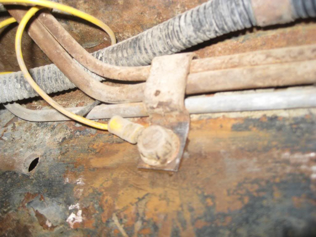

Replaced all the fuel lines, except for the supply line to the pump which I found to be impossible without removing the smog pump unless you have skinny rubber arms, and I had a new one on order anyway, so I'd do that later when it arrived. Smog pump was seized, belt removed.
Old lines under the cab, probably original
New lines
New filter and lines.
