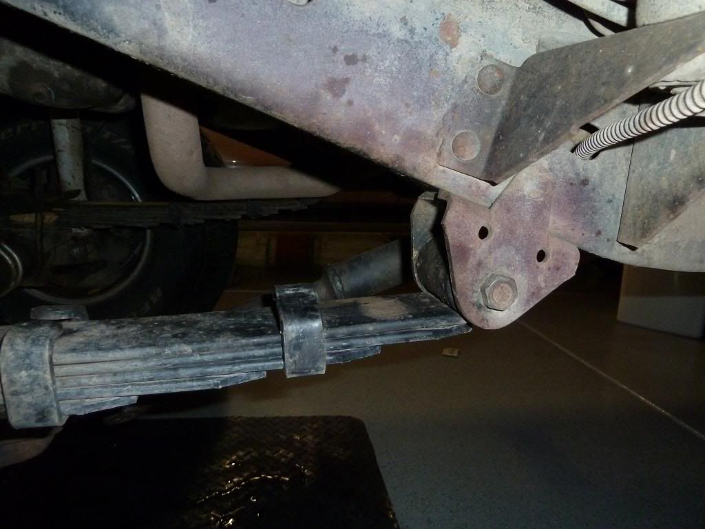

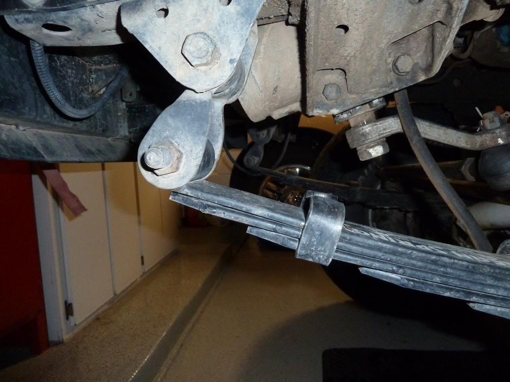

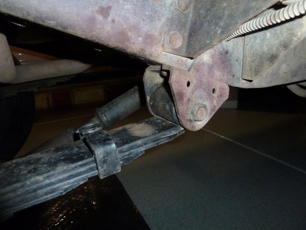

post #8 of 23 Old 04-01-2013, 08:21 PM Thread Starter
mtuck83
Join Date: Jan 2013
Posts: 49
mtuck83 is offline
post #9 of 23 Old 04-01-2013, 08:29 PM
revelc
1985 FSJ Wagoneer
Location: Tyler
Posts: 662
Originally Posted by mtuck83
Could the frame be slightly warped from all those years of tank sag?
