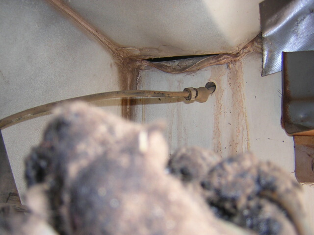

The cowl vent is a good place to look. You might also have a gap in the caulking that seals the kick panel to the cowl.
This is what you see when you drop the passenger side of the AC and look up under the dash.

The example above is my '82 J20, which lived in Arizona all its life till I brought it here. I'd guess that rain is so infrequent there, that no one bothered to look for the leak. If you put a hose in the cowl vent, water comes gushing out of that gap. Even as an AZ car, it still had some floor rust.
