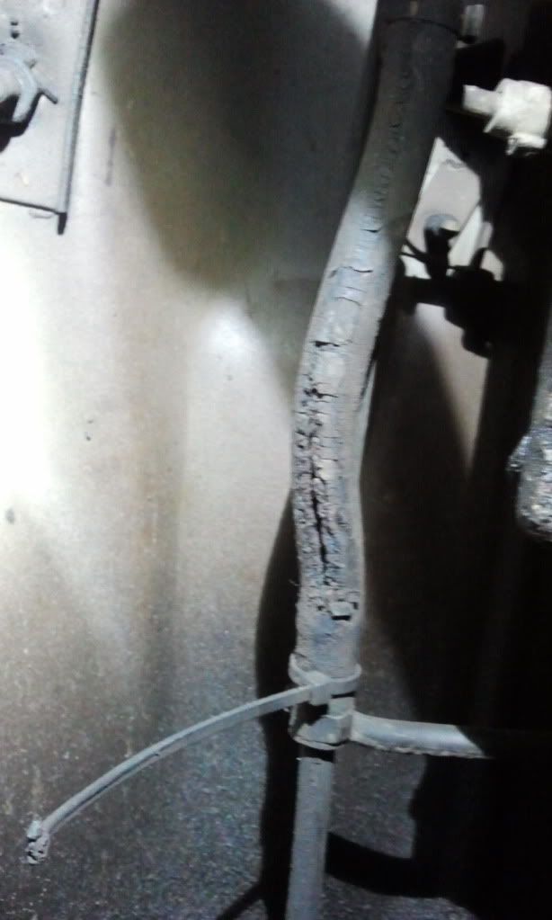

Another item to check (at least what I found on mine shortly after purchasing it) was the rubber sections of fuel line that are on top of the tank coming off the fuel sending/pickup that attach to the metal lines were so dry rotten that they had enough porosity to allow air to suck in with the fuel eventually getting to the point where the fuel pump could no longer siphon up the fuel from the tank. Then a second section of rubber that joins the front/rear metal lines right near the T-Case was also done for. With all the alcohol in the fuel today rubber lines just do not last long. Hit up a race shop for PTFE (Teflon) lines if you want to never change them again, or just get used to swapping them every 2-3 years. The other thing I found on mine was the fuel sock/pickup in the tank was toast. This caused it not to use the last 5 gallons of the tank at all. Literally ended up walking one day even though we had over 1/4 tank on the gauge. I went and got a small 2 gal can filled it up walked back and it primed and fired right up.
Naturally check the pump which is fairly simple you can pull off the fuel feed line and connect a rubber hose from the pump to a small jar/can of fuel and have someone turn it over. If it draws up the fuel quickly and fires up then you know its something downstream to the tank.

Here are the photos.

blue box is voltage regulator.
canister with 3 hoses is fuel filter. and it appears to be backwards.

Backwards fuel filter? Sweet. So the side with 2 ports goes towards the carb?

The filter end with the two tubes should be facing the carb and the tubes should be vertical with b the outer most tube being on the top.

OK, some new fuel line in the engine bay and correctly oriented filter. Ignition module was tested at Oreily's and was fine. Pumping the accelerator does now squirt fuel. Got the other choke plate attached. Of course when all that was done and errands run it's a little late to be making a bunch of racket for the neighbors to enjoy. I just want to make sure that the filter is now oriented properly. The hose from the top of the fuel pump runs to the top port of the filter, same as before, just swapped which end of the filter went to the carb. When I did that, the funky S-curve piece of metal tubing wasn't needed to align the hoses. Will see if this gets Susan started up int he afternoon!

The fuel line from the pump should go into the inlet (single) side, the nipple offset from center (and smaller) is the bypass and should run back into the tank. The output to the carb is correct, swap the other two, the "clocking" of your filter is correct.
The ignition module cannot be reliably tested unless it is under warm, running environment.
The "other" choke plate shouldn't open unless the four barrel is opened up, it has no use until the lower secondary butterfly is opened.
