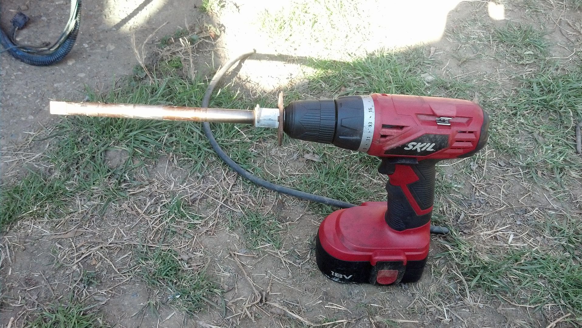

Here's a pic of my tool and drill that did the job it stressed it pretty good but it was enough to get the oil pumped up in the heads I also poured half a quart of oil in the distributor hole so that helped lol I got lucky when I took apart the old jeep 4.0 distributor it came apart just like I needed it to I had to grind the end so it didn't spin in the drill neat little idea and I'm glad it worked
You mentioned water in the pan. Did you ever pull it off and check the crank?

Well I didn't even tho I really should have but I was thinking about it and all the water would have been sitting at the bottom of the pan the oil would be on top so the crank should have been in oil not water because when I drained it the water came first I flushed it twice before starting it and replaced the filter I'll probably pull the pan before running it any further just to be safe but I checked out everything pretty well and it didn't seem to rusty inside which is a plus I'm gonna change the oil 1 more time and when I drain it this time I will drop the pan to check it out and see if everything is OK and make sure the oil pickup isn't plugged up or anything. There's a lot of vacuum lines I'm not sure what to do with them. Or if I can just cap them off I put an edelbrock performer intake and 600cfm 4bbl I'm not sure about vacuum for both I know the brake booster goes to the intake and the distributor vacuum advanced goes to the intake as well but that's all I know. Since the Chilton manual won't help much with aftermarket lol also do I need the egr valve or whatever it is on the back of the intake? I have it on now but can I make a block off plate for it who needs emissions crap of it lol its a dinosaur and I plan of spewing noxious fumes everywhere while getting 4 gallons to the mile lmao. This is quite a big post but I gotta start figuring out all the small stuff now and start putting the interior and fuel tank and lines back in the truck and get the tranny lines fixed since someone decided to cut them off at the trans..... I'll get a trans cooler for it and flare up some lines for it thankfully I got a job at a local speed shop and man I love it I'm learning so much more then I already new knowledge is power and look forward to every day I wake up to go to work lol.
Good plan with dropping the pan. Safe thinking.
