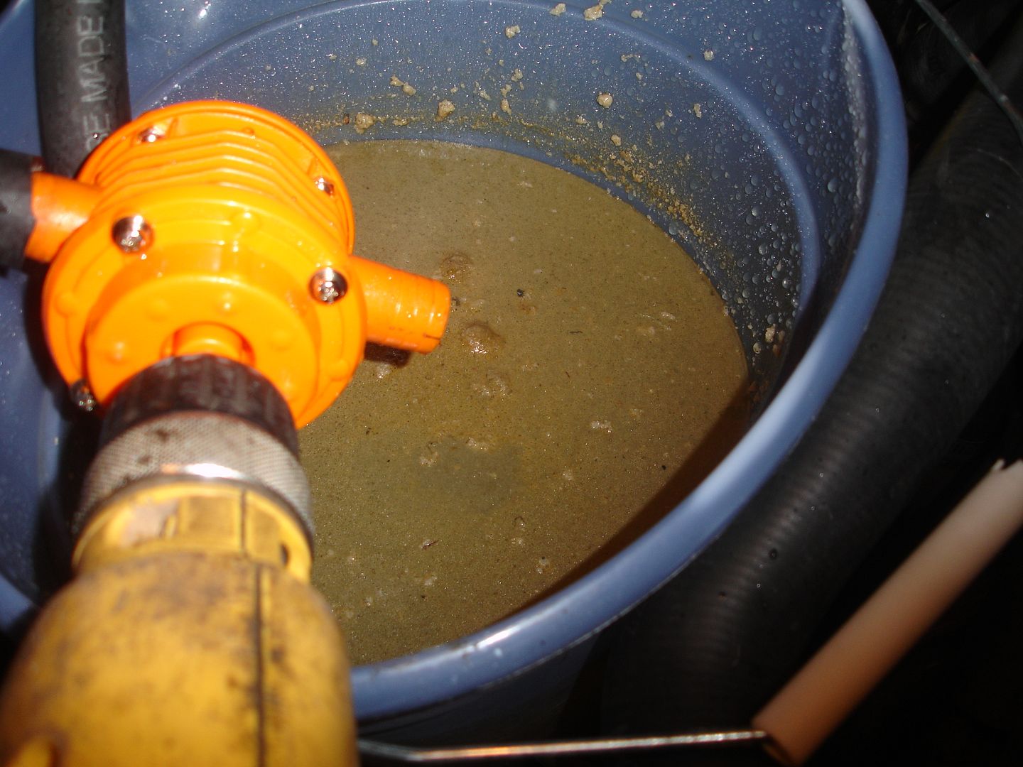

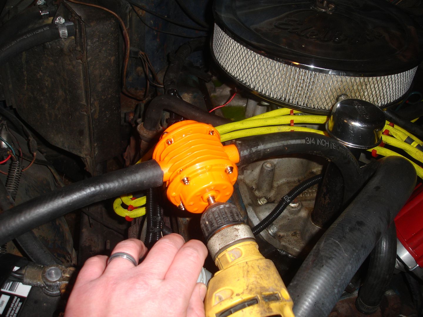

I took your advice, Mr. Forward, and picked up a drill pump from Harbor Freight to assist in my heater core cleaning. As usual, I took pictures!
Heavy Duty Drill Powered Pump
I hooked a heater core hose to one side of the pump and submerged the other heater core hose in a bucket of clean water and started pumping. Note that with this pump, you have to get it cranking before it will self prime. Once primed, it works awesome!
After cycling both directions a few times...
Once I rinsed it, I ran the pump with the hose out of the water in an attempt to empty the core. Then I added some Preston Radiator Flush + Cleaner by dumping it down one of the heater core hoses. I let it sit for 20-30 minutes.
While this was sitting, I poked my head inside and saw this:
Even though I was jealous that I wasn't warm in front of the fire, I decided I needed to go out and get back to work. With the Prestone cleaner still in the heater core, I hooked the hoses up to cycle only the cleaner. I ran it both directions a few times and let it sit.
Lastly, I ran more clean water through both directions to rinse it out. I also attempted to remove most of the fluid from the heater core. In an attempt to not have an air lock in the core, I poured coolant down the hoses before I hooked them back up. Overall, I'm pleased with the outcome. With the temperatures only reaching a high of -2F and a low of -13F yesterday, I was pleased to notice an increase in temperature in the cab. I'm still not positive if everything is working as it should but I need to take it for a real drive before I make my final decision on the situation.
Wow, all that junk came out? Blech! Looks like it did some good to me!
Yeah, with it so cold it's hard to tell if it's making a difference. I had to actually put my hand in front of the vent to judge how much warmer it was.
And regarding the final pictures...

It was nasty, greasy stuff. It took a little elbow grease to get the bucket clean when I was finished!

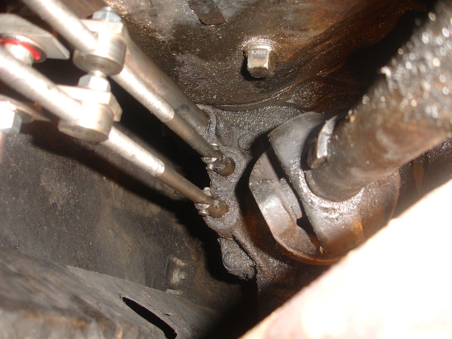

Dana 20 Twin Stick
The twin stick is installed!!! While a little head scratching was involved, we were able to figure out how to remove/install the shifters without taking anything apart.
This is the support rail for the shifter.
It mounts to the shifter with two bolts (1/2" square heads).
It also mounts to the transfer case in the same way (twin stick installed in this picture).
First, I removed the two bolts holding the shifter support rod to the transfer case. In the above picture, you can also see the large bolt missing from the transmission. It came out very easily and allows for much more wiggling room. I also removed the two bolts holding the shifter to the support rod. At this point, you'll find how frustrating it is when you realize how close the rod is to coming out yet hits the transmission and ultimately goes nowhere. To remedy, push the rod as far back into the transfer case as possible and slide the shifter on the rod towards the transfer case as well, revealing the front of the support rod. Once you're to this point, get out your handy die grinder and carbide bit and shave off some of the rod (I did this from above through the shifter hole).
I also took a tiny bit off the side of the transmission, mainly providing a smooth edge instead of a blunt stopping point for the support rod. This isn't necessary though. You can slightly see what I removed below the bolt hole.
Once enough is ground off, the rod and shifter will slide right out.
Here is how the shaved rod looks in the old shifter. With the small amount removed, there is plenty of structure left.
New twin stick assembly:
The following picture shows you the two original shift rails that need to be removed as well as the location on the transfer case where the support rod slips in.
Twin stick slipped into place.
The new twin stick mounts to the support rod with two hex bolts. For reference, these bolts used a #4 allen wrench.
The following pictures are of everything coming together. The cotter pin picture is for size reference for those looking to do the same thing. They hold in the shifter rods.
Plenty of room for the shifter rods to move.
The twin stick works well! I'm excited this project is finished.

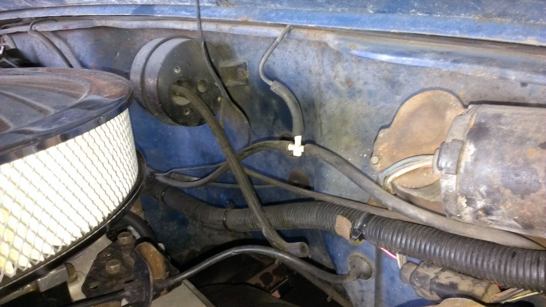

Well, I think this may be an issue with my heat... Does anyone know where this hose goes off of the vacuum ball thing? I read it goes to the drivers side firewall but I can't find a fitting...

Update to the above: The vacuum ball has a small hose running into the cab that hooks to the heater controls. The larger line that is unhooked is supposed to hook up to manifold vacuum. Once I did this, I had moving air in the cab!
