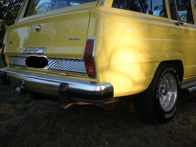

Hi folks, I have sourced most parts needed for my 82 Cherokee S from sources in forums and on Ebay etc but amber or yellow rear turn indicator lenses have me stumped, in Australia 1973 and earlier are allowed red but. I have an original and perfect all red pair if any swaps out there.
Any contacts would be appreciated
Cheers
Dave P Queensland Australia

Dave, I have amber lenses on my 74 Cherokee S and like to change them with full-red ones.
I dont just know are they swappable with 82?
Oh yes, and i am in Europe (if this plays any role).

If they are the same shape, then they will work. Otherwise, swap the backup light bulbs for amber 1156 (or convert sockets and use 1157 so you have amber backup lights), swap the wiring from the brake light (just above) and run a new wire back from the brake light switch to the 2 you just cut off.
