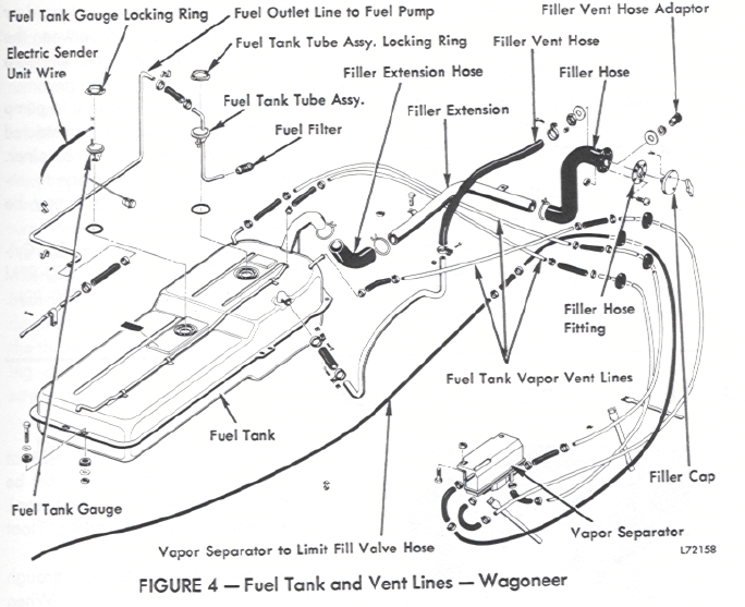

Heres a question: the OEM fuel tank has what appears to be 4 vent nipples but BJ's only has one. Since the fuel sending unit only has a pickup line, is one of the 4 OEM lines a return line? Does it need one? Anyone have any info on the four OEM lines on these J trucks?
Edit: It actually looks like the replacement sending units have a pickup and return line so may be its not too big a deal that the aftermarket tank only has one vent. Either way can anyone speak to the OEM lines?

Now wondering if since it's carbureted it doesn't need a return line and all 4 may actually be vent hoses. This '72 Wagoneer diagram seems to suggest that as well...

One is the vent for allowing air out when you fill the tank.
The other three act as vents along with the charcoal canister that allow air back into the tank as fuel is consumed. Without them, a vacuum would be created in the tank that the fuel pump would be working against. There are three just to allow at least one to be clear of fuel when driving at off-angles.
I'd be on the phone with BJs asking why there aren't at least two nipples.

what CSP said.
Obviously the big hole is the filler neck. The next biggest port (on the far corner in your pic) is the breather tube so it doesnt burp gas back at you when you fill it up. The other small lines as mentioned are for the charcoal canister. there was not a return line on the early 70's rigs. The later models did, indeed, have a fuel return line. I'm not sure on the J trucks, but the wags have a little check valve up in the fender well.
The good thing about poly tanks is you can simply drill a hole and install a bung....well, you can do that on steel tanks as well.

Didn't realize the truck has a canister. There's a cover in the bed that covers up the lines. I'm working on getting it off (rusty, stripped bolts) so I can see what all is going on behind there. Many thanks for the responses.
Got my repair manual on order which should help clear up Wagon vs J-truck differences as well! I think additional nipples will be the necessary solution.
