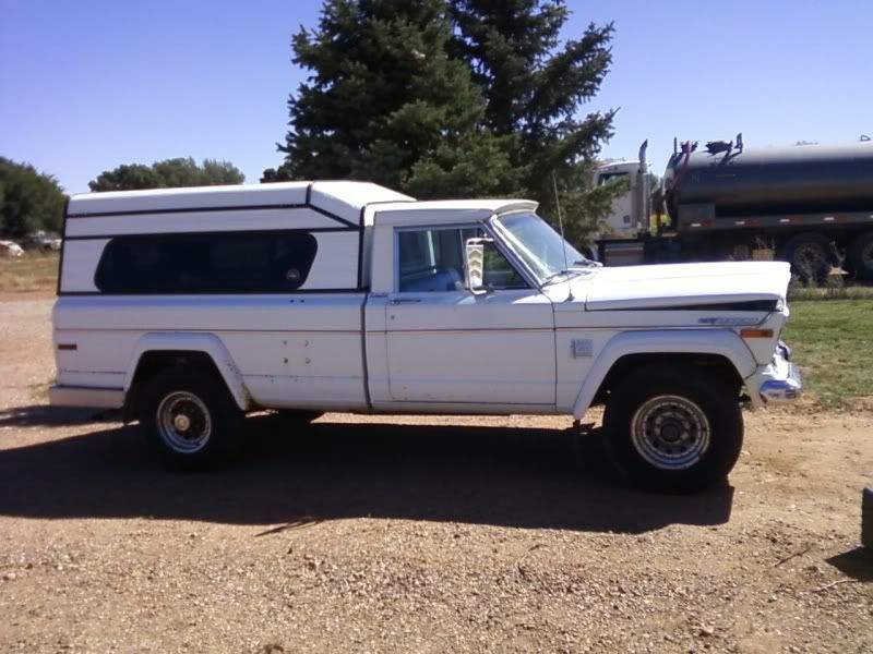

Ok I got this from a guy I used to work with it WAS in great condition right up until he hit a deer at 75mph.
It is actually a 1 ton J4800. D44 front closed knuckle drum brakes, D60 rear, AMC 360, TH400, and a D20 x-case.

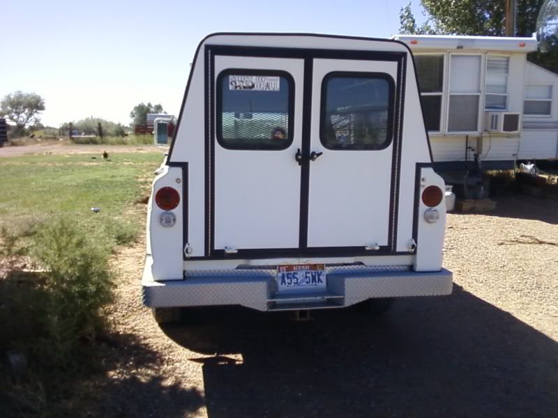

The guy I got it from had the alum topper custom built to match the truck he said it was right at $2800 to have them build it.

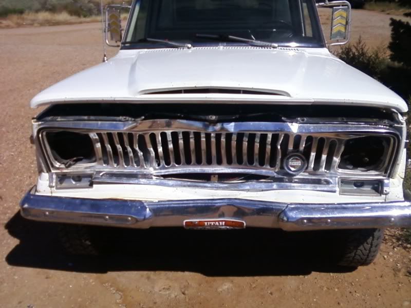

So the bumper, grill, header, radiator support, radiator, fan and shroud, water pump and several engine acc. brackets were all damaged.
I aquired a 83 fullsize cherokee for parts thinking I could just use all the engine accessories from the 83. NOPE AMC does NOT interchange as well as GM. Kinda upset me but at least I have some body parts.
Being a GM guy I am going to pull the drive train and swap in gm stuff. I have a 78 chevy camper special that was a 400 (actually a 396 for those that dont know) But it had been replaced with a new GM 454 about 10,000 miles ago the trans was also replaced at that time *at least according to the previous owner.* The chevy is pretty rusty and chevys are a dime a dozen anyway.
Other plans are to eventually swap the front axle to a newer open knucle disk brake version. MAYBE a 2-3" lift and I would like to run 285x75x16 tires. I hope to repaint it at some point and would like a rhino grill. I will build a front winch bumper for a warn M12,000 too.
Ill get some pics when they load.

its worse than it looks...
