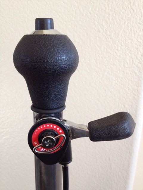

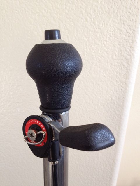

The first part of today I felt well enough to spend a few minutes finishing the upper part of my custom floor shifter. I decided that I didn't want a column shifter in this Jeep truck. It just doesn't look right in a beefy rig like this.

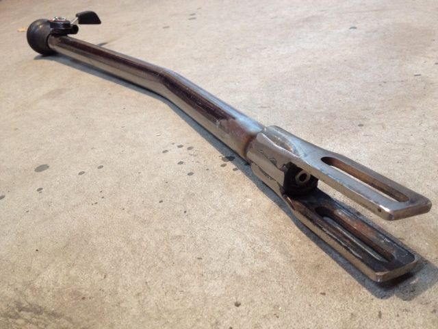

A long time ago I started building this thing by putting a 30 degree bend in a 1" piece of tubing and cutting it to about 18" long. I used parts from one of 2 new e-brake kits that I've had sitting around for years. The e-brake cable housing was cut to the same length as the shifter tubing. Then the aluminum ends were pressed on to each end. Now the steel cable can move smoothly with just a push of the button on the shifter handle like a normal shifter that costs quite a lot.
I like little projects like this.
I took a solid rubber shift knob and drilled it out so a brass bushing could be pressed all the way through it. The ID of the bushing matches the OD of the chrome button shaft perfectly. The cable is inserted through the sheath with a spring at the top. The knob goes on and is topped off with a nice chrome bezel from one of the original J200 dash switches. It works really nice and smooth and should last for many years trouble free.
The lever on the side is a remote ratcheting throttle control. I always put them on my Jeeps so I can increase the RPM's for running an on-board belt driven air compressor for airing up tires, running air tools and many other things.
The next thing is to put together the pivot and shift detents as well as the contact pins for LED gear indicator lights on the dash, and back-up lights. I will show photos of that later.

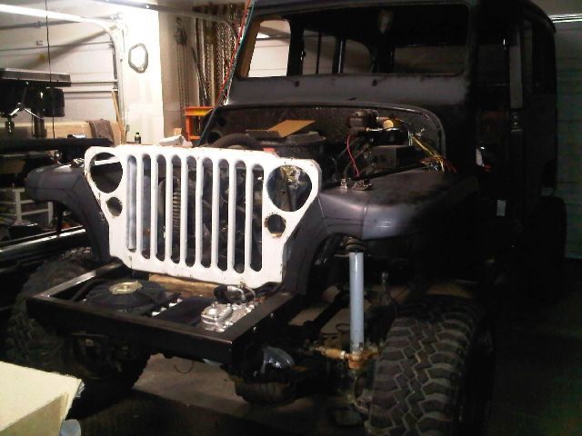

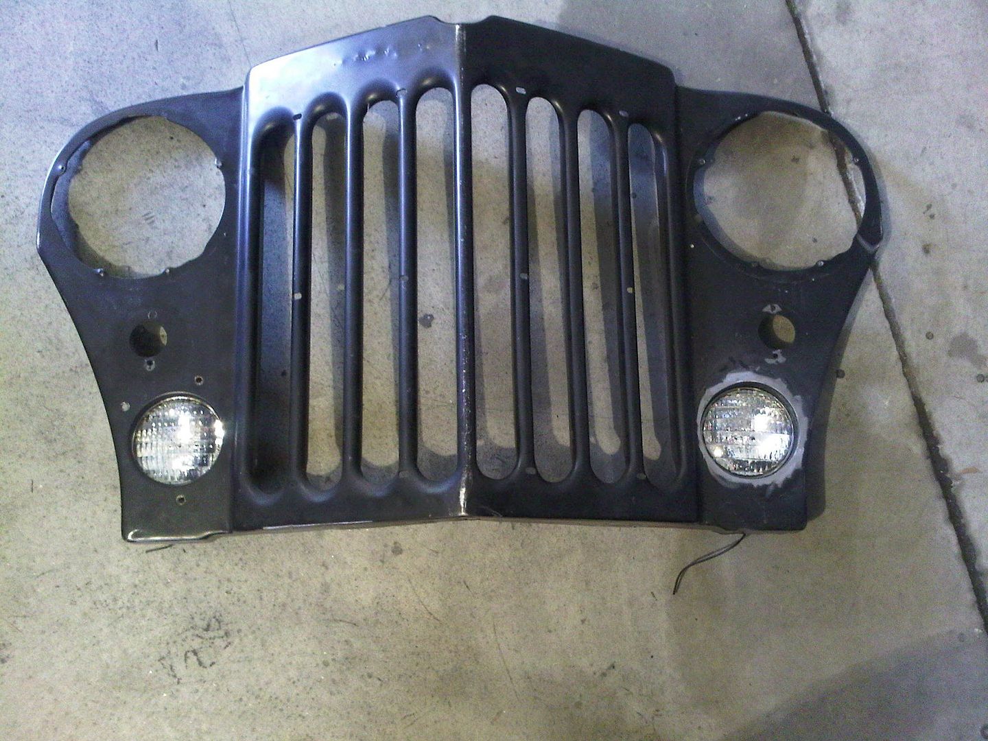

A while back I decided to make better use of my Willys wagon grille fresh air vent that originally went to the heater. Now there are two matching holes with fog or driving lights mounted from the back side. Looks nice and very useful.
And I found a photo of an experimental grille modification I tried a few years ago. I set my Willys MB grille in place of the original just to see what it looks like. I like the look, but it would require a few modifications to make it work. It's not that far off from the early Willys wagon and truck grilles. My original is already completed, so I won't be using it most likely, but it's fun to play around with different things.

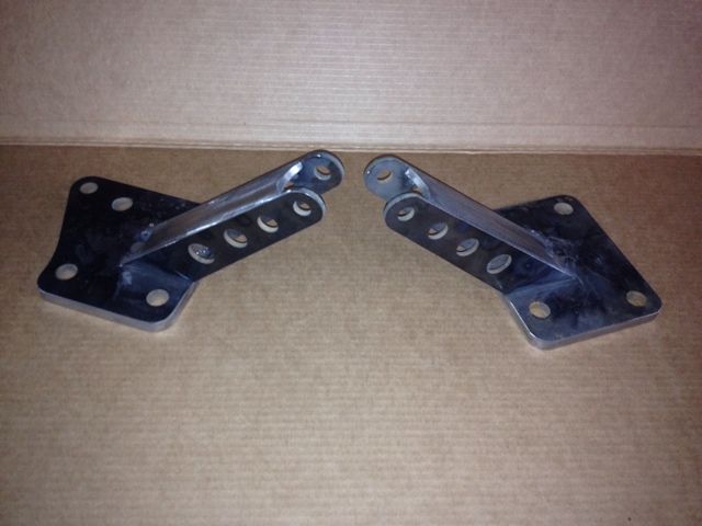

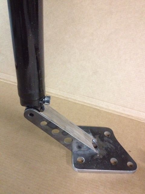

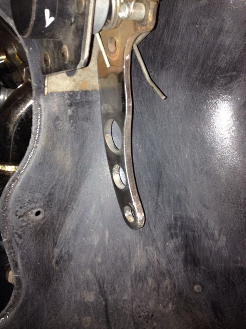

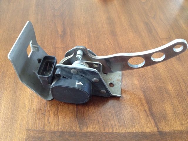

I gathered up a few more photos from the mock-up stage. I had to cut down the drive-by-wire fuel pedal. It was just too long. So I welded a custom shorter piece on to it that matches my motor mounts and shock mounts. These pics don't show the foot pad yet. Just the arm. And the springs are loose in the second pic. I may not use them. They are too stiff. I like a softer pedal, because I can't push hard enough and maintain pressure on it with my right foot now.
These DBW pedals are sweet. I am mounting the ECM, DBW module, relays and fuse panel inside the cab under the dash to help keep the engine bay clean.
Here is the bottom section of my custom shifter. It has a slot that will connect to the cable controlled gear detent and back-up light switch.

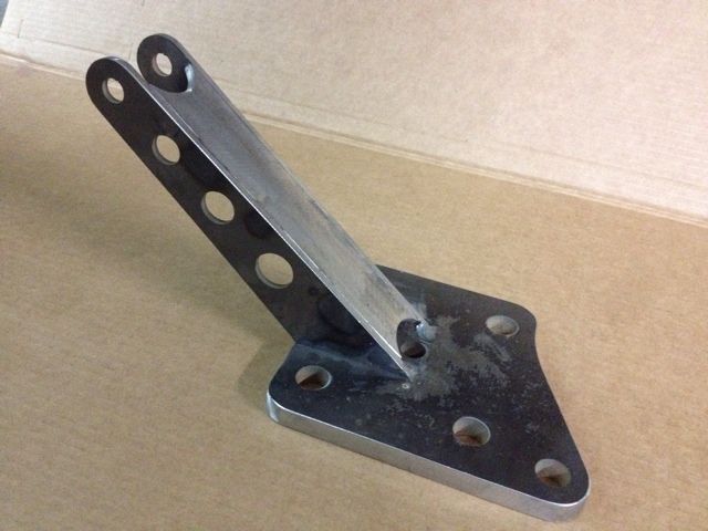

Here are a few photos of my new custom-made front spring plates with integrated lower shock towers. They are 1/2" thick. Very stout!
The extra hole in this one is for mounting my AGR hydraulic steering ram. The other end of the ram mounts to my 1 1/2" x .250" wall tie rod.
Here is an example of how the shocks mount to these towers.
It was necessary to build them like this so the lower shock mounts extend out over the king pins. That way the shocks have the proper geometry and angle in toward the frame with plenty of clearance where they mount to the upper shock tower. I will show photos of them installed later on. I forgot to get pics in the day time.

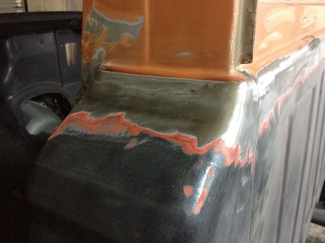

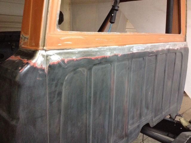

Here are a few more photos of the 78 J10 top after it was welded on to the 64 J200. It turned out real nice and only took a very thin coat of body filler to smooth it all out for primer and paint. I will post photos of the primer and paint a bit later. But I am ruined today with pain.

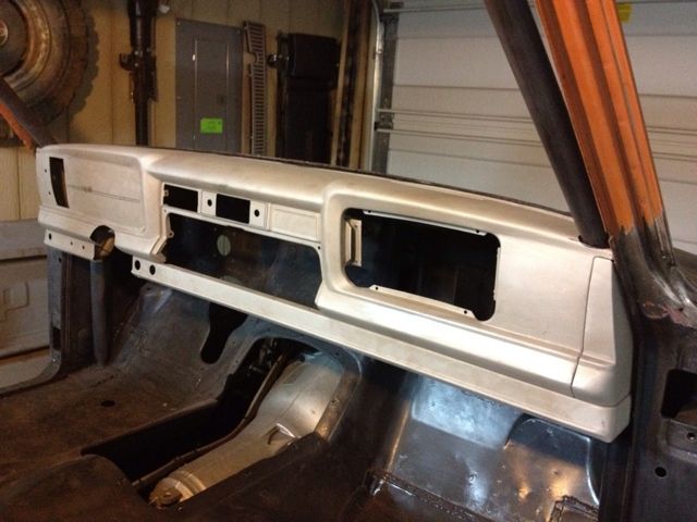

I thought I would share my recent upgrade that I am super excited about!
I bought the Dakota Digital gauge cluster, senders and accessories made specifically for the 63-72 Gladiator from BJ's Off-Road. And it will work perfectly with my 6.0L engine and Howell Engine Development harness and computer.
I can't wait to get it. It should be here in a couple of days. I already have a full set of Auto Meter Gauges that work very well. But the speedometer is analog and I need a digital speedometer for this engine/transmission. And buying a digital Auto Meter speedometer costs about half as much as this Dakota Digital unit.
I talked with Dakota Digital and BJ's about all the technical aspects and options. But I purchased everything from BJ's Off-Road, because they are running a great sale right now. Everyone of these guys are so great to work with. Their customer service is exactly what customer service should be. A true pleasure.

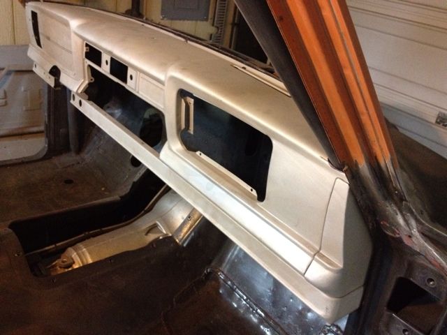

I will post up all the details of the installation soon. I only wish that I hadn't modified the dash for the Auto Meter gauges, because now I have to modify it back to accept this new gauge set up.
