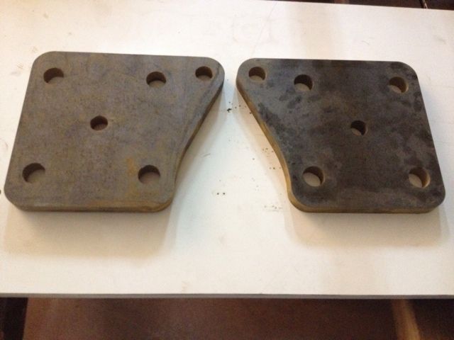

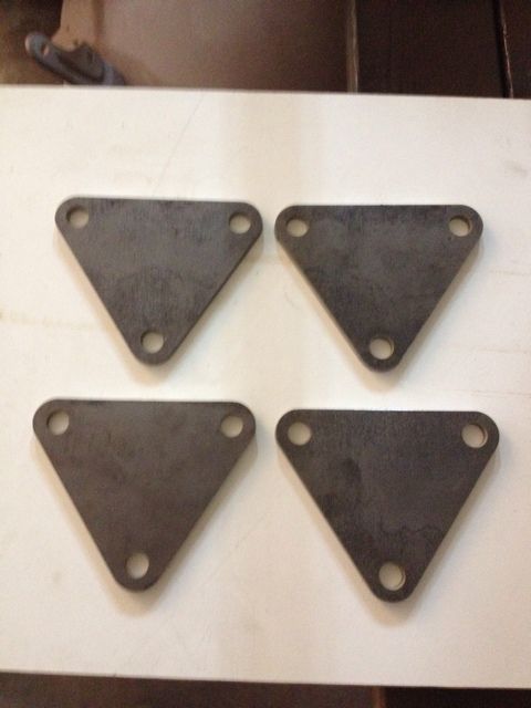

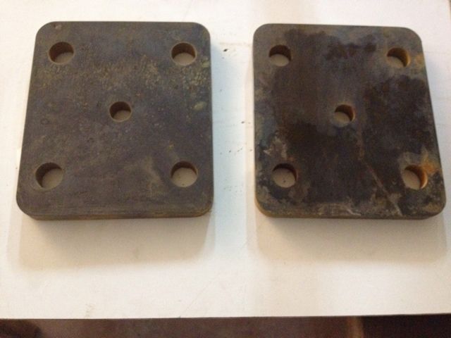

While I still have some energy this evening, I want to show you some additional photos of my custom shock towers and spring plates. I drew these up a while back and had them cut out on the waterjet.

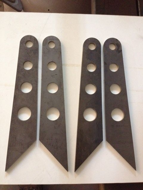

Here are the lower front shock mounts that will be welded to the spring plates. I will show the final photos of how they are put together later on.

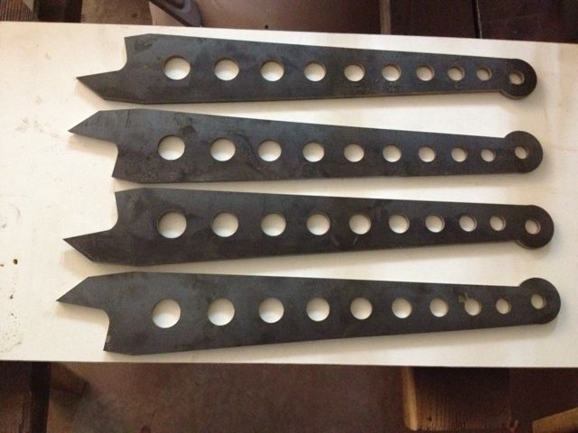

Here are the upper front shock towers. These are the sides of the towers. And not shown is a 1.5" piece of flat bar that is welded along the back edge vertically.
They get welded to these custom plates that bolt to the OEM shock mount holes in the FSJ frames. Or they can simply be welded directly to the frame. Whatever works best. All 4 of these are the exact same size. It's just the camera angle that makes the top ones look smaller.

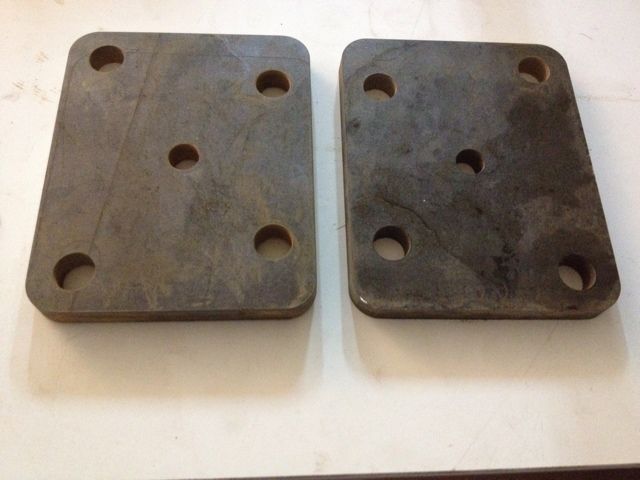

Here are some new and improved 1/2" thick spring plates for front and rear Dana 60's. The other ones I designed a long time ago have always worked fine, but I decided to have them made wider and longer overall. Plus, the holes are bigger for the u-bolts so they will slide on more easily without the possibility of damaging any threads.
These work for rear 60's and the tube-side of a front 60.
These are for the differential side of a front 60.
These are for the tube side of a front 60. But they also have an integrated mounting hole for hydraulic steering; like AGR systems.

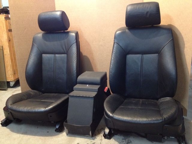

I picked up a perfect set of BMW power leather seats for $200. Even the head rests are power. Geez.
They have the switch cover for heated elements. So I will get some kits later on. I really need heat.

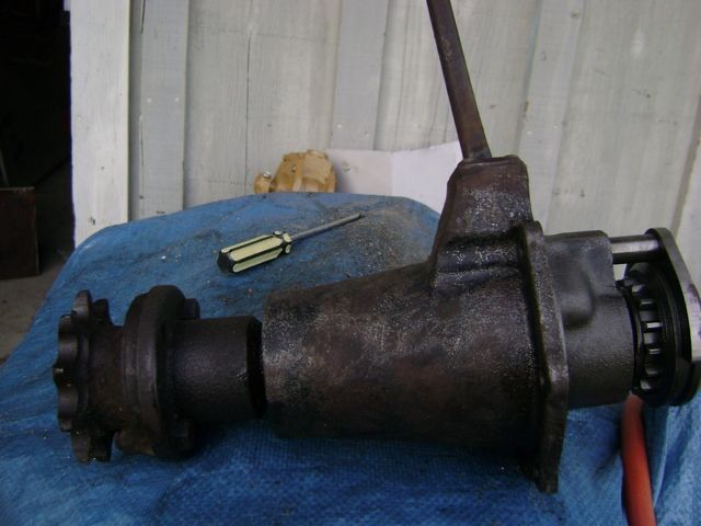

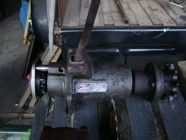

On a side note related to my Willys wagon, I bought a really cool PTO setup from a really nice guy in Canada. It is an original Spicer unit straight out of Toledo that bolts right onto the back of the Spicer 18 t-case.
Very cool! I have always loved this vintage equipment. It's in perfect working condition.
And I already have a TH350 mated to a Dana Spicer 18 t-case Advance Adapter. All brand new just waiting to jump into action when my wagon is ready for the road. This PTO will bolt right to it. And it will be perfect for the Ramsey PTO winch my dad just gave me. I can't wait! It came out of a 48 Willys wagon originally. I think the wide track 44's I took out of a 79 Cherokee Chief may be just perfect too. We'll see. I may go with the 2 high pinion Dana 60's both front and back to go with my 41's.
If the PTO doesn't work in my Willys wagon, I will put it in my GPW.
