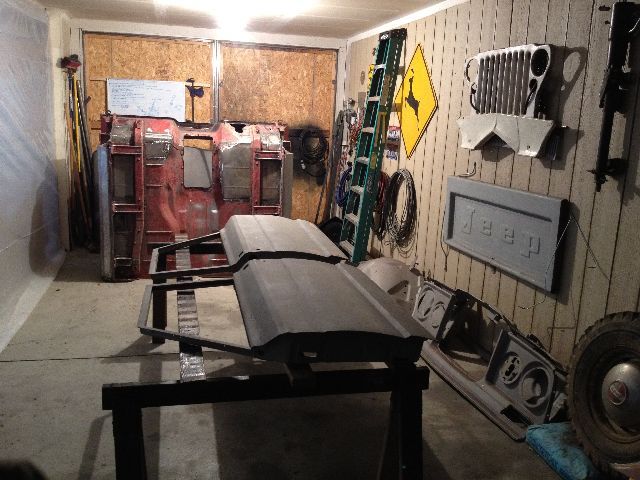

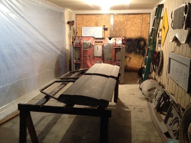

I spent some time this evening picking out a few more photos from my never-ending collection to post up for y'all. These are some pics showing the completed frame, except for the front shocks, rear driveline and painted/installed fuel tank.
I like the night photos:
And here are some shots of the paint booth setup. 6 mil plastic wrapped around 2x2's that are screwed to the ceiling trusses. Since these photos were taken, the big light has been removed and flourescent lights have been installed. I didn't want the fumes to land on a hot 300W lamp. It could have been trouble. This paint booth worked very well and it kept the fumes from getting to the furnace and hot water tank pilot lights and kept the smell from getting into the house.
Big thanks to Todd and Jarrod and Travis for doing all the heavy/difficult work. They really are great friends. If it weren't for their commitment to helping me with more than just my simple Willys truck project, I would still be staring at a pile of junk and none of my winterizing would be done. Plus, the Suburban my wife and I bought and gave to my Father-in-law would never have been ready. Thanks so much for all that you guys do.
