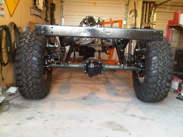

Here are a few progress photos showing the completed rear Dana 60 painted and installed with all the other components.

Great job on the build. One question, this is the first time I have seen locking hubs used on a rear axle. I am sure there is reasoning behind this. Care to explain?

Yea, I designed this setup to entertain myself mostly. But I also did it because I wanted to find an easy, inexpensive way to narrow a rear full float Dana 60 or 14 bolt or whatever for a flat fender Jeep or any other 4x4.
So, I designed a kit that includes tube collars and caliper brackets that bolt up to a Ford front Dana 60 or 50 spindles and hubs. Then I used Warn locking hubs to disengage dual splined 300M 35 spline axle shafts. Now the rear axle can be disengaged for flat towing.
There are new full float spindles and disc brake conversion kits and parts available of course, but I wanted to do something different that didn't cost an arm and a leg.
So, since that kit was a success on my CJ7/Jeepster Commando rock crawler and Willys wagon, I decided to do the same thing on this FSJ. However, these locking hubs are not going to stay on this FSJ. I will be replacing them with drive flanges instead. This truck won't ever be flat towed. It will be the tower. So it's not necessary to disengage the rear axle. But I really like this kit.
Sorry for the long explanation. But that's the story.
