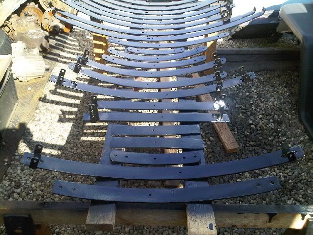

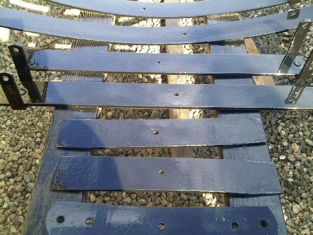

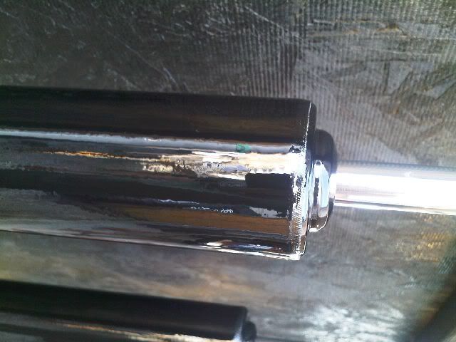

Here is a stash of photos from my camera that show the leaf springs being painted with POR15 after they were taken apart and sandblasted. They were pretty badly rusted between the leafs surprisingly. But now they will be smooth and protected for a long time. POR15 is so tough that it will enhance the ride quality. Especially, with the teflon between each leaf.

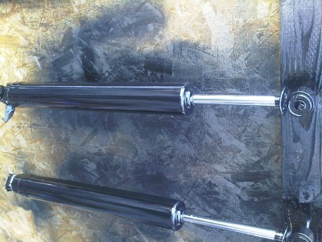

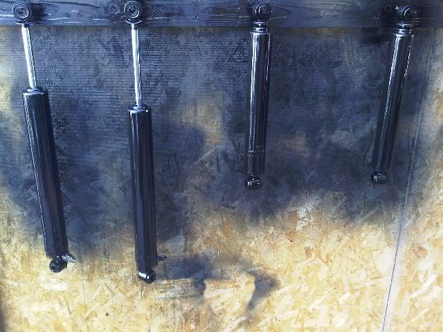

The white Rancho RS9000 and BDS shocks were also sanded down and painted with POR15.

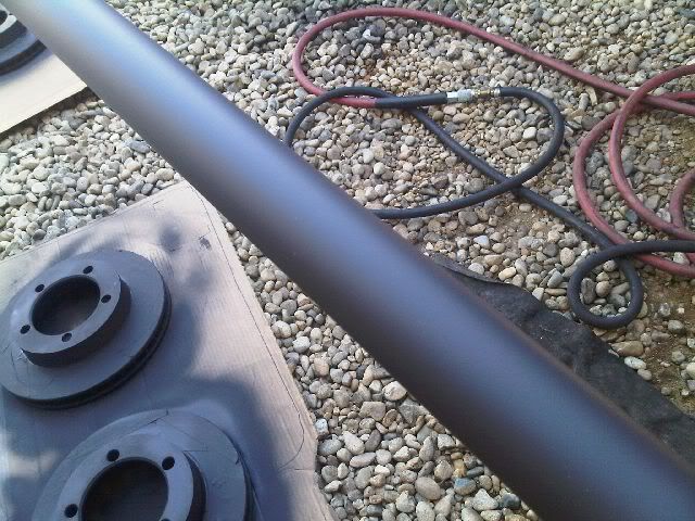

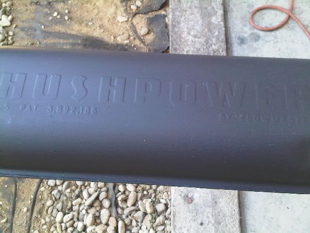

I tried a new product this time for my exhaust. It's called Black Velvet from POR15. It is a heat resistant paint up to 1200*. And it really looks great. It can be sprayed directly over bare metal just like the original POR15 paint except it's not glossy. It's satin and truly looks fantastic.
