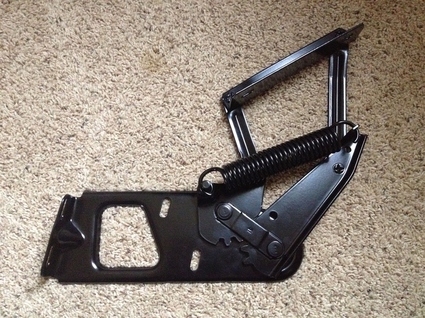

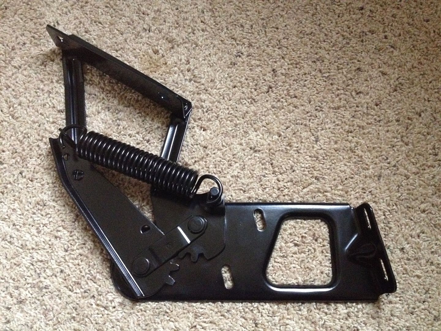

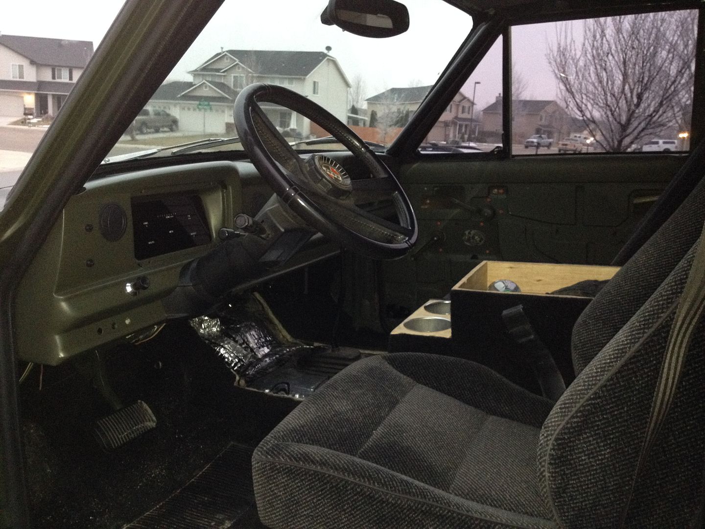

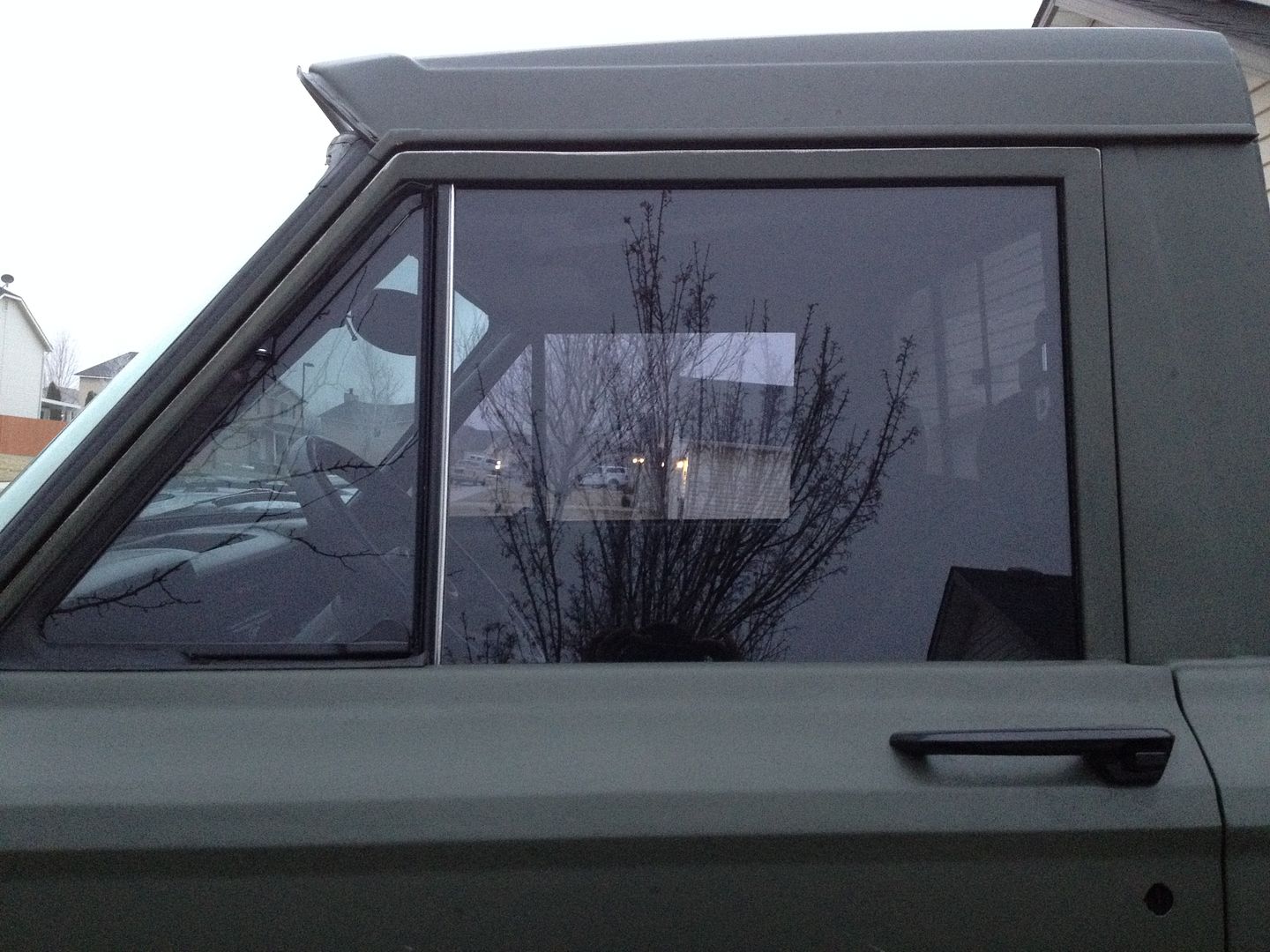

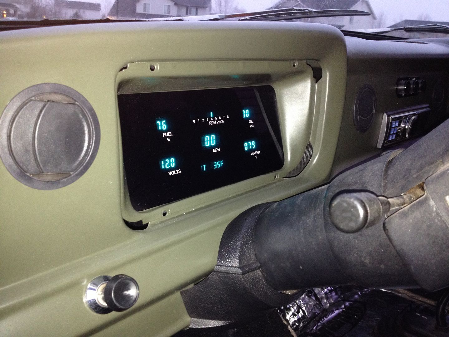

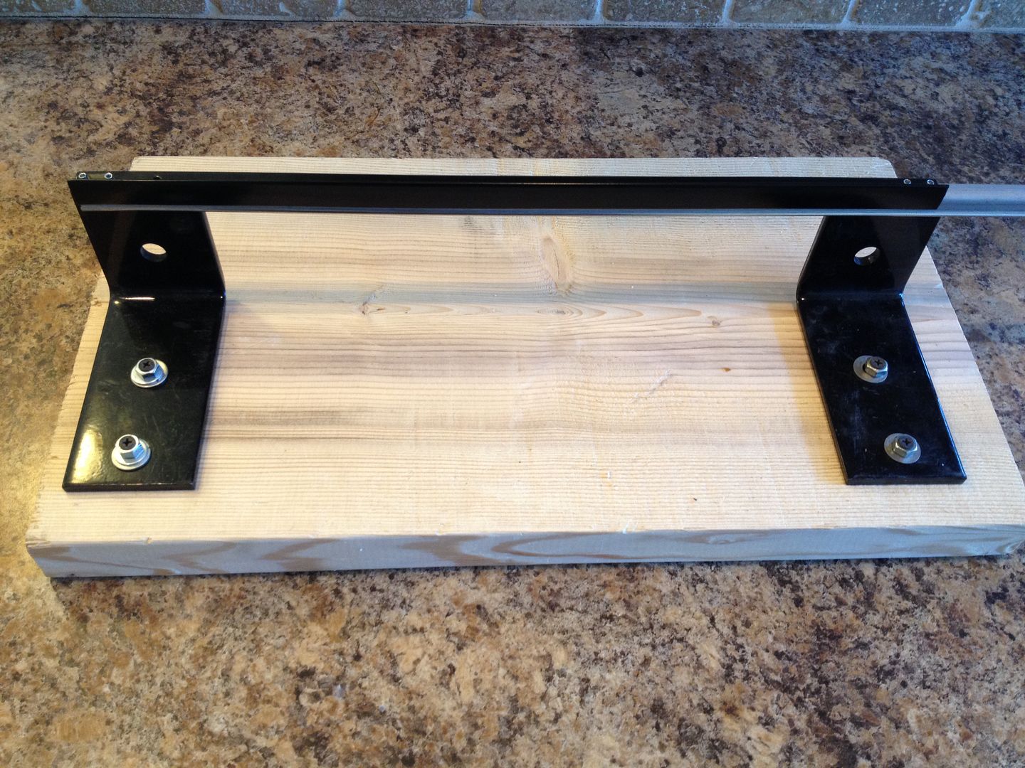

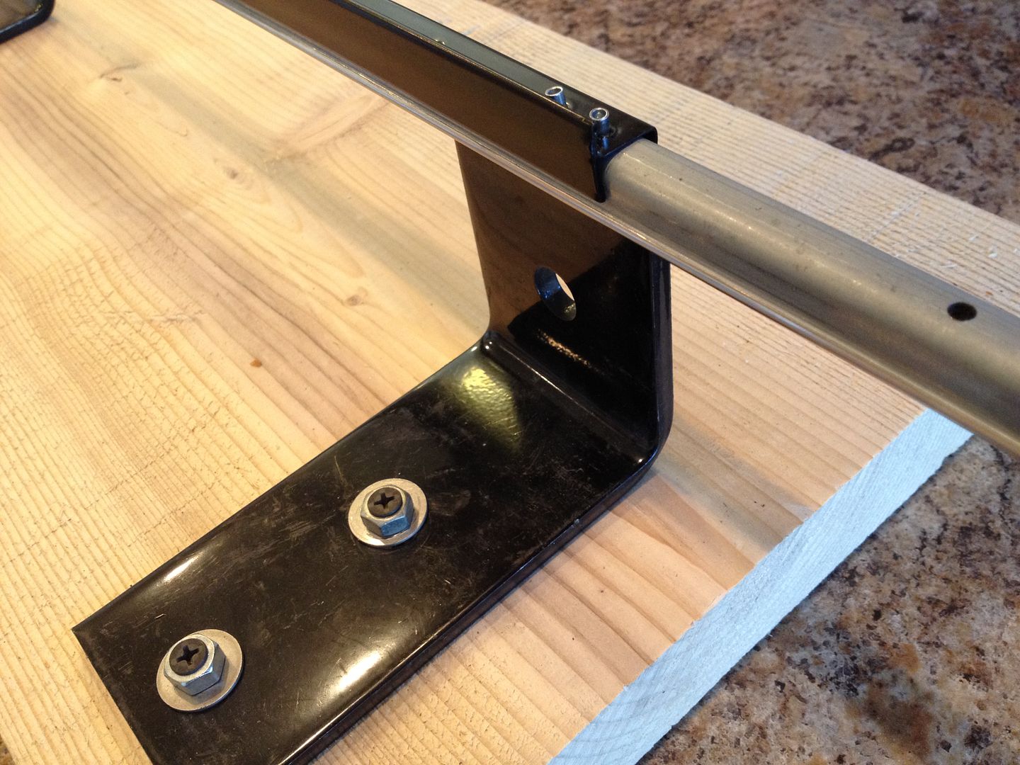

I got most of my powder-coated parts back this week. My hood hinges and some interior trim pieces will be done next week.

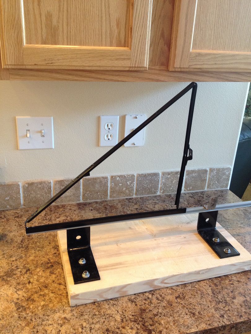

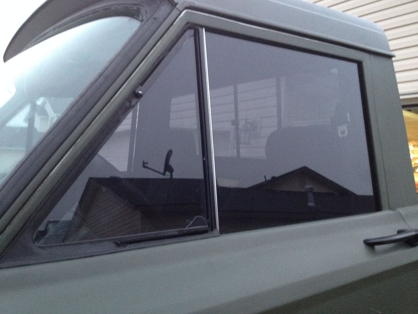

I took my vent windows apart and had them PC'd. Then I put them back together with all new seals, channel and new tinted glass. I set up a quick jig to help with the riveting process. Even with the jig, it was a total pain in the @$$....
All back together...

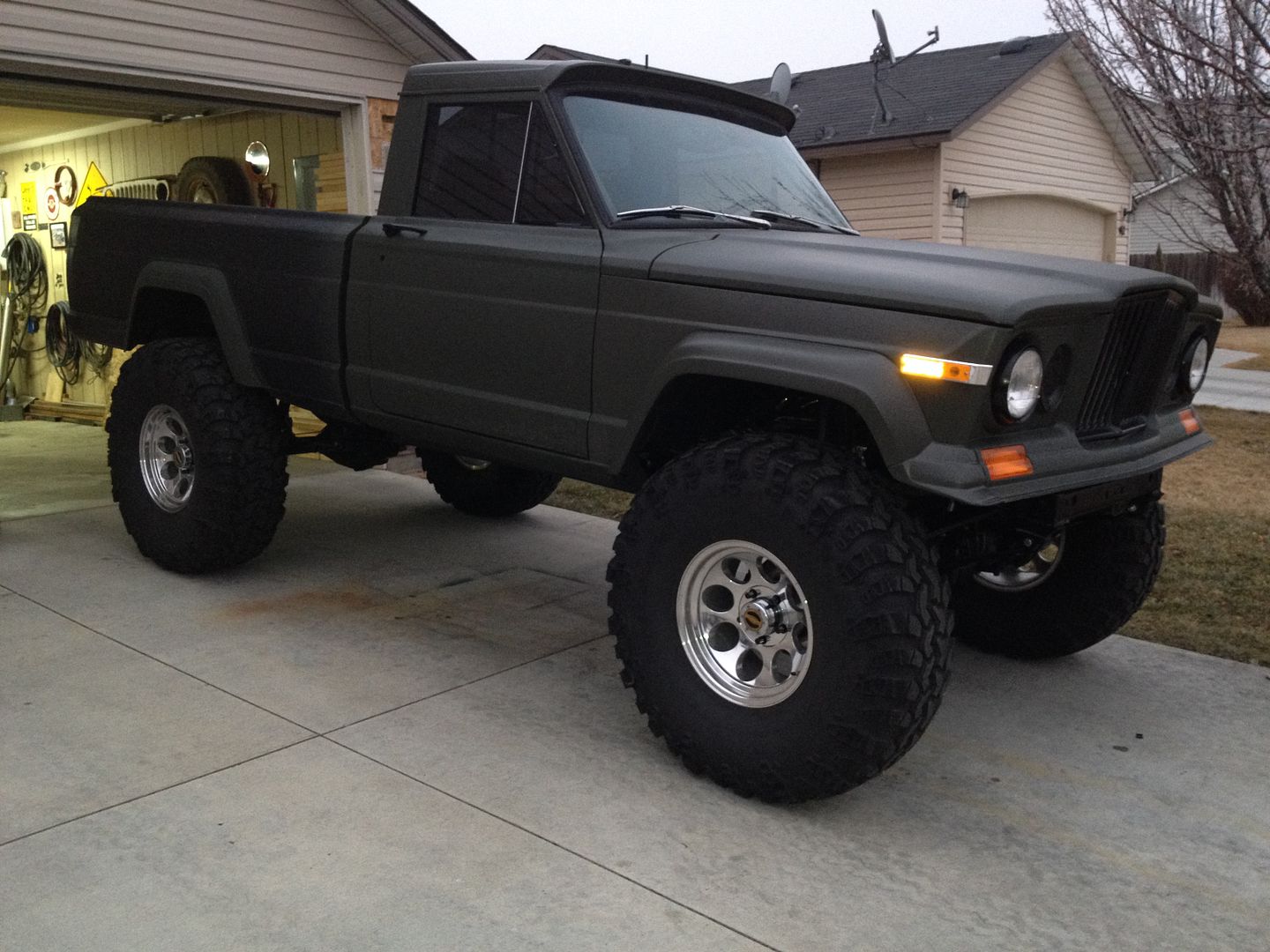

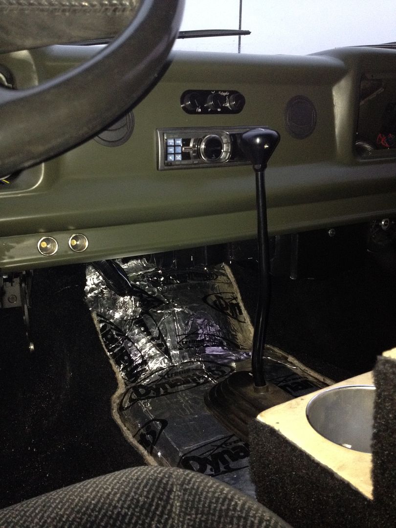

Some interior shots... Almost complete...
My Lokar shifter...
It is looking more like a real truck these days...
It sure is nice and quiet inside the cab now. The whole truck is extremely tight with no rattles or squeaks.

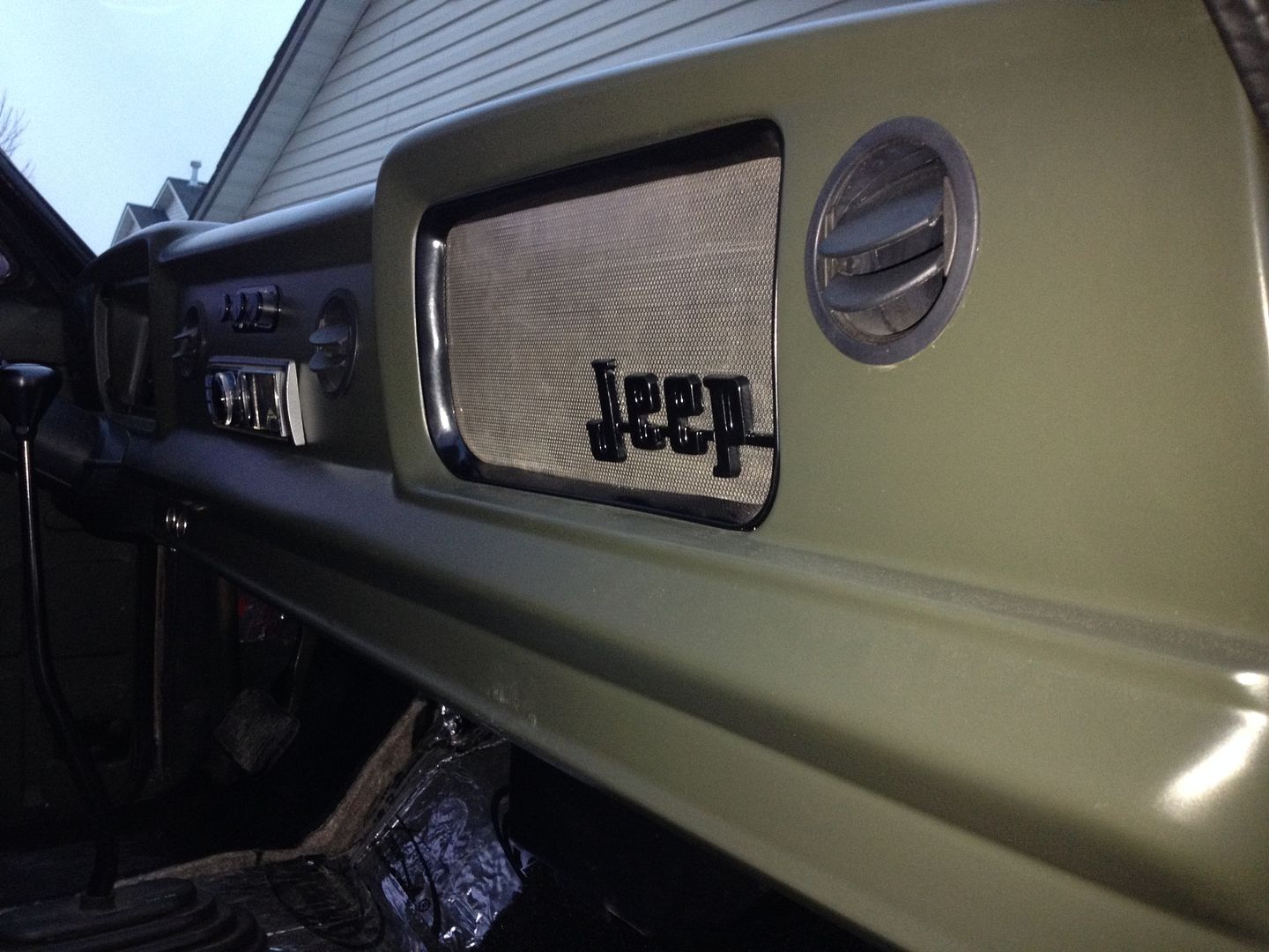

Got some more powder coated parts back today.

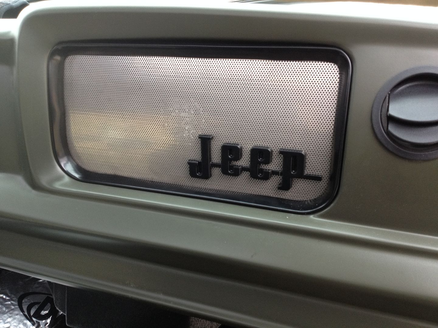

I put the JEEP emblem on the dash. I like it there much better.
My hood hinges turned out great!
One step closer...

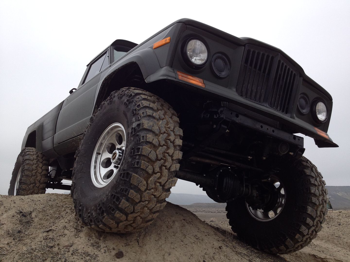

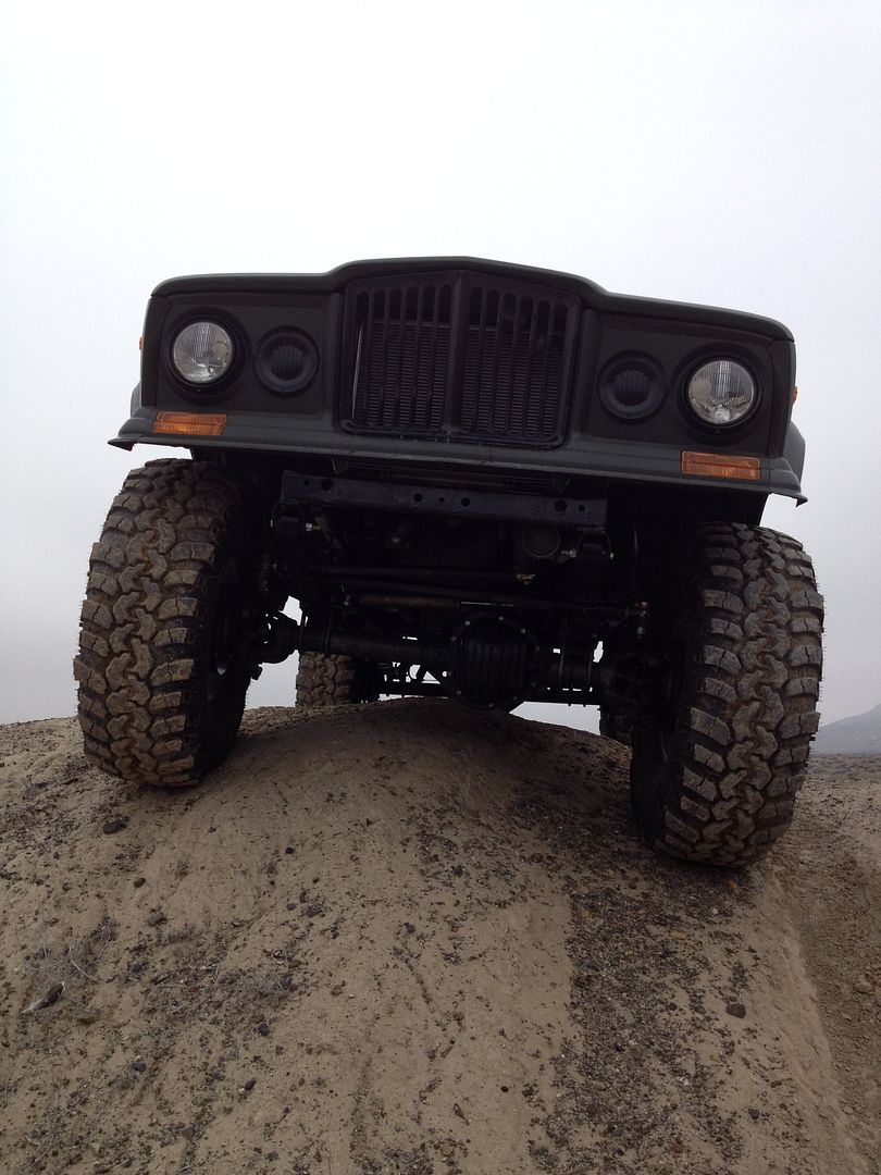

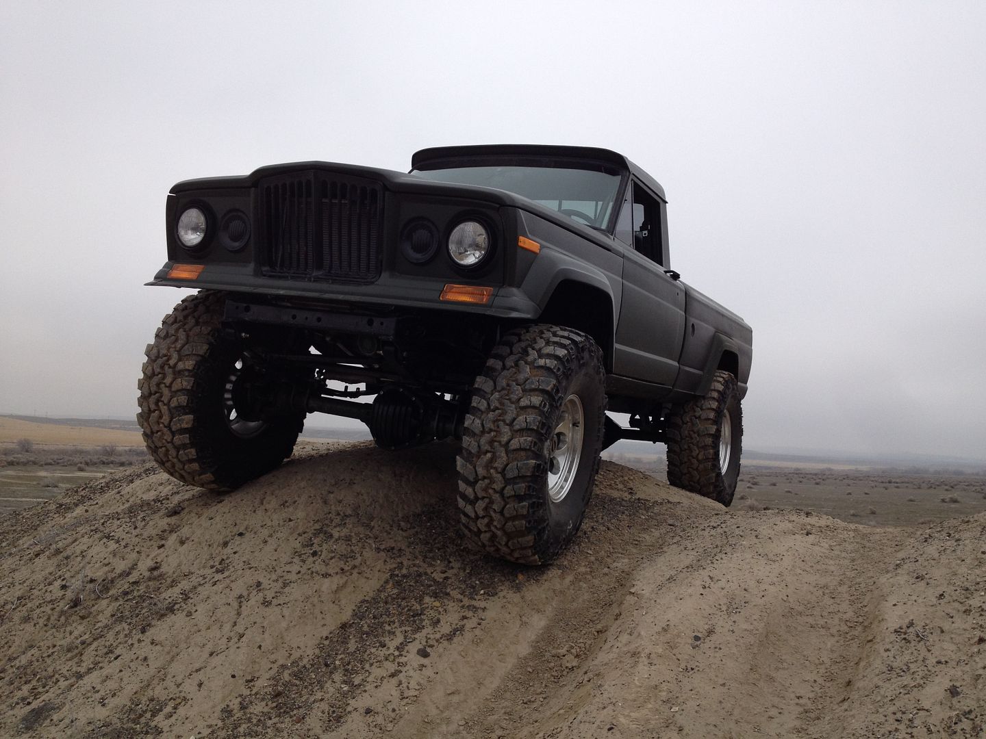

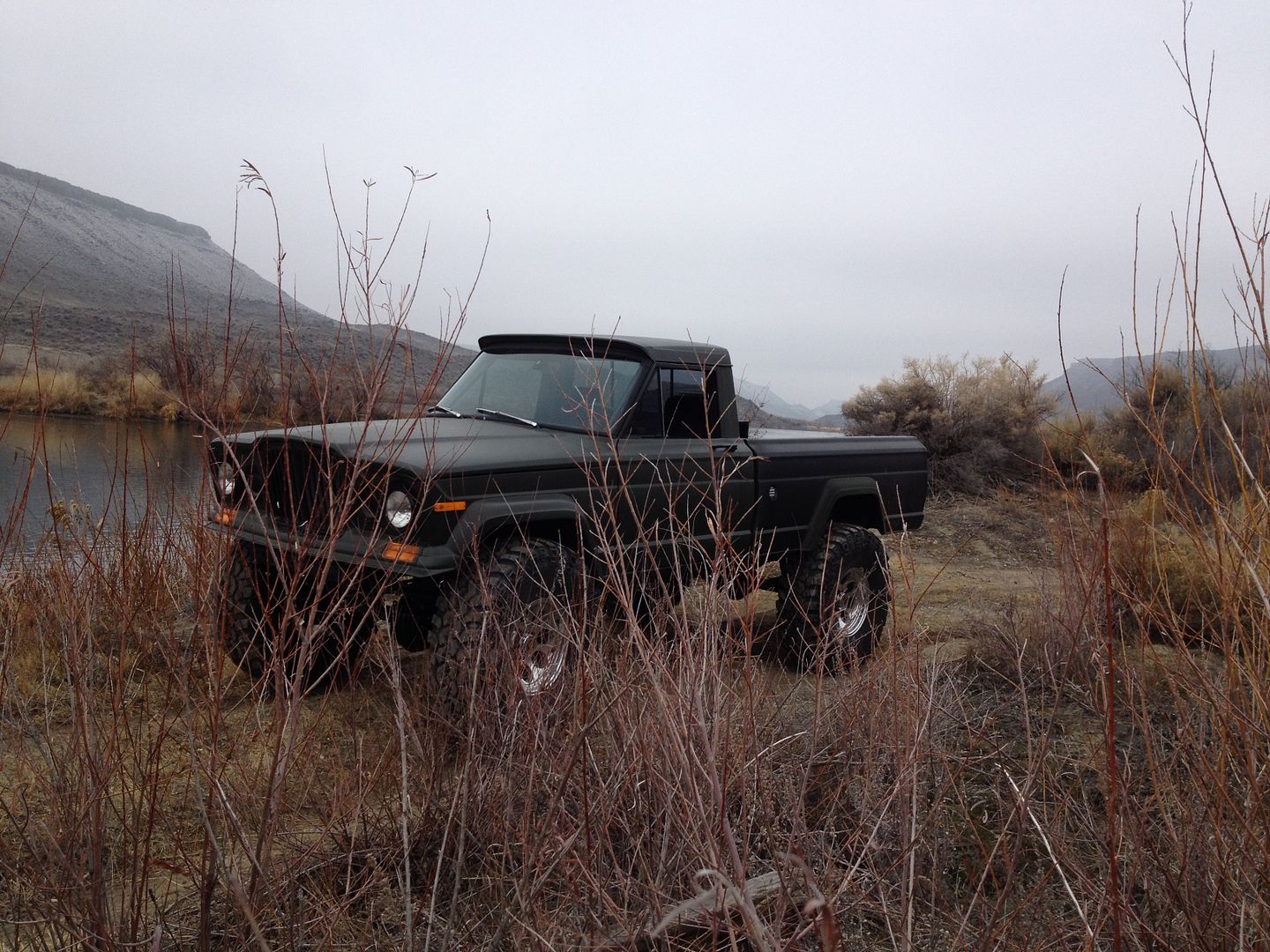

I had a great day driving through the Snake River Birds of Prey area. The Jeep did great. It felt awesome to finally enjoy it after such a long time.
Great time.

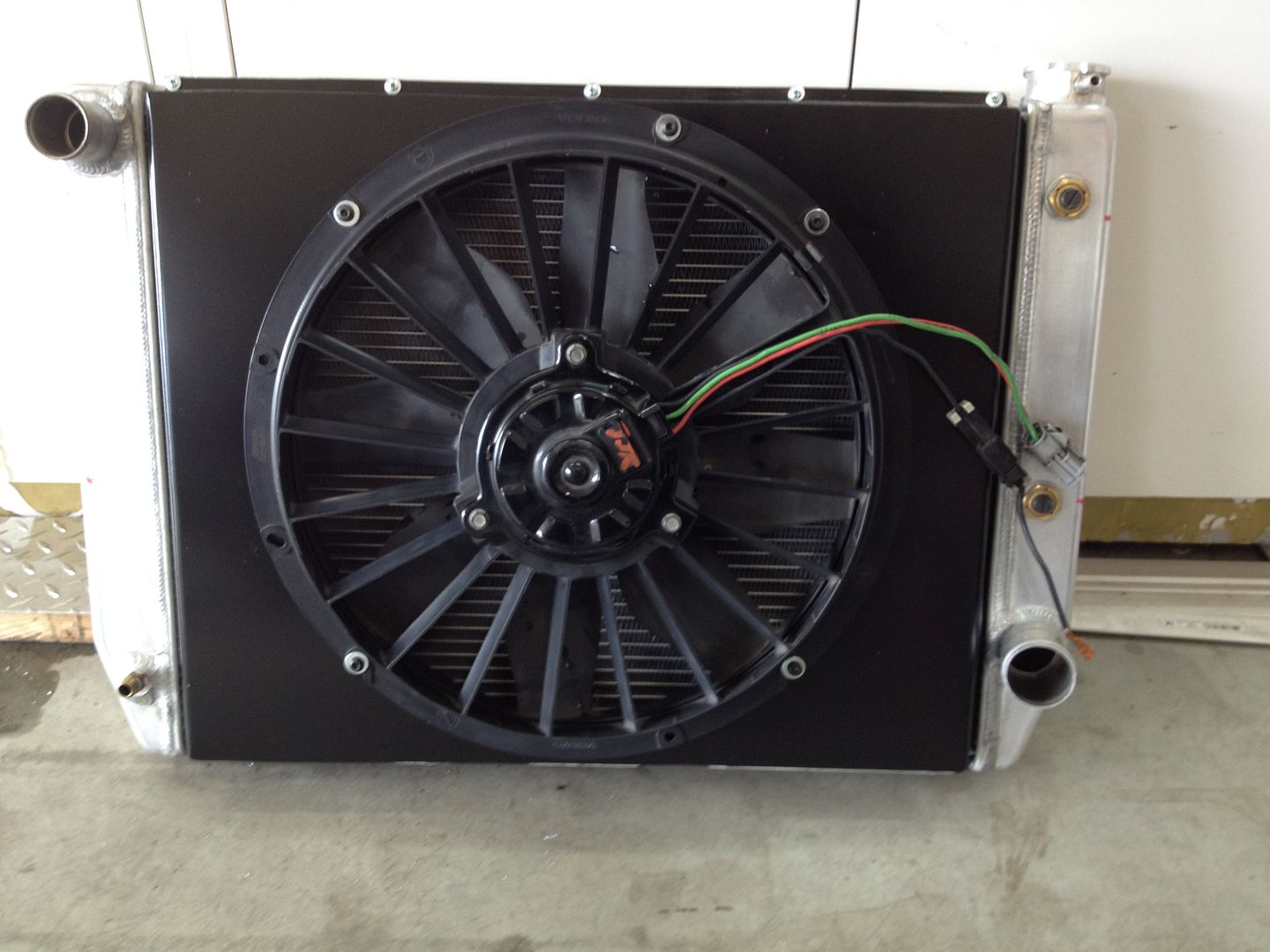

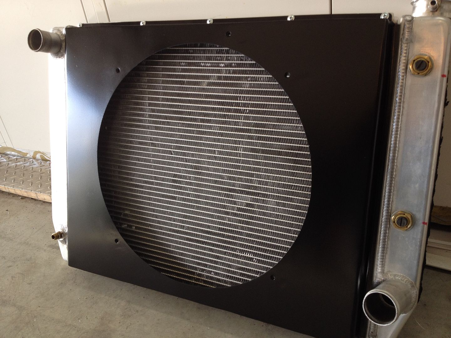

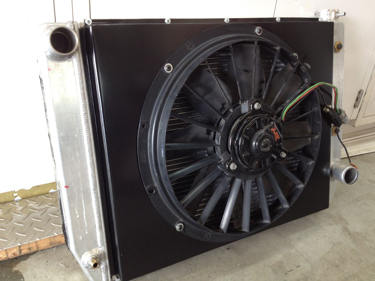

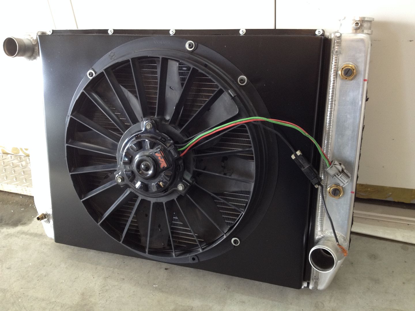

I decided to make a change on my radiator and fan setup. I picked up a much higher CFM fan from a 98 Volvo, which is the exact same fan as the very desirable Taurus fan. Except, it has a much better mounting flange. I also got the relay pack. All for $20. They are very powerful and are 2 speed.
I drew it up in CAD this morning then sent it to the plaz table. After that, I bent it into shape and welded it up and sanded it smooth.
I wasn't having any issues with the other fan. But it's winter. So I know it would not have done well with high heat. Plus it didn't cover the entire radiator surface. Now the shroud covers the whole core and it will be much more efficient.
