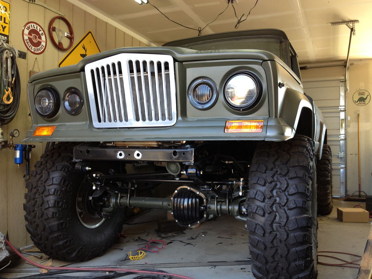

Yep! It's running beautifully. Just a few more miscellaneous things to finish up before it's ready for the first big cruise!!
Today, the front end wiring was completed and all the lights were installed. I just need to splash some black paint on the grill, but that won't take but a few minutes. Still, I couldn't resist putting it on to snap a few photos...
Just a few more days guys. After that, I'll be posting a video of it cruising down the road and climbing over some rocks...

That looks awesome! Glad you posted the pre-finish pics.

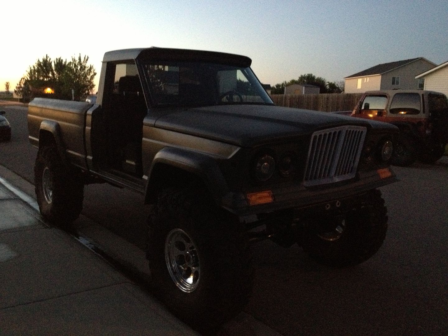

All better now. Back on the road and ready for the trail too.
Took a drive and found a field with some good piles of dirt to play on.
Now! It's time for the doors and a small list of other items to complete this project. Big priority is to get the bed sides painted now.

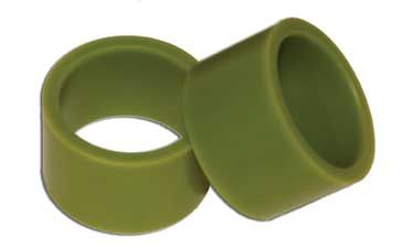

One of my inner spindle bearings melted down. So, I replaced both sides with the Extreme Spindle Bushings.
Originally, I installed them on the front, but left the original bearings on the rear. So, now I have them all the way around. They are self lubricating nylon bushings that seal out all forms of debris much better than the roller bearing style.

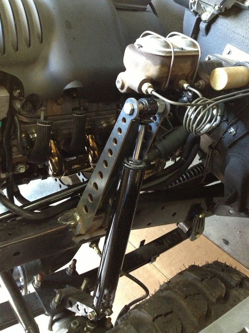

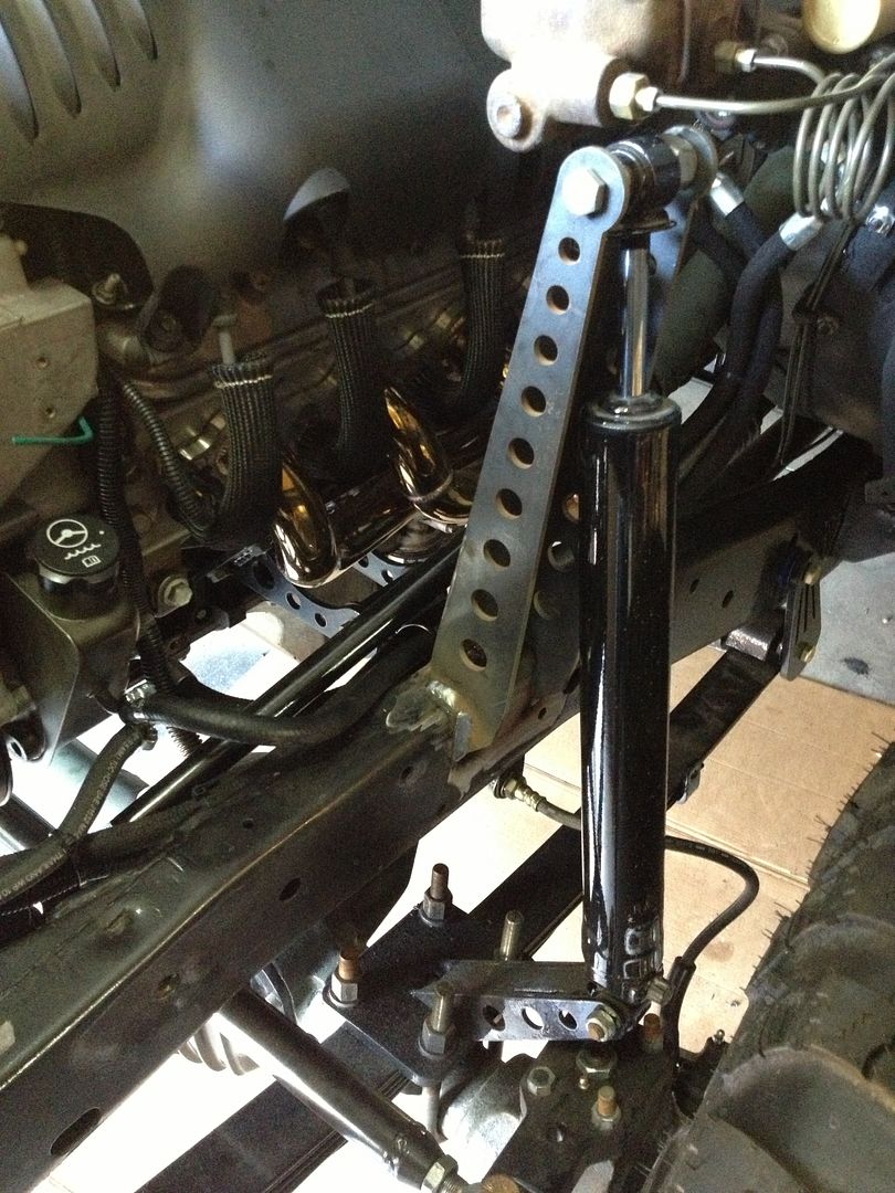

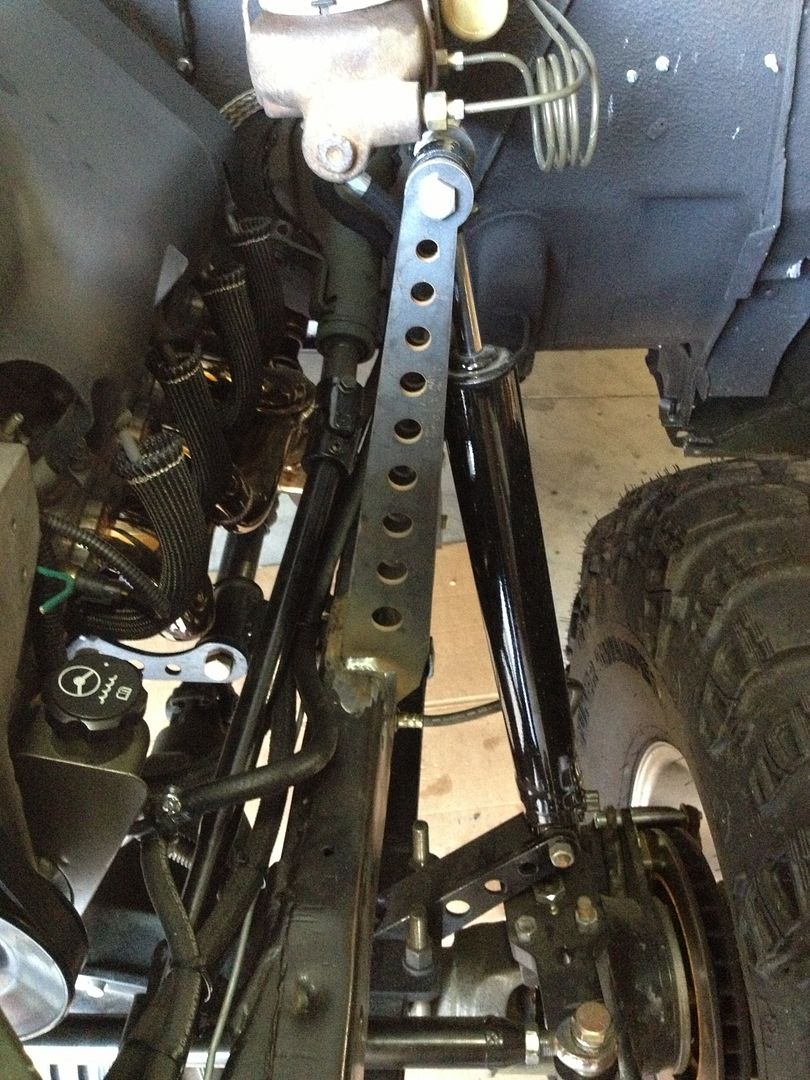

Some pics of my front shock towers. I designed these in CAD and had them cut out on the water jet. Then I welded the pieces together.
Now it's time to paint them with POR15 products.

i'd suggest extending those shock mounts down to the bottom of the frame rail, attaching just to that corner i'd be concerned about it ripping off. Also it's hard to tell from those photos but you boxed the backside?
