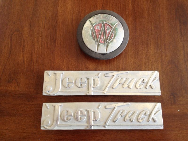

A friend of mine dropped by and gave me a set of hard to find Jeep Truck emblems. They will look great on my Gladiator.
He also left a cool horn button that is different than most.
Nice friend

Lots of people know that I am a collector of Willys Overland and Jeep memorabilia like emblems, badges, etc... including all types of shop signage new or old that have anything to do with oil, gas, tools, pinups, calendars, books, service manuals and all sorts of vintage civilian and military automotive history.
And since I can't travel or go out four wheeling and exploring like I used to since I was just a boy, my family, friends and even people I have never met, bring and even send me stuff all the time.
And the dozens of phone calls, text messages, emails and PM's that I receive every month from wonderful people all over the world are included in this list. They ask for advise and/or information about how to identify and fix problems, where to find parts or just get recommendations on how to build up their rigs. Many times they just want to talk shop or simply wish me well. And I enjoy every single call.
Anyway, they send me the things listed above as a way to say thanks. It's a wonderful part of my life that I look forward to everyday.

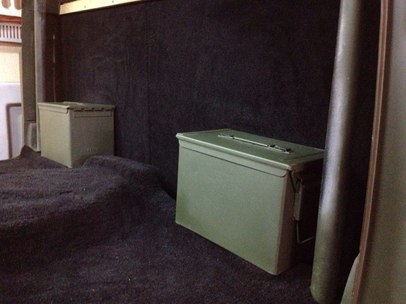

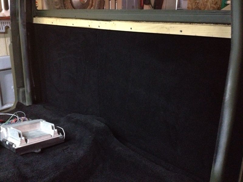

I got the carpet glued to the 1/2" wood panels that I made a while back. They mount to the back wall of the cab behind the seats. Before the carpet was glued down, the panels were sealed on all edges with 2 coats of paint. Panels like this are a great way to create attachment points for the center console, both "Fat 50" battery boxes and a number of other items. The wood trim piece at the top will be covered with a piece of painted sheet metal or strip of carpet. I prefer an accent piece of sheet metal. I will decide later.

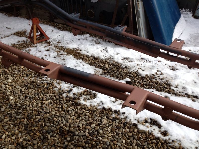

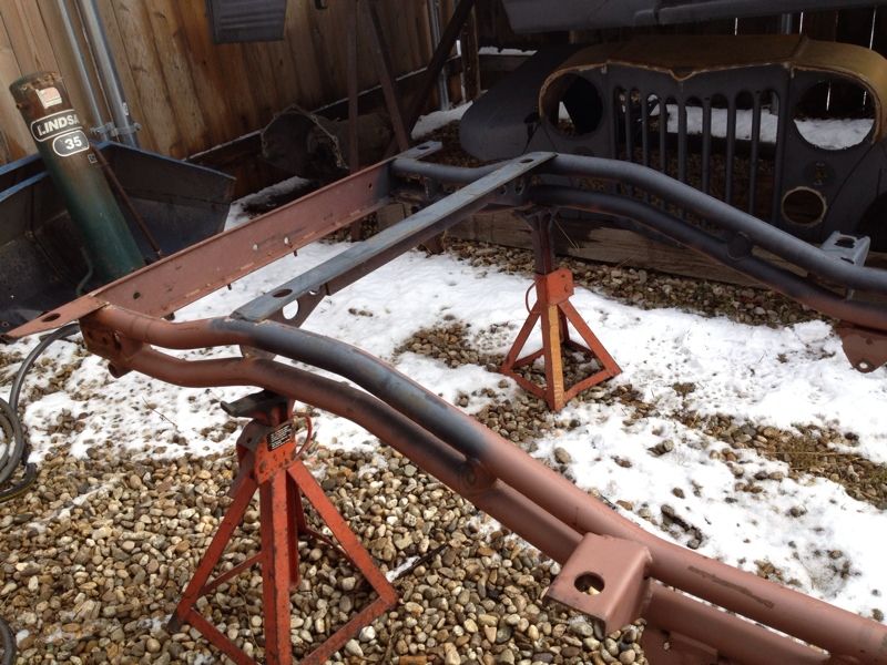

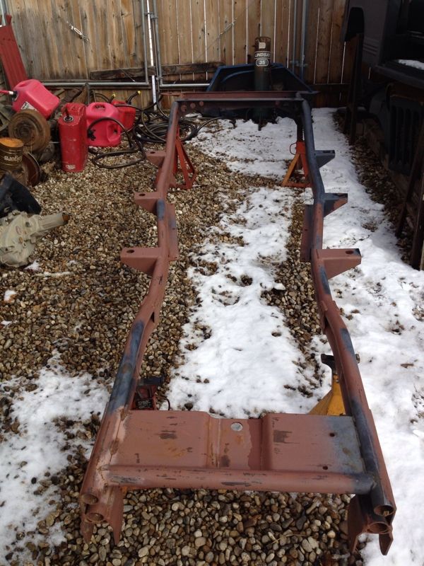

Speaking of positive things... I have some cool news about my Willys wagon. I let a friend of mine come over and use my heated shop, my design/guidance and use of my tube bender and other tools to build his custom 6-point roll cage for his Jeep CJ-7. In exchange for that, he gave me a really cool double stacked tube Jeep CJ-7 frame made from 1 7/8" OD x .120" wall tubing. It is a professionally built frame from M-Cor Inc., a company that is no longer in business. But they built very high quality frames. They were very expensive too. Especially, with the optional shackle reversal kit.
This frame will require some modifications to make it fit my wagon, but they are all simple mods. The engine cage I built for my wagon before will be welded back in place on this new frame. Plus, I hope to go ahead with a very cool 8-point roll cage inside my wagon as well. I have not yet decided if my suspension will be coils, coilovers, or air shocks. But either way, it will have a 4-link setup front and rear.
Here are some photos of it. Not great photos, but I was not able to stand for more than just a few minutes.
More to come later on. My J-truck will be finished first.
