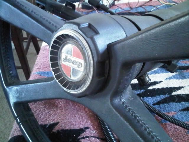

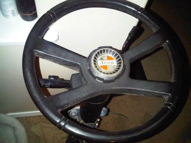

I was able to make a pretty cool and simple modification to the modern GM steering column that I plan to use for the J200. It's a nice tilt column with the hi/low beam, cruise, and intermittent wiper, turn signal combo switch. But the horn button said Chevrolet. I like the steering wheel, so I cut out the Chevrolet emblem with an exacto blade and popped in the horn button from a 78 Cherokee. The emblem matches the badge on the original Gladiator grill. I think it turned out great. And the horn still works!

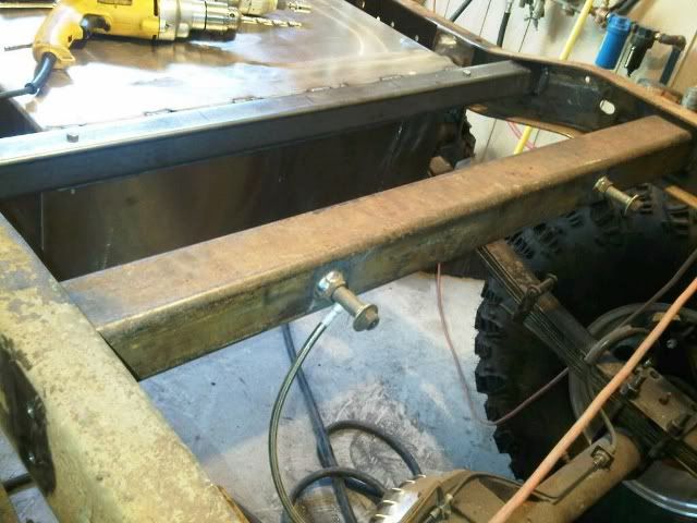

The original upper rear shock mounts and crossmember were removed and these 2 new square tube crossmembers were welded in place for the shocks and fuel tank mounts.

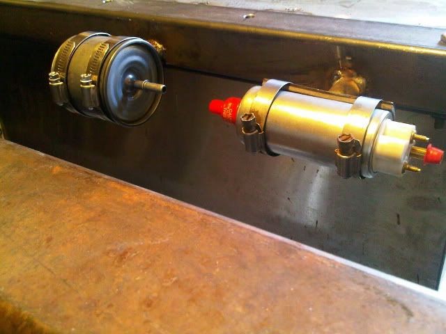

This also made a nice mounting location for the inline fuel pump and filter along with my custom made brackets.

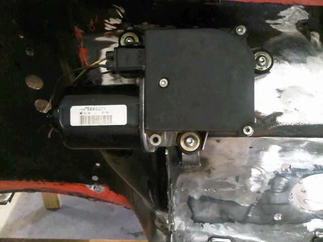

The original wiper motor/washer pump and bracket were removed and a GM wiper motor with integrated intermittent wiper control module was mounted in its place. It works great and even has the original wiper motor arm so it connects to the OEM linkage.
