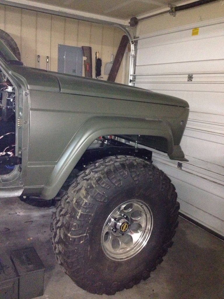

After everybody left, I snapped some pics of my truck with the hood on.

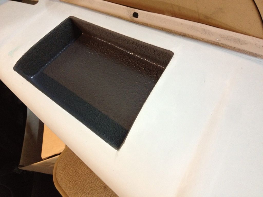

Joe dropped by today to do the final sanding and glaze spot filler on the dash. It's a beaut Clark!
The tray is also sprayed with Lizard Skin SC. Now it's ready to paint; even over the SC.
I plan to drill a hole with a grommet for my iPod cable to pass through to my stereo. It will be locked under the lid since there is no need to access it. All the controls transfer to the stereo, which also charges the iPod. I changed my mind for my iPhone though. It will have a custom place on the center console for easier access. It will have it's own charging port, so the cord won't be hanging all the way up to the dash.

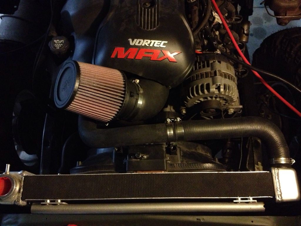

The radiator, hoses, electric fan, AC condenser, heater hoses, hydroboost hoses, AGR Rock Ram and hoses, power steering hoses with inline cooler and temp sender are all installed and ready to go now too. The transmission cooler with 8" electric fan are mounted under the pickup bed above the driveline. The hoses and trans temp sender are also installed.

Man that is a really clean build not all flashy and goddy. Did you put that rake in the sespension yourself or is it just tired springs in the front

The springs are all brand new and the rake is not much really. It's just under 1 degree.
With a full tank of gas, a tailgate, rear bumper and other miscellaneous items, it should settle down and be perfectly level. If it ever settles too far, I can put spacers between the perches and springs to level it out.
