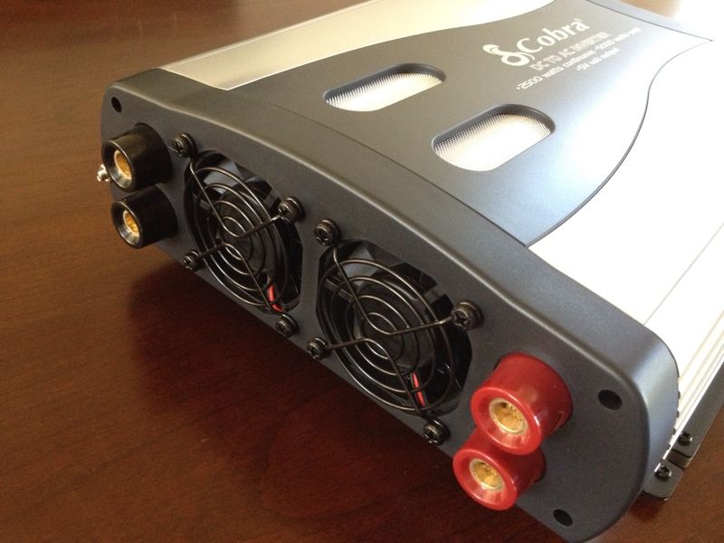

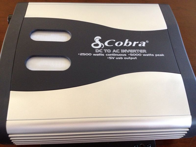

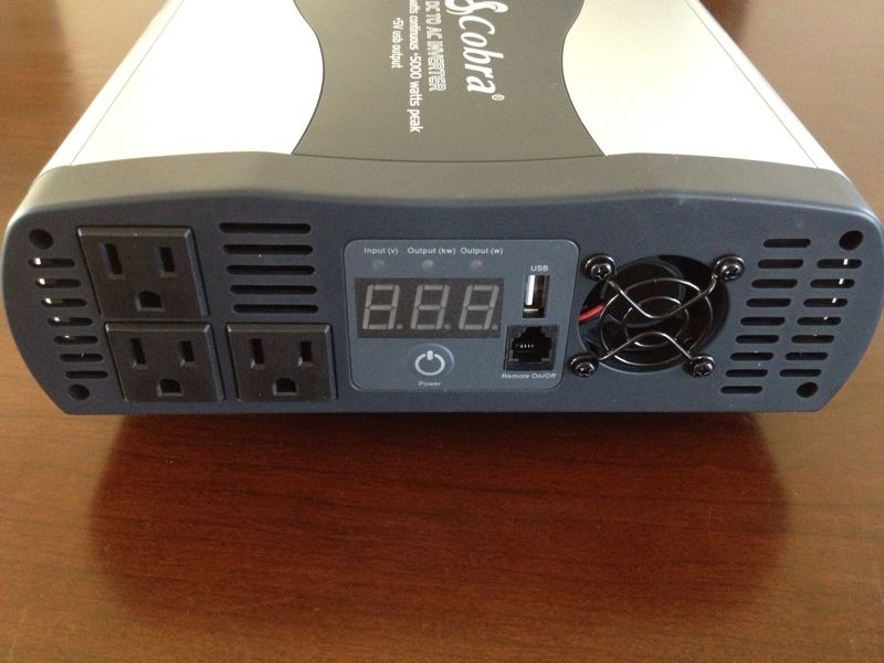

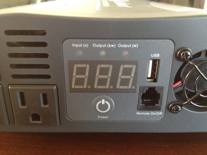

I finally decided on which power inverter will work best for my truck. I bought it at a significantly reduced sale price. It provides more than enough power for my needs and has some great features:
I chose the Cobra CPI 2575. It's a 12 volt DC to 120 volt AC power inverter with 2500 watts continuous power handling and 5000 Watts peak power. This unit contains a 5 volt USB output, modified sine wave, thermal shutdown, reverse polarity protection, low voltage shutdown, low voltage alarm, 3 grounded AC receptacles, LED volt/watt meter and has remote on/off capability.
It arrived today and I am very impressed with the look and quality.

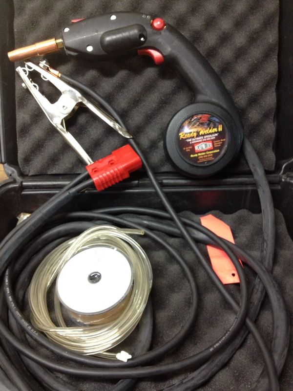

I am running dual batteries with an isolator and main disconnect switch. I will be running everything with 12 volts of course. But if I ever need to use my Ready Welder II, I'll need to switch to 24 volts. However, switching to 24 volts without disconnecting the batteries from all vehicle systems would destroy everything.
I struggled with trying to figure out how to accomplish this goal for quite some time, because disconnecting the batteries would erase the ECU and stereo memory/presets, among other things. And it would also mean that the engine wouldn't run well until the ECU re-learned everything. Plus, it would be a pain to reset all the stereo presets, etc.
So, I finally found a solution. I bought an $8.00 9V Computer Memory Saver that is designed to maintain the memory of the ECU when the power source is disconnected. It's quite a simple device that uses a standard 9-volt battery and plugs into any cigarette lighter style power outlet.
So, first I plug in the memory saver, then turn off the master switch. Then I can switch the batteries from parallel to series and I'm ready to plug in my Ready Welder II spool gun. I will have quick disconnects at the front and rear of my truck.
Here is the memory saver:
Here is the master switch:
The above switch is a Medium Duty Main Battery Disconnect Switch with a key lock. It is for 12, 24 and 32 volt electrical systems with a capacity rating of 250 amps continuous, 360 amps intermittent. It is also sealed for marine applications.
Here are the quick disconnects:
I also have one end of my jumper cables set up with the quick disconnects:
Here is the Ready Welder II:
My winch will be set up the same way, so I can quickly connect it whenever it's needed. It's also an added level of security leavinwg it disconnected until it's needed, which minimizes the risk of accidental operation, etc.
I haven't yet found a switch that will allow easy conversion back and forth without having to disconnect battery cables. But I will find something or design my own.
UPDATE: I finally found a very cool blade switch that allows easy switching back and forth between parallel and series without having to disconnect battery cables and all that BS. It took me forever to find this switch.
It's a double-pole, double-throw switch that connects two 12-volt batteries either in parallel for maximum current and charging or in series for 24-volt use. Opening the switch disconnects both batteries for storage or electrical work.
It's surface mounted and it is only 4-3/4"W x 6-3/8"L x 2"H. So, it will fit nicely in my center console.
I gave them a call and they said it will work perfectly for what I'm trying to do.

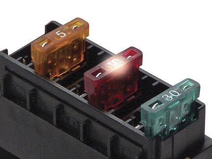

I found another cool thing that I am putting in my Gladiator. These are LED ATO fuses that light up whenever they burn out.
I know these aren't new or really that big of thing, but everything I do now is based on creating maximum comfort and minimizing pain. And by being able to immediately see which fuse is out, means I won't have to mess around under the dash testing each fuse or pulling them out one at a time, or trying to read a diagram at night on the side of the road, while I try to find the one that's blown.
2 seconds and I'm back on the road. When you've been through everything I have been through, it's really interesting how focused ya get on these little things. I just can't afford to take any risks and get hurt worse than I am already.
In addition to these new LED fuses, I have included 4 blue LED courtesy lights under the dash. All the accent lights and Dakota Digital gauge lights are blue as well.

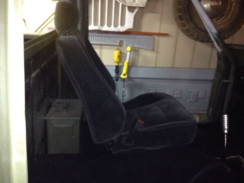

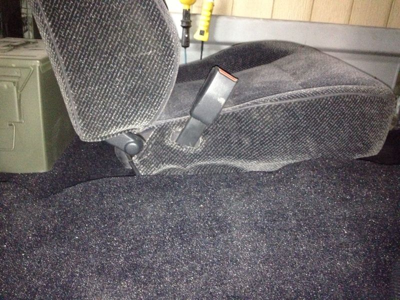

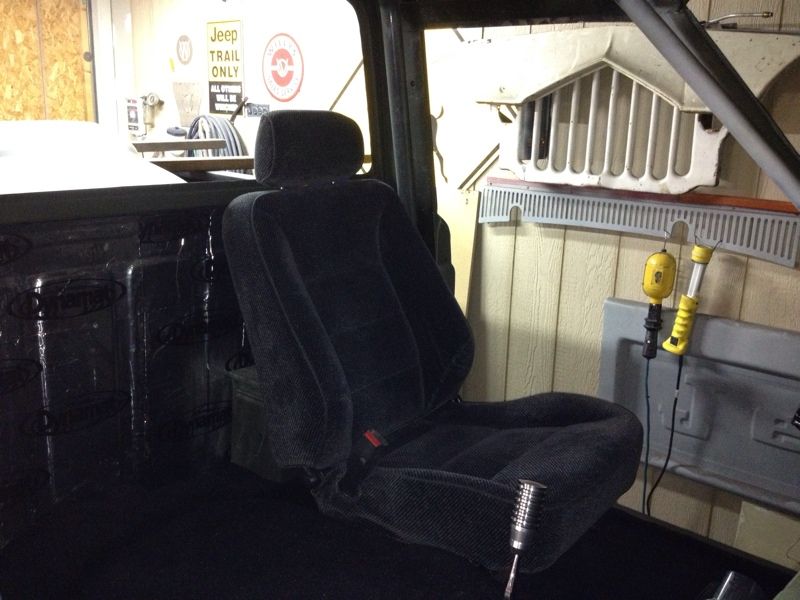

My friend Travis dropped by this afternoon to help make some minor modifications to my new seats so they will fit correctly. In my limited experience with modifying FSJ's, it's very difficult to install any other seats than the originals, because the transmission tunnel is so ridiculously huge. And without making mods to the tunnel or the seat sliders & mounts, they sit way too high. And since I already bought new carpet that is molded to fit the shape of the tunnel, I chose to modify the seats.
It only took about 10 minutes for each seat and I am very happy with the results. They now sit at the perfect height. They aren't fully installed yet, but from here on it's a simple process. They are going to look terrific and they are very comfortable.
Here are a few pics of the mockup with one of the battery boxes behind it:
I'm very excited to finally get to this point, because once the seats are installed the center console can be made. My dad picked up the plywood for me months ago and it is at his house along with all the woodworking tools. It will be covered with a combination of carpet, black vinyl and 1/8" round hole perforated stainless metal.
More about that later. After the console is completed, all the electrical components can be mounted inside. It will be sweet.
