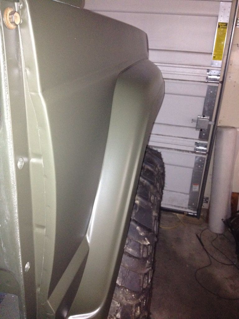

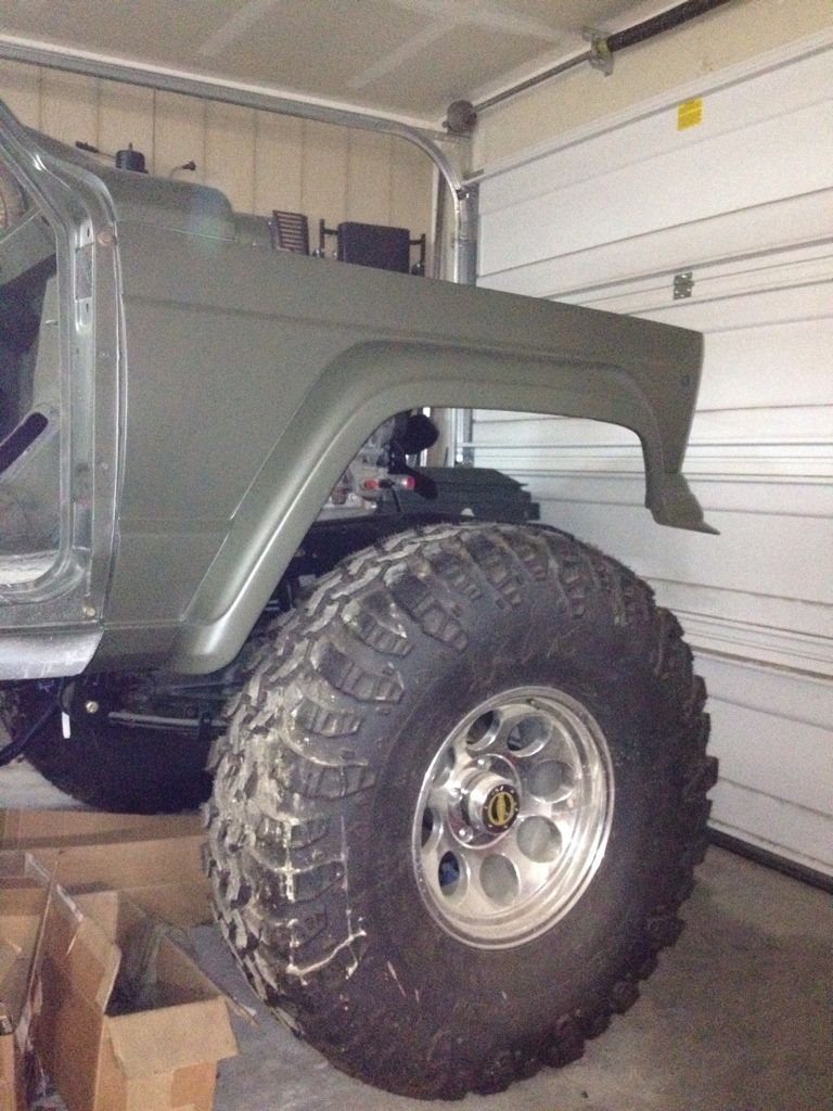

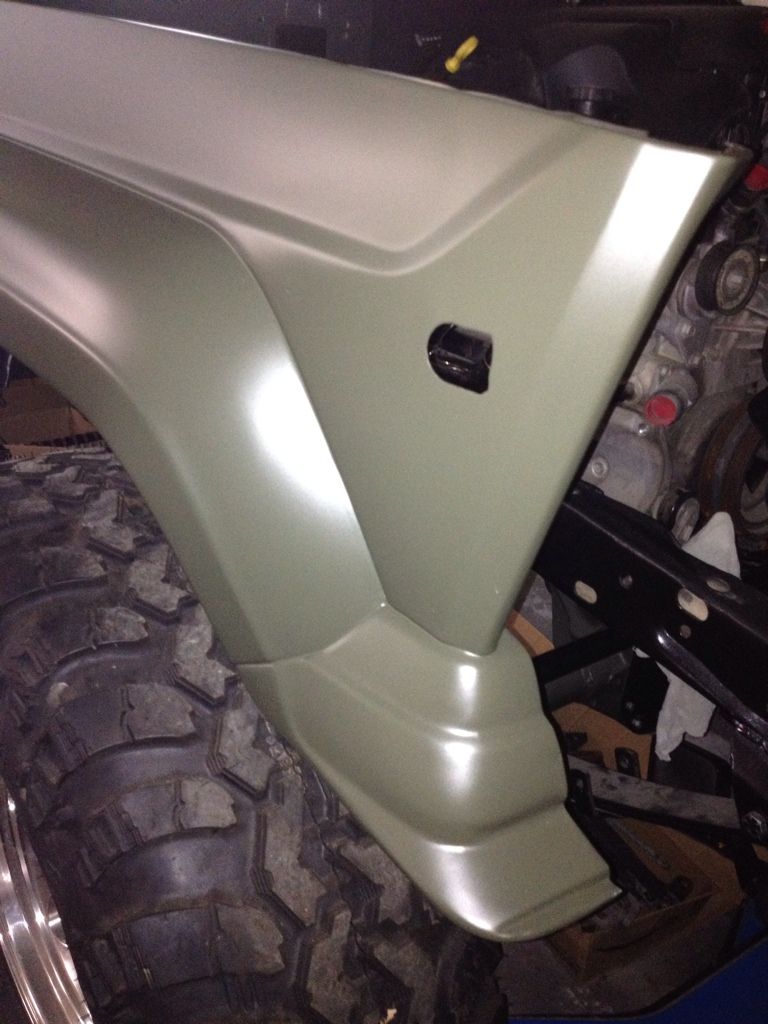

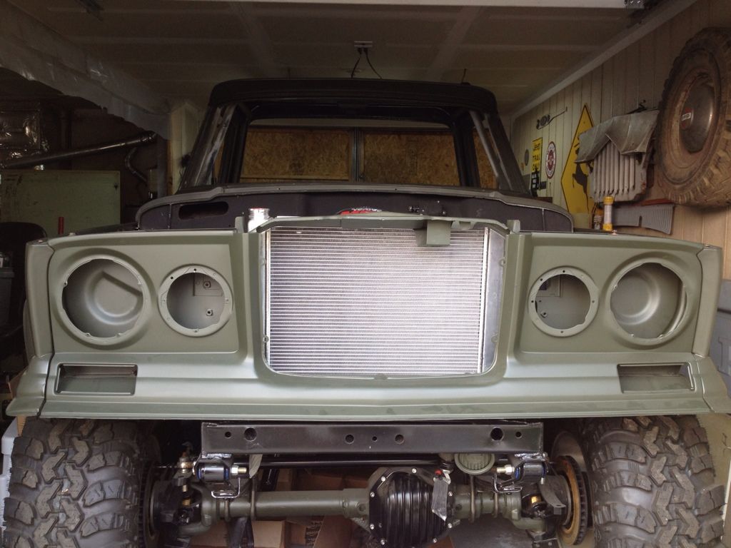

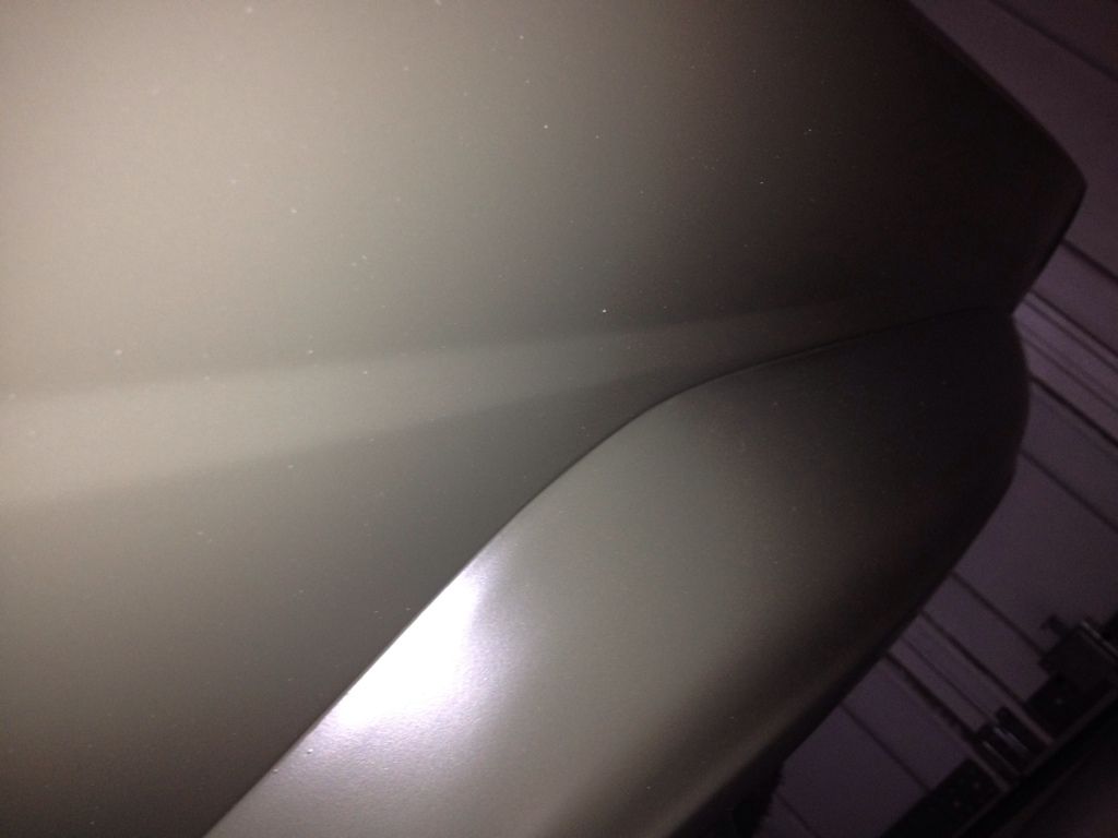

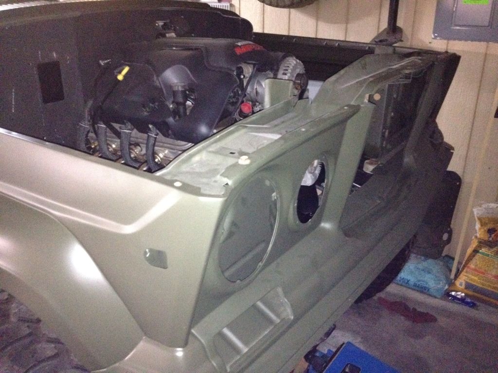

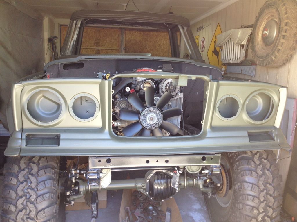

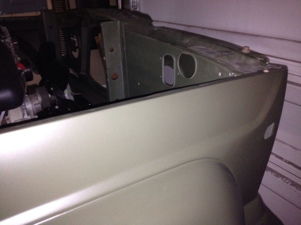

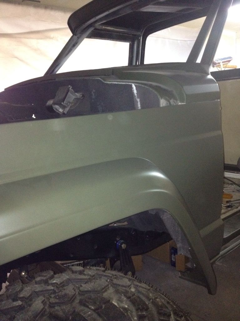

Some pictures showing the clearance between the front fenders and the 41" IROKs. By the way, all the body parts are only bolted temporarily in these photos until my new black bolts arrive. Black bolts will add that little bit of extra style and finish to the entire project.

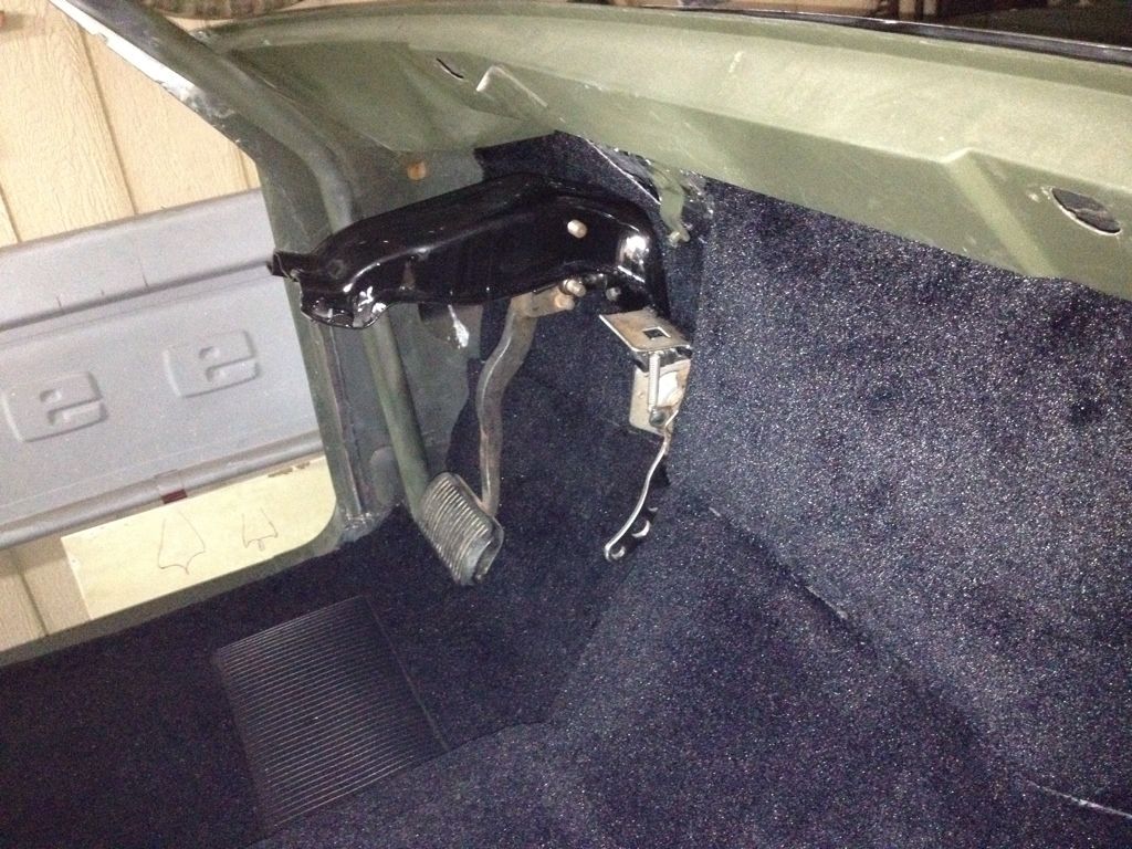

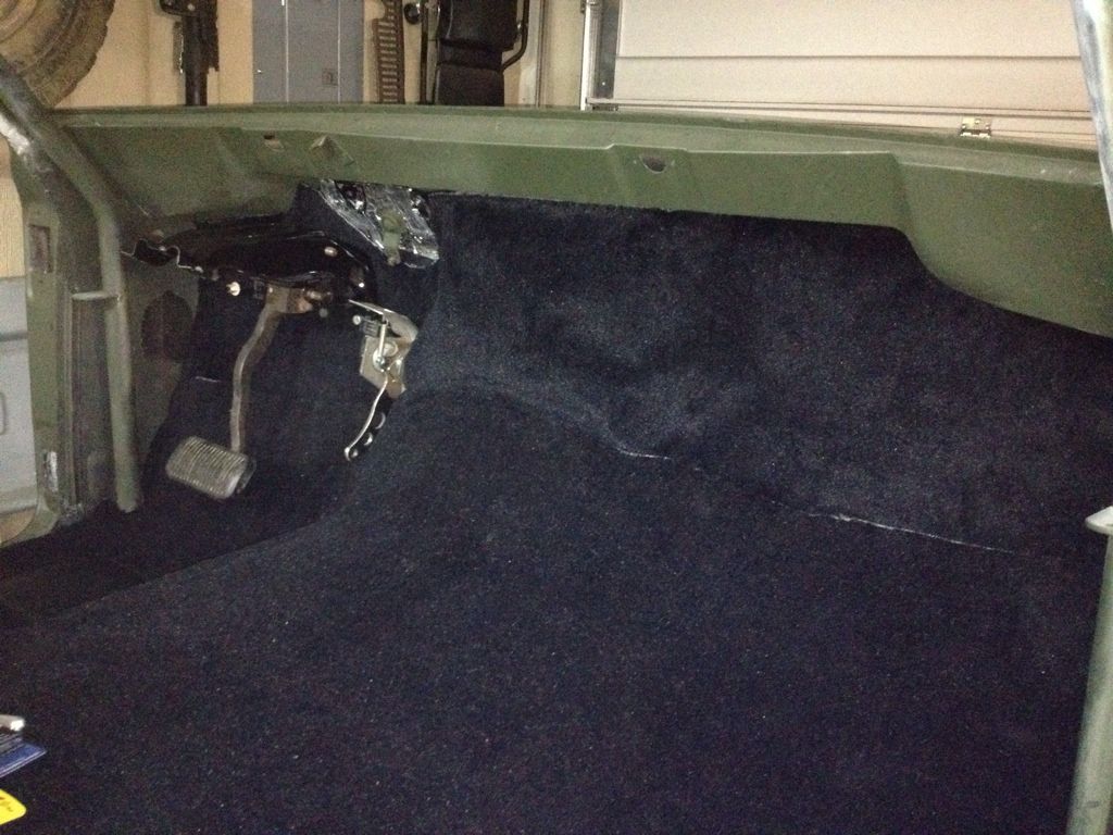

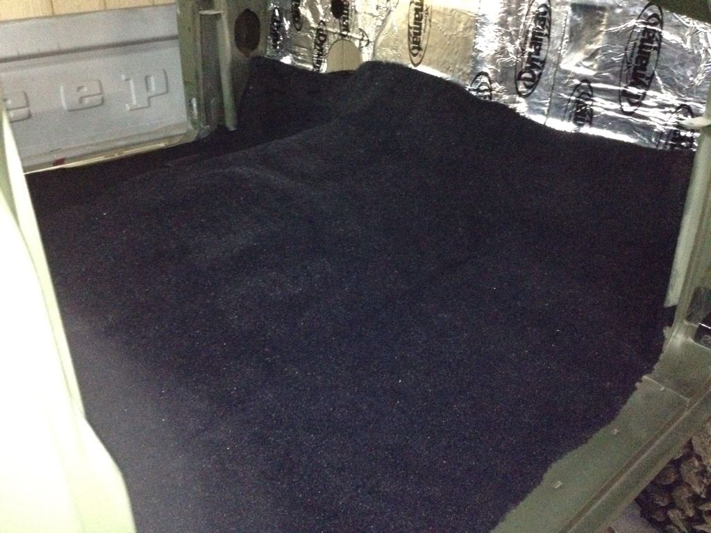

Some photos of the carpet being installed over the Dynamat.
The final install of the hydroboost brakes, Corvette disc/disc master cylinder, steering column bracket, 6.0L DBW fuel pedal and wiper motor/linkage are all installed for the final time. They will be brushed with various colors of POR15 products right in place. Next, will be the Vintage Air system, dash, steering column and seats. Then the center console can be built to contain dual Optima batteries, ECM, fuse panels, DBW module, relays and stereo amp. And the front part of the center console will hold the custom made automatic shifter and t-case shifters.
This design will make it possible to keep the underside of the dash and engine bay uncluttered.
More to come as I am able.

I really klike the way you sealed all the seams, it looks SOOO CLEAN!
