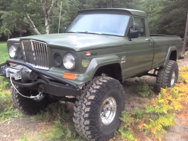

I ran across this J20 long bed tonight and have to say that this is the closest to how mine will look when it's done. Similar color, same wheels and tires. Except these are 42" IROKs and mine are 41's. It is exciting to see this. I have even bigger plans and exciting designs going into mine. But his is a beauty for sure. By the way, this shows exactly how I plan to trim my front fender flares on the front bottom edge.
I can't wait to see mine completed. Especially, standing next to my Willys wagon. That will be quite a day if it ever comes.
