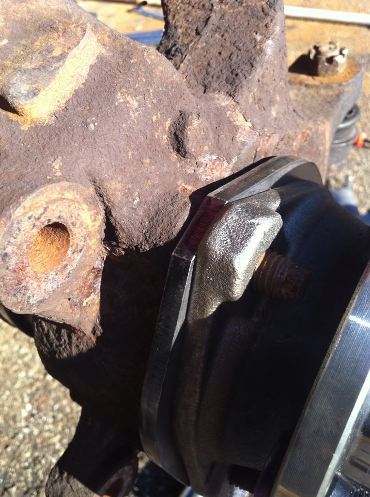

well i finally got the jks flange spacers i've been waiting on.
spacers in place with the cv's and hubs installed
and here's 2 pics of the three 12 point bolts that hold the hubs on
looking a little closer to a truck again
and here's some pics of the track bar on with a new end i bought this morning
planning on drilling the rotors tomorrow and getting the brakes put on
