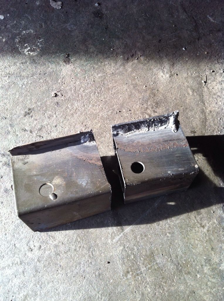

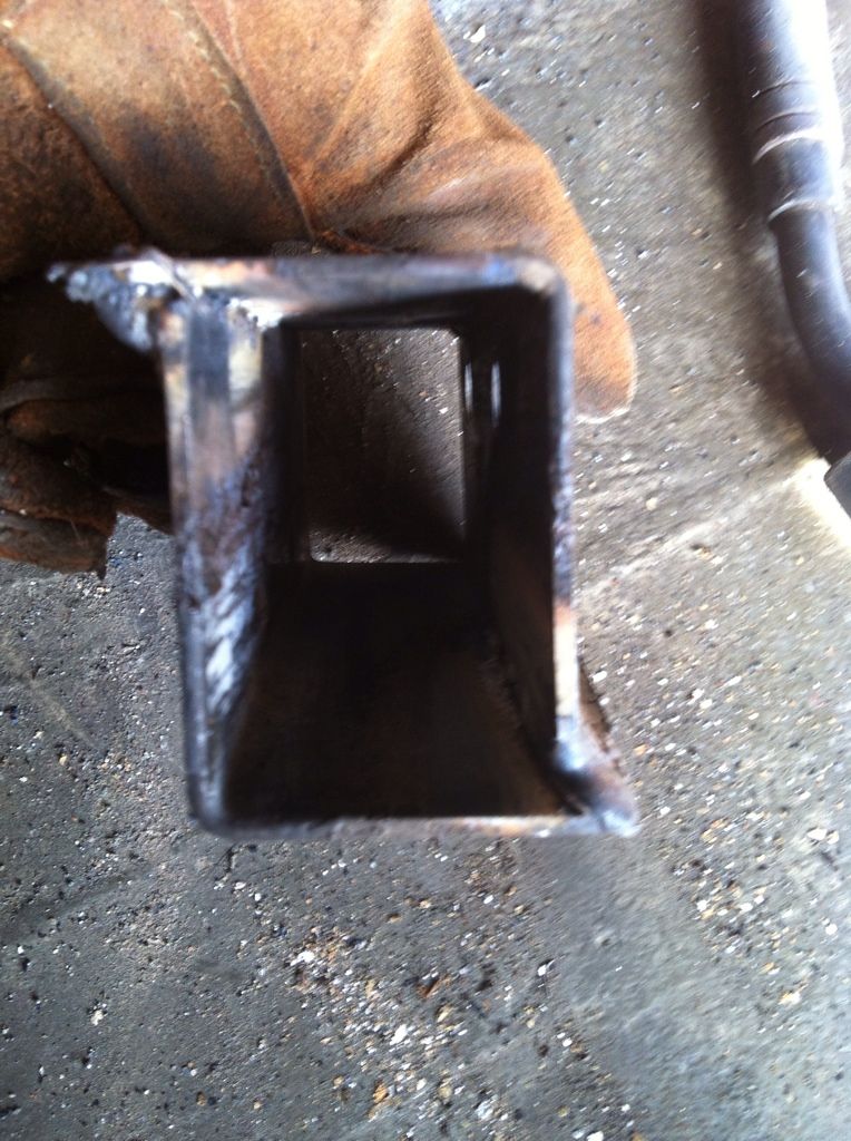

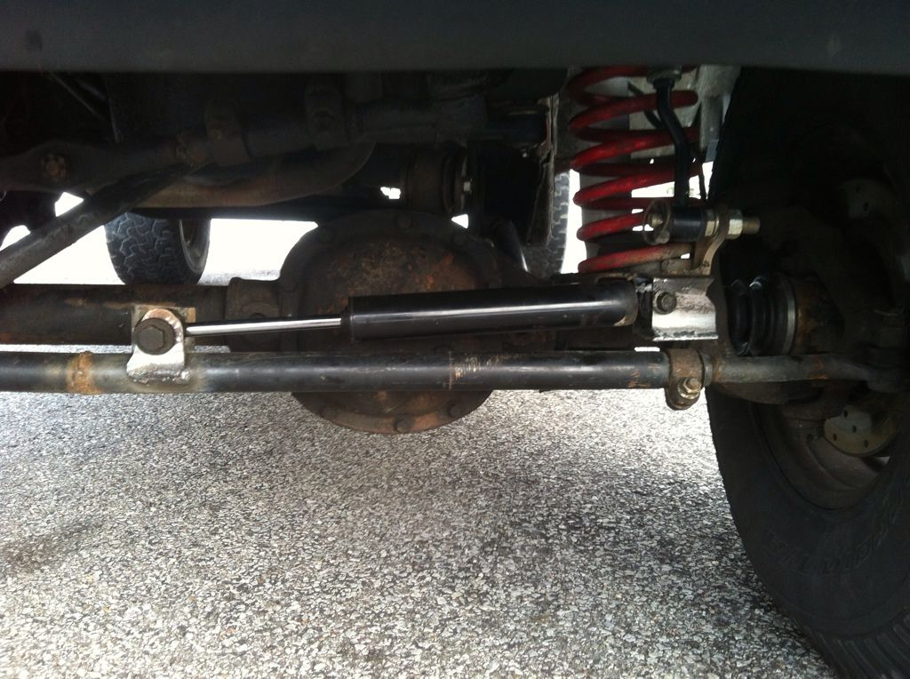

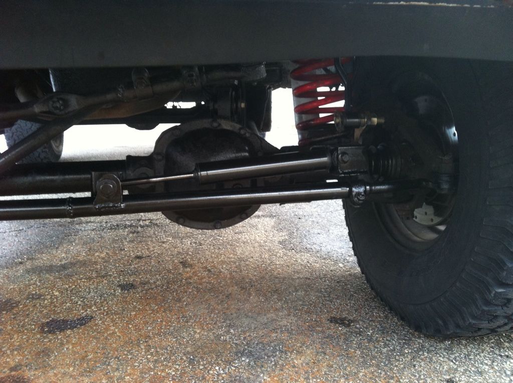

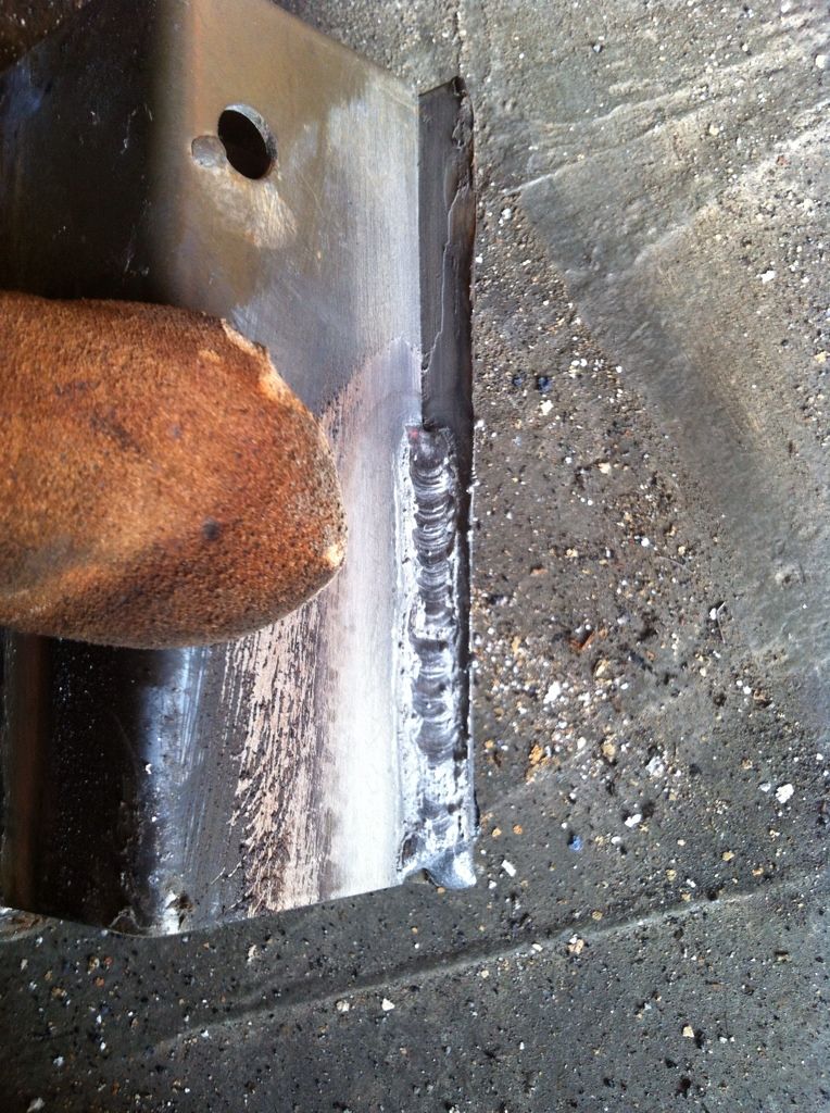

well i got bored today and decided to fab up a dual steering stabilizer. i've always thought this truck could use one after the lift it felt unstable on bumps in the road. so started out with two peices of angle iron, i basically just laid them opposite of each other and held the stabilizer end between them to get the right width and then tacked them together.
then i ran a bead down each side
then i cut it down to size

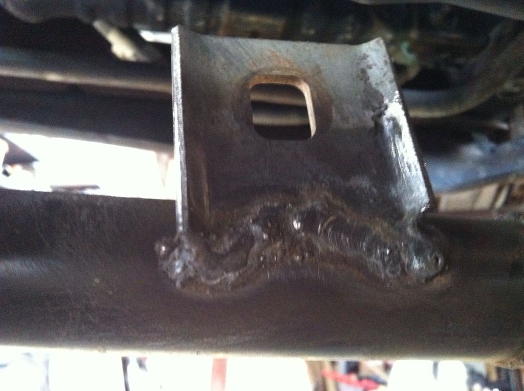

after that i did a little grinding and smoothing and then welded it into place in front of the coil spring plate almost identical to the opposite side and at a slight outward angle to reach the tie rod

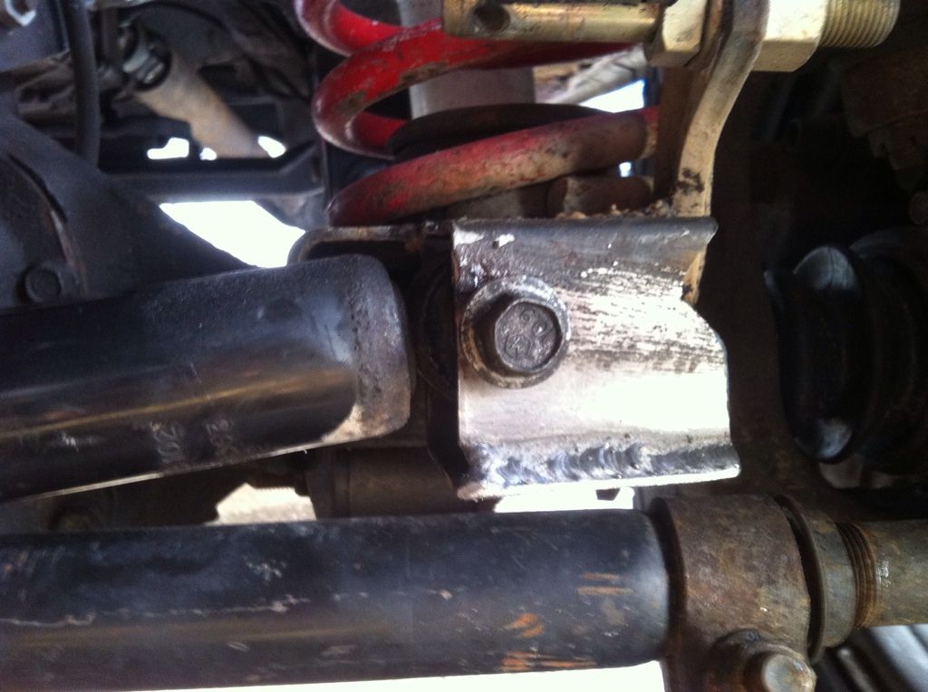

then i made some tabs to mount the stabilizer to the tie rod and welded those on

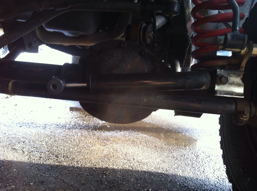

and here's how it came out
then a fresh coat of paint!
