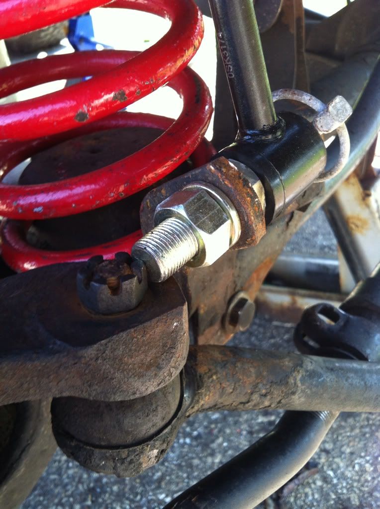

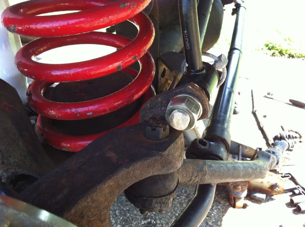

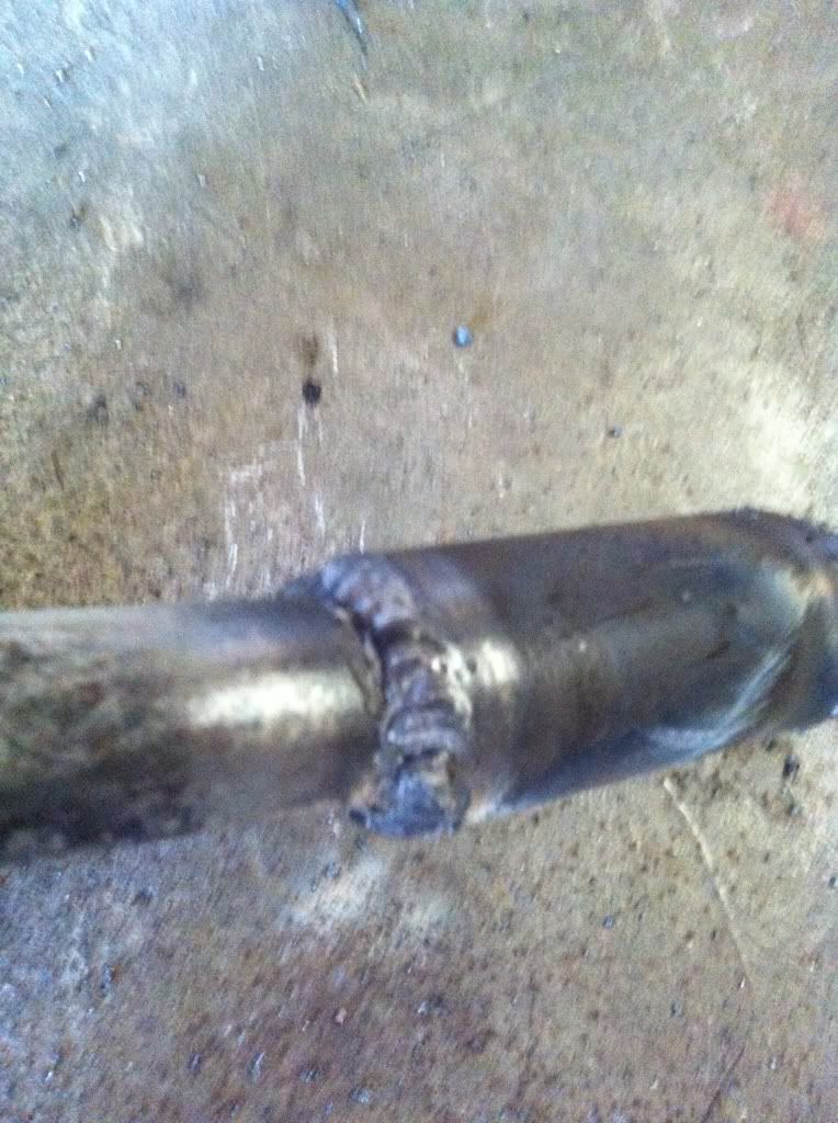

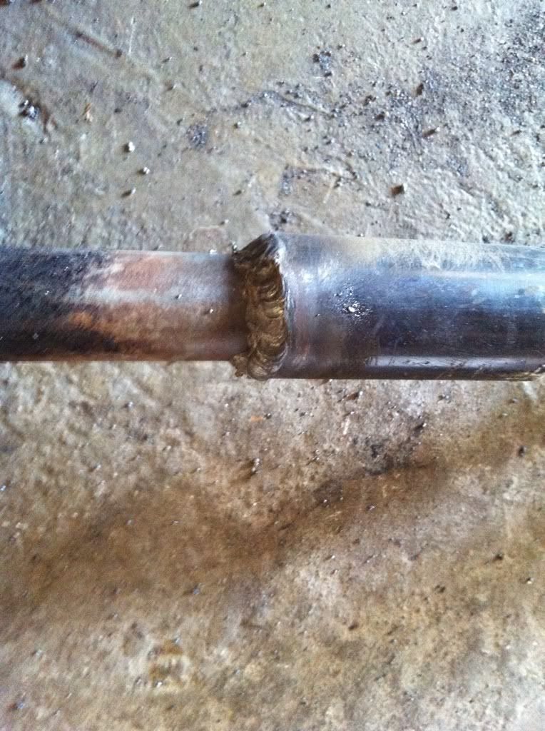

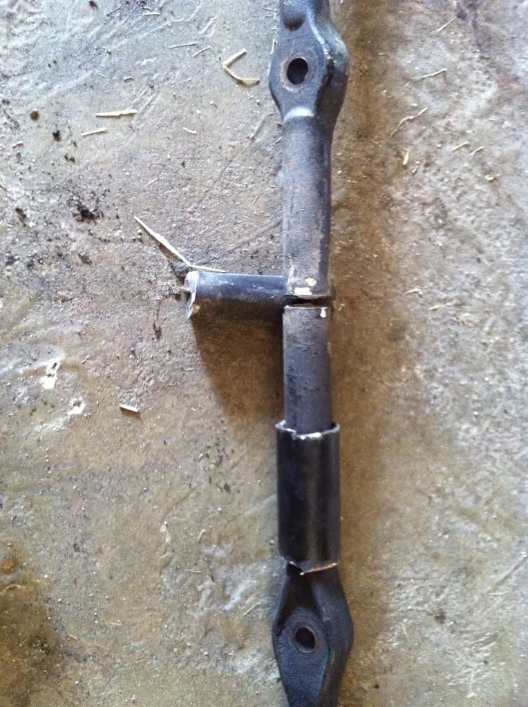

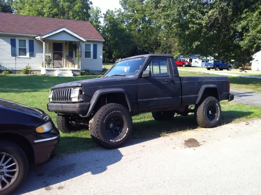

so after finding out that wj drag links are the same length and wouldn't work for this application i decided to yet again get the grinder out. chopped the drag link in half and took about 3" out of it.
i used the old peice from the wj tie rod to sleeve it with. slid it on there then welded up the center of the drag link. then slid the piece of tubing over and welded it.
then i noticed that the nut on the drag link was hitting the tractor pins i used for disconnects.
i grabbed the grinder and gave it a little buzz and now the knuckle goes all the way over to the stop.
i still have to grab a new end to go on the drag link since the ball joint is bad and some brake lines. but here she is parked out on the street so i could pick up my mess in the driveway
