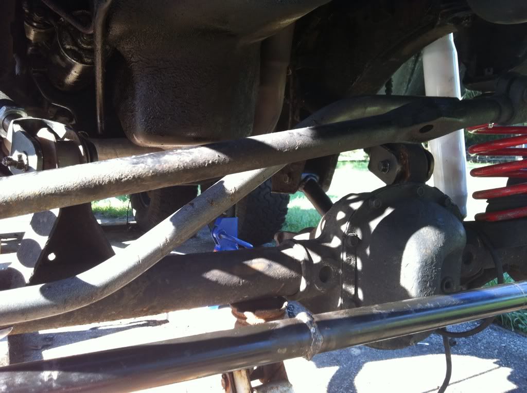

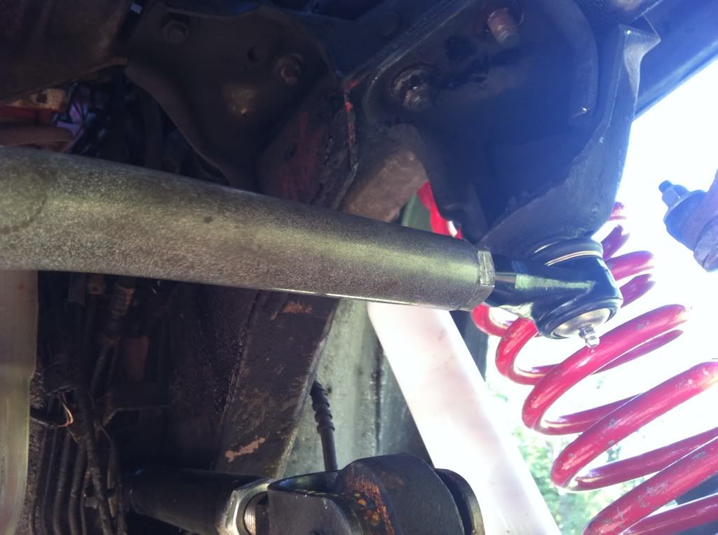

Your not worried about how weak you just made your tie rod? That weld will be the breaking point if anything hits that or even a hard enough bump. Gotta do what you gotta do though.... Nice work on the mj! Keep it up.

Those welds. Oh god.
No penetration on the tubes with those spring perches. Cutting a tie-rod and butting them back up and welding? LOL

I also agree.
It looks rather unsafe.

i actually wanted to sleeve the tie rod but didn't have anything readily available to do it with and this truck will NEVER be wheeled so i'm not concerned with bending or breaking it. ppl here can think what they want about cutting and welding it but i know for a fact that it's stronger than the pissy *** stock mj/xj tie rods.

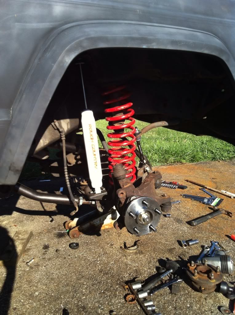

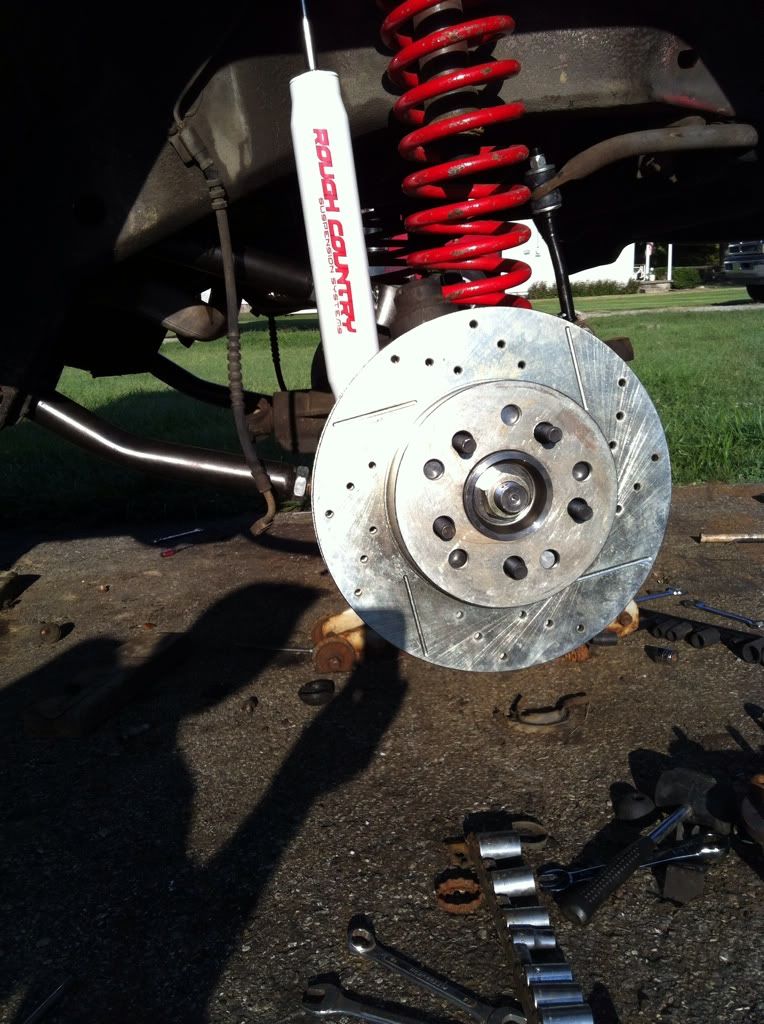

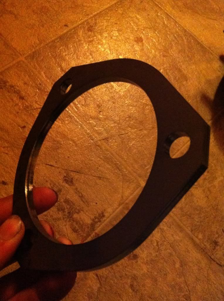

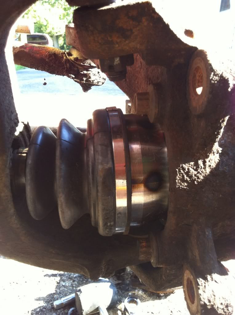

well i finally got the jks flange spacers i've been waiting on.
spacers in place with the cv's and hubs installed
and here's 2 pics of the three 12 point bolts that hold the hubs on
looking a little closer to a truck again
and here's some pics of the track bar on with a new end i bought this morning
planning on drilling the rotors tomorrow and getting the brakes put on

Not going to be wheeled? Great, I couldn't care less what you do at slow speed on private property. The fact that it's going to see public roads is the issue.

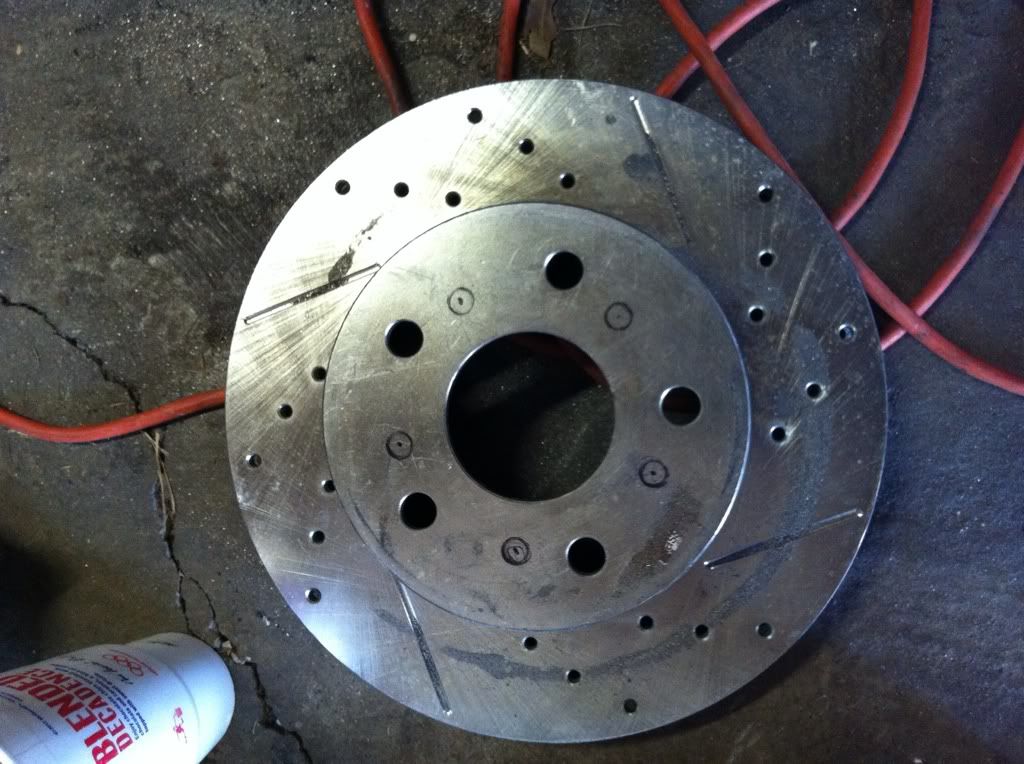

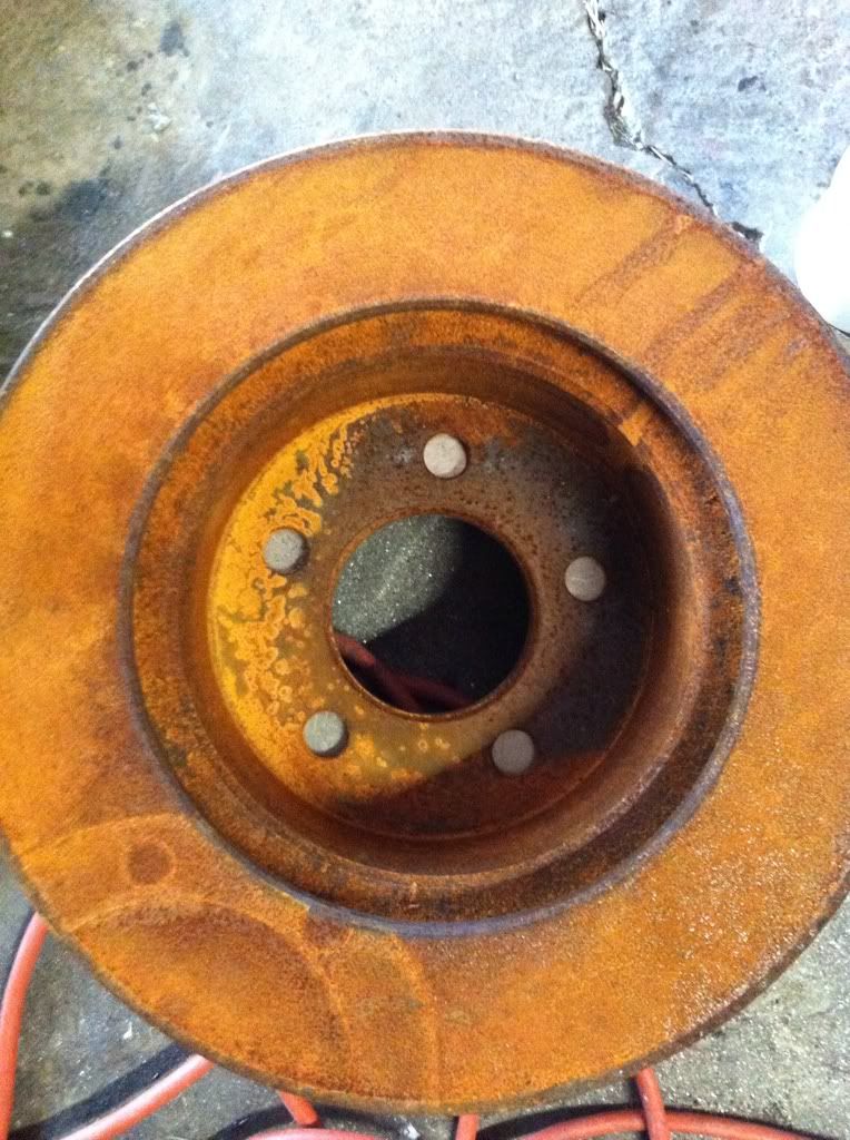

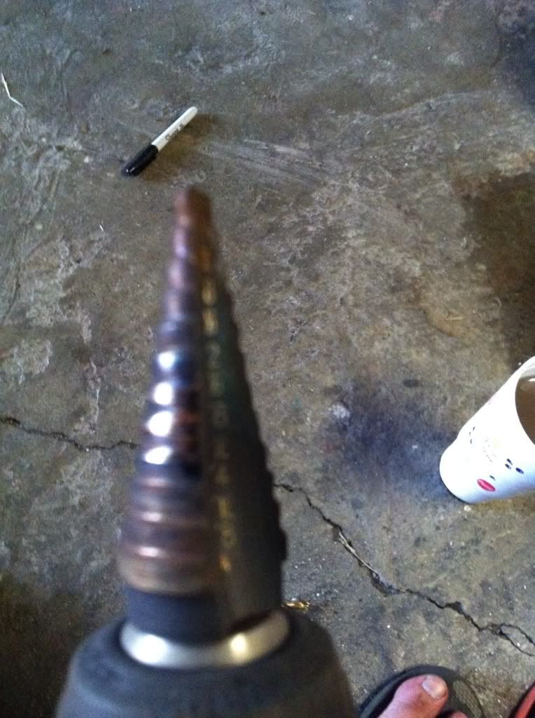

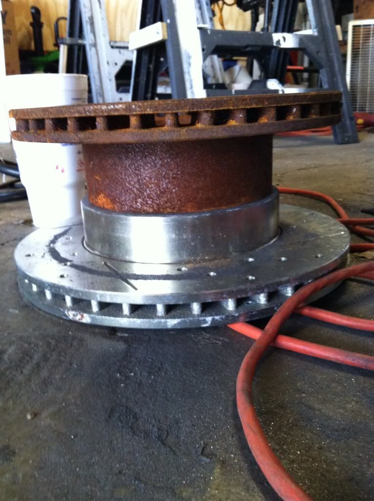

Today I drilled out my rotors. I started by lining up my old rotor on top of the new one and tracing out the bolt pattern with a sharpie marker.
Then I used a small punch and hammer to put a little divot in the center of my marks. Then used a decent size drill bit to get a hole started and finally moved up to the step bit to finish it off. Spent a few hours with my drill and this bit today, and I can honestly say I don't want to have to pick up a another drill again for a while.
And here's the end result. I think it looks pretty sexy on there
