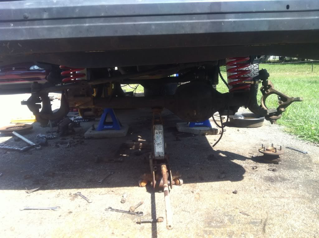

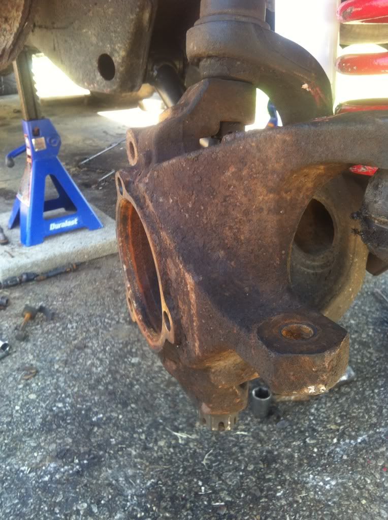

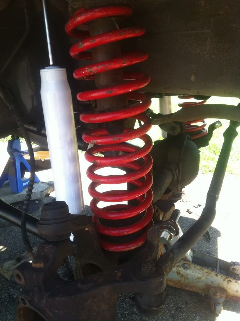

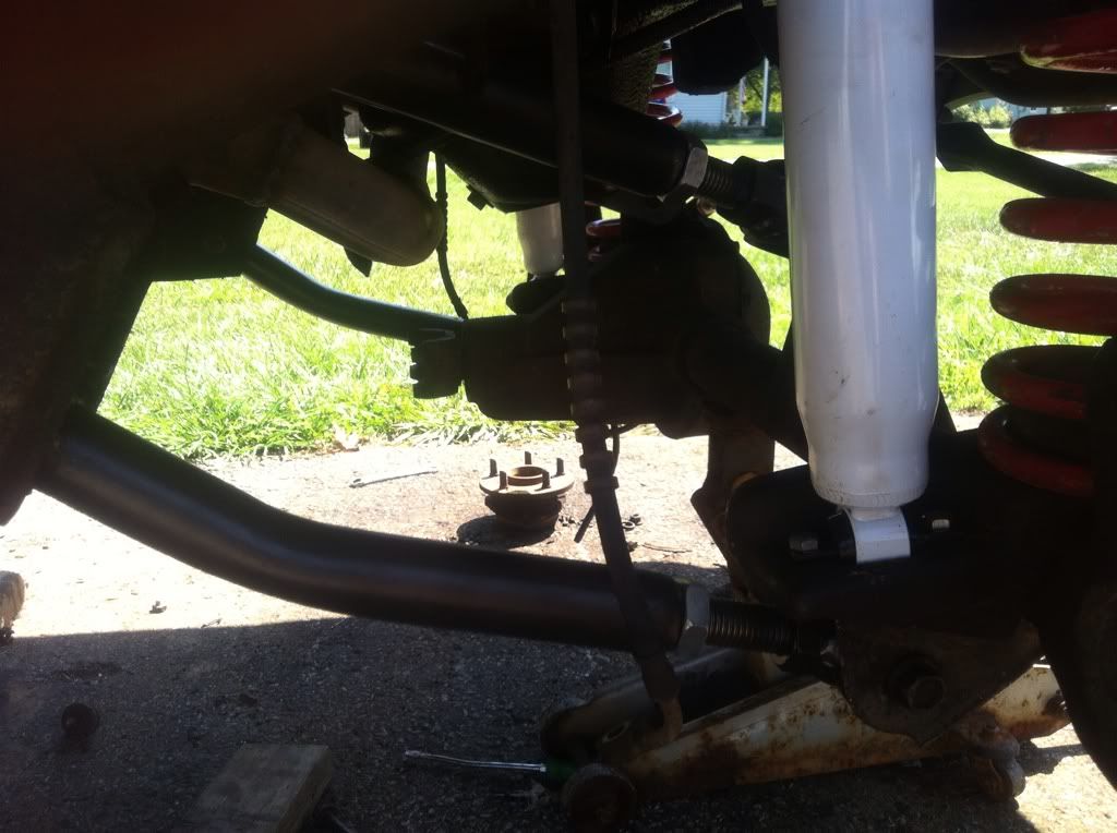

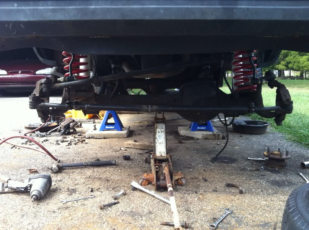

got some progress done on the mj
got the control arms on, upper control arm bushings in the axle, axle in truck, shocks on, wj knuckles on, coils in, and some other stuff.
still waiting on my sway bar links to come in(even though i'm not sure if they're gonna work)and some jks spacers for the knuckles.
pics...

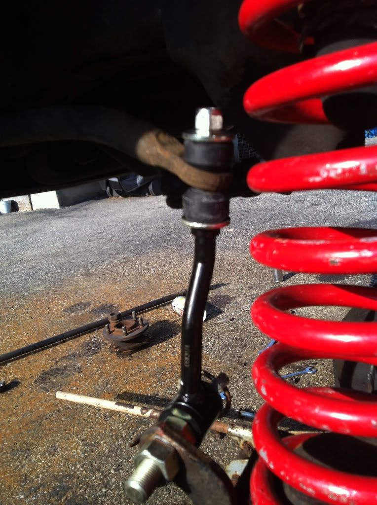

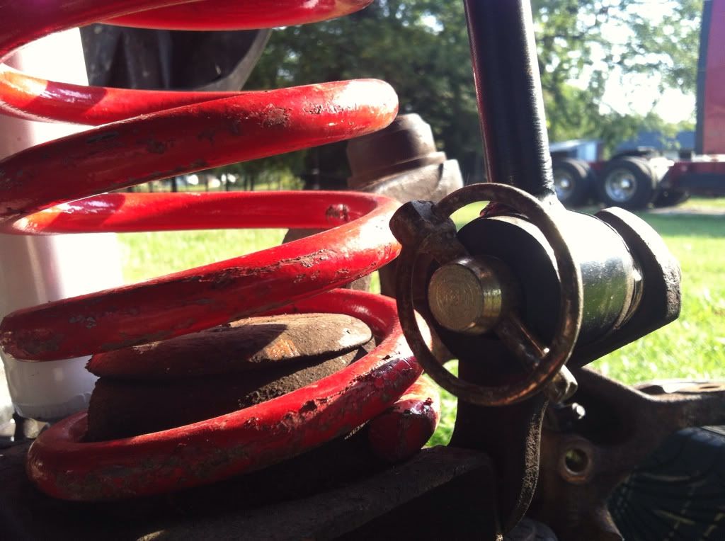

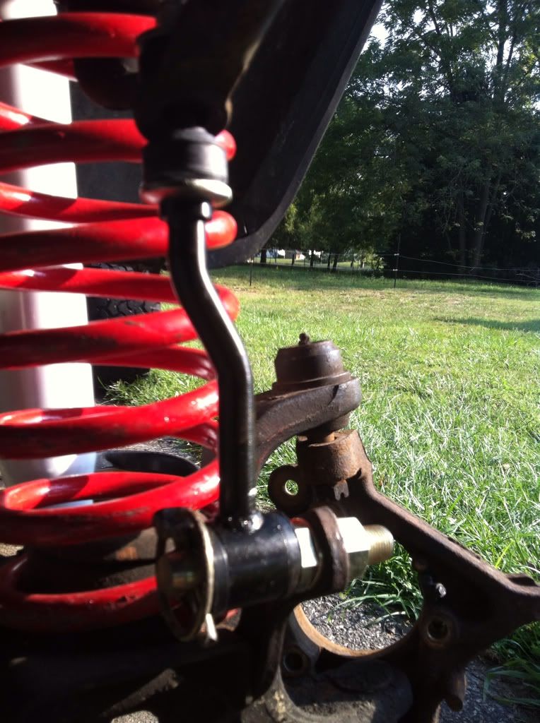

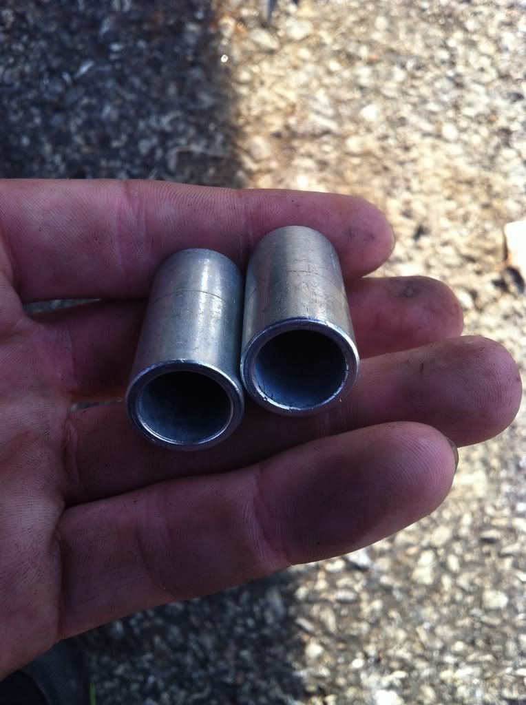

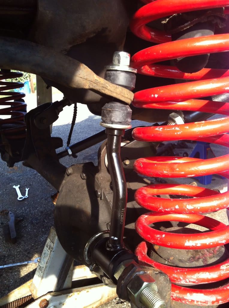

ok so my sway bar links came in the mail yesterday. first thing i did was remove the bushing sleeves from the lower bushings.
then i test fitted them. and they fit perfect on the tractor pins. popped the clips on there and now i've got quick disco's should i ever need them. and for only about $26.

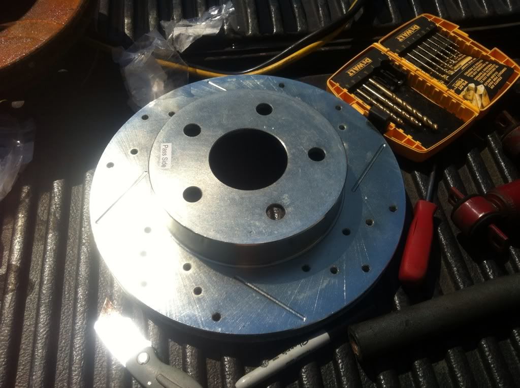

oh and i forgot, my wj drilled/slotted rotors and pads got here. rotors look sweeeet! now i just have to drill the 5x4.5 pattern in them.

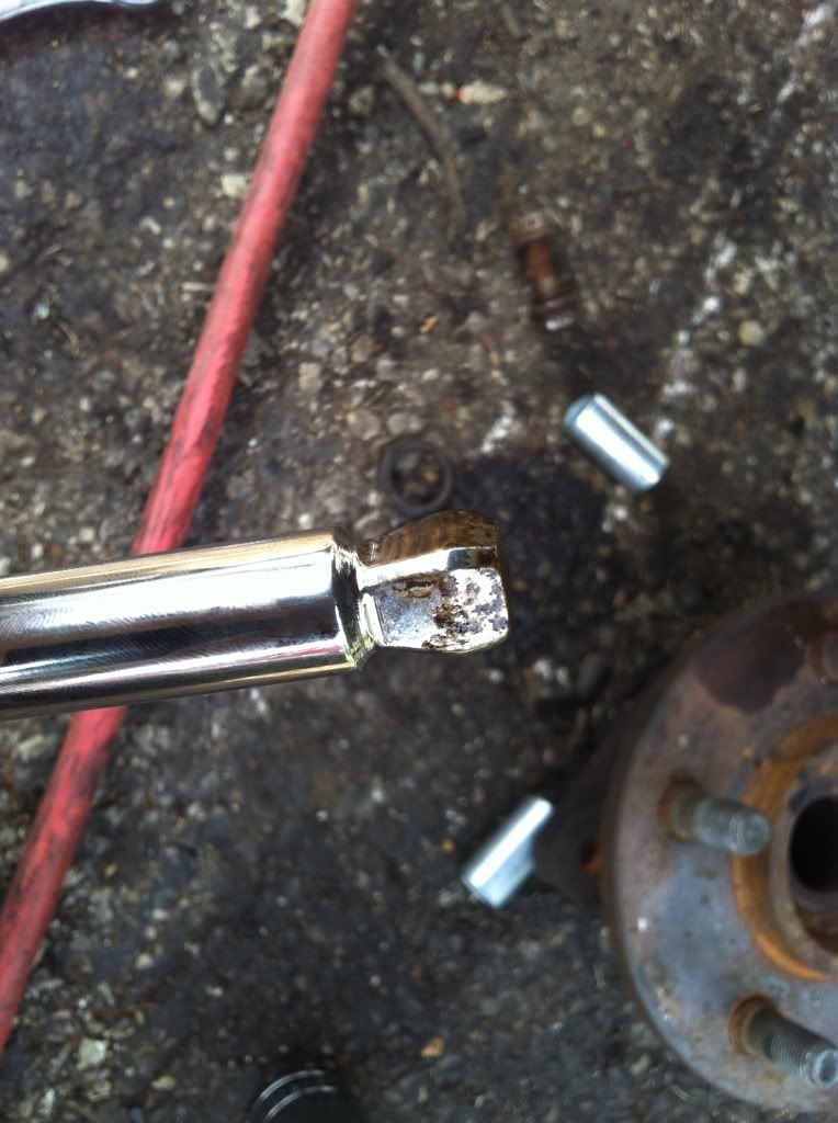

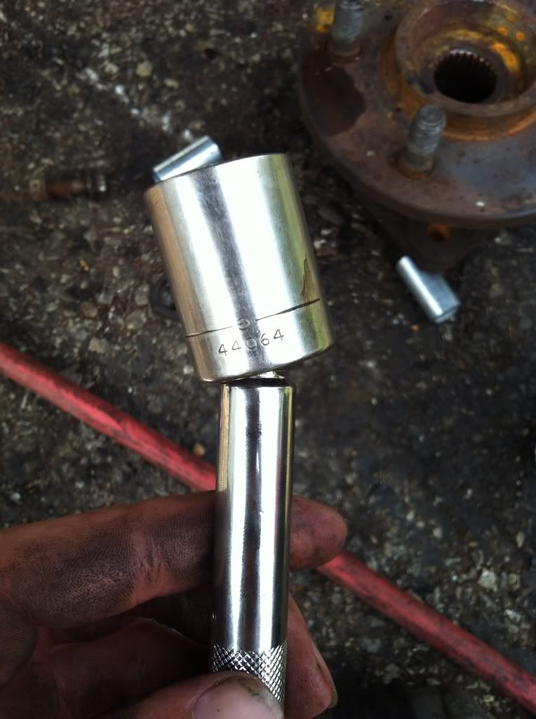

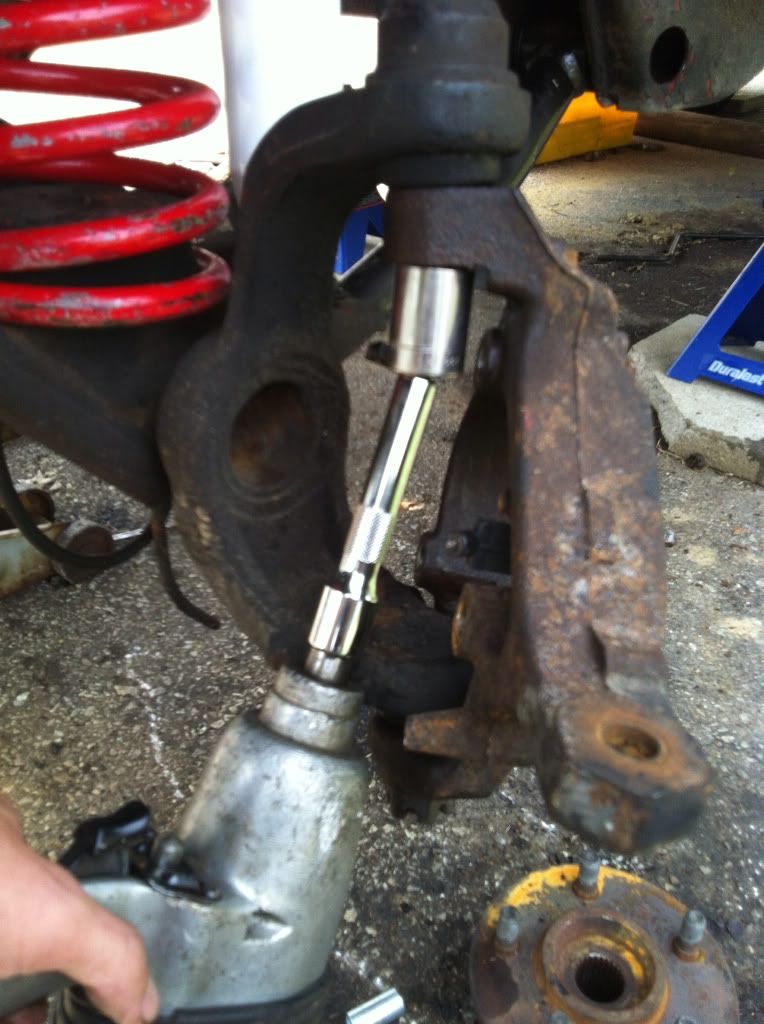

tightened down the wj knuckles, and i picked up a set of these wobble extensions from harbor freight for about $10 and this sucker worked awesome for the upper ball joint nut.

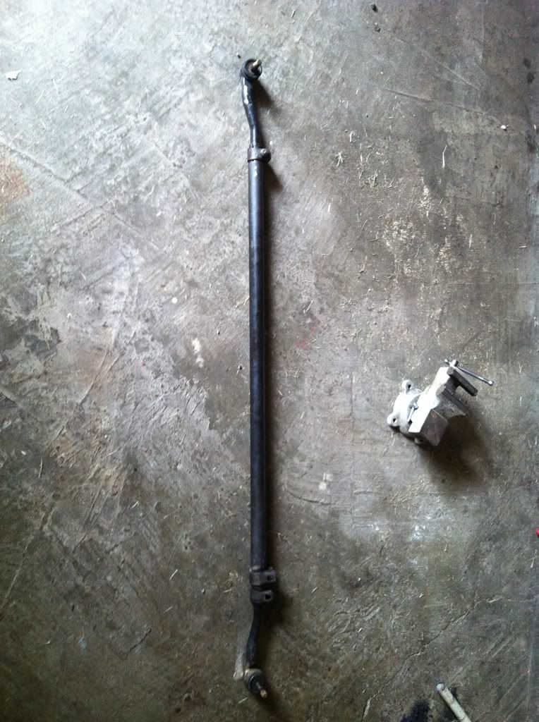

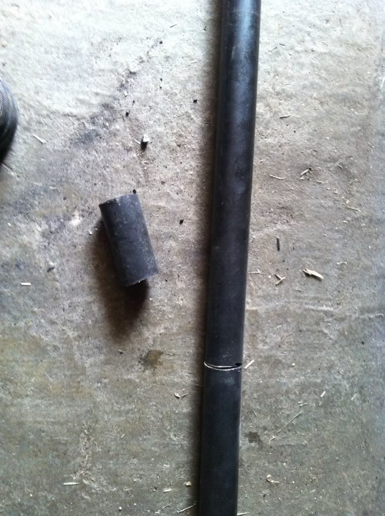

i also decided to go with the crossover steering setup the wj knuckles use. picked up this wj tie rod but of course it's much to wide for a xj or even a zj setup. even adjusting the ends all the way in, it was still to wide.
so my first instinct was to try some shorter ends off another vehicle. i went to o'reillys, auto zone, and advance to try and cross reference something but none of them were any help due to out of stock parts or just pure ignorance. so i returned home a little discouraged and then even to realize that had i found shorter ends that it still wouldn't have worked due to the bends in the wj ends. without these bends the tie rod will hit the diff cover when the steering wheel is turned all the way.
so after a few seconds of looking at it and pondering i then of course came to my senses and cut the damn thing in half and cut about 3" out of it.
threw some of my not so great looking welds on there.
and ta-da! this would also be a pretty great upgrade for anyone wanting to beef up there tie rod since these wj tie rods are alot beefier than the cheesy xj/mj/zj stockers.
so this is for the ****** at auto zone that told me it would never work.
