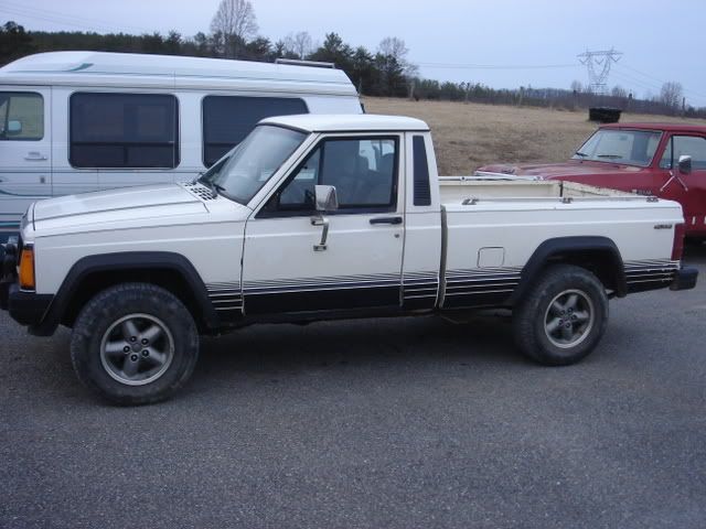

Heres my MJ
Year: 1987
Lift height (listed & actual): Stock, No lift
Shocks: (brand or part # or what height lift they are made for) Rancho
Tire size (Listed & actual): 30" Firestone Destination A/T
Wheel Size & backspacing: Stock 15x7 turbine wheels
Notes: Just finish the body work and all ready to be painted

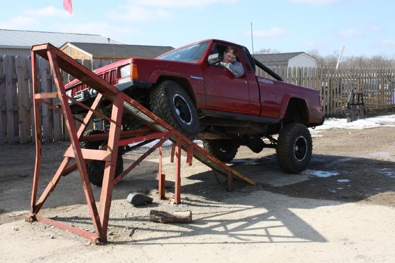

'87 (or was it '88?) shortbox with home brewed lift. SOA rear (still D35 with 3.73 gears and the level sensor has been bypassed) with 255/85/16 tires (ZJ rims with the equivalent of 33/10.50/16s)) Rear is from an XJ and the shocks are "Mickey moused" in place because the axle wasn't planned to be long term. I swapped in a 4.10 geared rear and LOST power and speed (Renix makes it's power at lower RPM and this was originally a 3.07 geared rig)
I ran 33/9.50/15s which seemed just perfect for it, but I couldn't afford to buy a set last year, so I put a set of 31/9.50/15 BFGs on ($800 vs $500 mounted and balanced)
Front is 6" TJ springs (netted about 5" of real lift) with curved lower arms (not WJ ones unfortunately, or the 33/10.50s wouldn't have hit the arms on tight corners. Not sure of the brand) extended brake hoses and Rough Country adjustable trac bar with tie rod ends.
That's all I remember of the lift other than extenders for the front shocks. I have spring plates for the rear to go with the Model 20 I was going to put in.

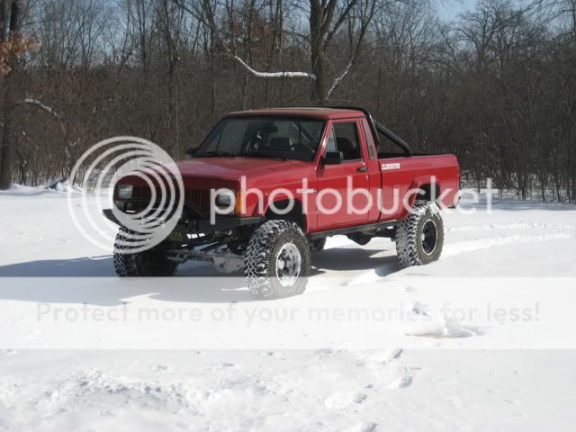

Year:1989
Lift height (listed & actual): 6.5" coils measured about the same/SOA rear with 2wd leafs and 1" lift shackles measured to about 6"
Shocks: front 12" stroke Bilstein 5150s rear 11" stroke Superlift hydros
Tire size (Listed & actual): 33x10.5x15 BFG KM1. new they measure a shade over 33"
Wheel Size & backspacing: 15x8, 3.75 bs
Notes: minimal trimming to front of front flares. minor trimming to rear flares. extended front and rear bumpstops. homebuilt longarm 4-link with limit straps. SYE
