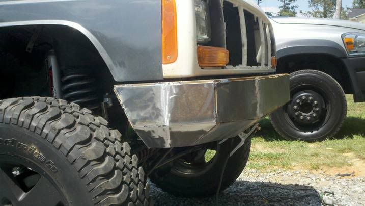

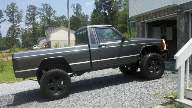

Update!!
Comanche is up and running and drivable ready for the road. 2001 interior installed and custom tail lights have been made. Need to charge the a/c and probably goin to sell it to build another TJ. Who knows.
Oh yeah built a front bumper for it as well
