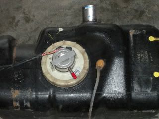

Got myself a Dakota fuel tank and the Cherokee fuel system fit in it. Goin to get it mounted maybe today

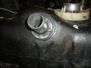

i have the fuel system figured out, Dakota fuel tank, Cherokee fuel system, my own filler neck. I plan on mounting today and will post more pics when i do!

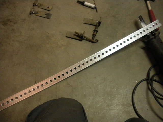

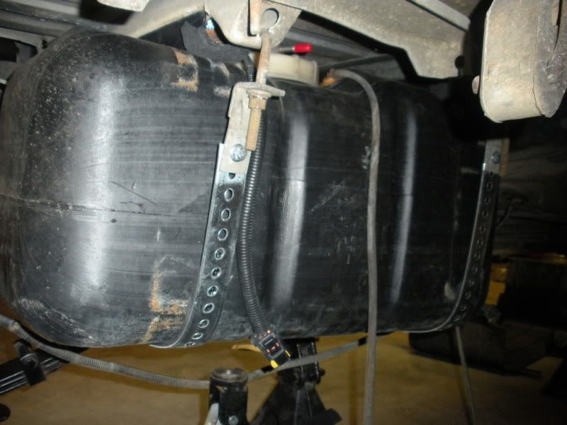

Mounted dakota tank in MJ, had to space it down a 1 1/2" to clear fuel regulator. Used a old t case drop i had laying around. Went to Lowes and bought 6ft of this strapping material and made longer straps to hold tank up. Goin to see about having a new skid plate built to protect the tank.
