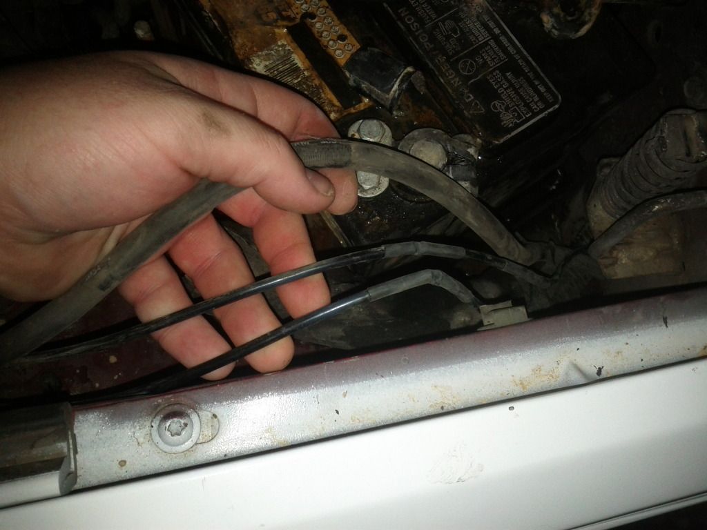

I broke a couple of vacuum lines.
So uh, I don't know what they do, where they go or why they're so brittle, but they went all PSSSSSHT when I broke them.
They run alongside the passenger fender, near the battery. I was fishing around for a dropped socket when I snapped them.
I did a quick fix with heat shrink tubing, although I don't know if it'll hold.
I have no idea what they're to or where they go. One end disappears into a hole in the front near the headlight, the other end disappears into a hole in the firewall.
See attached:

Those run to the vacuum ball located behind the front bumper on the passenger side. I usually relocate the ball to under the coolant bottle, eliminating the hose mess by the battery. Standard vacuum line available at parts stores will work fine.

Ok cool. My slapdash fix seems to have worked.
