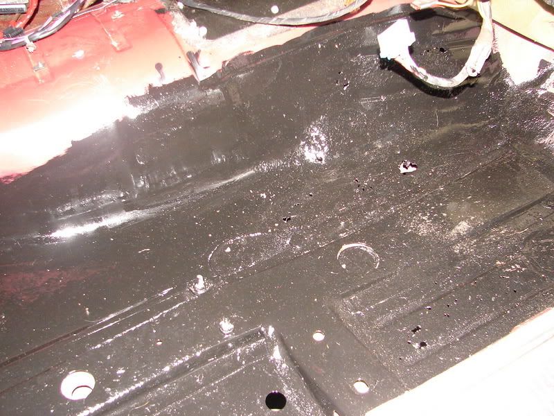

post #8 of 18 Old 11-11-2007, 05:31 PM Thread Starter
jeepcomanche88
jeepcomanche88's Avatar
Join Date: Sep 2005
Location: Mount Pleasant
Posts: 342
on the passanger side i had already put down some por 15
and heres the drivers side

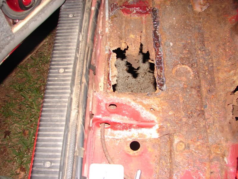

While we are on this subject.... I am attempting to replace my floor boards which are not too bad, but too thin to play with. I am in the process of (after buying the replacement floor boards), trying to remove the (upper) frame brace. It is now, after drilling out many spot welds, flapping in the breeze....EXCEPT.. the rear two inches of it!!! I can not find out where it is being held on, but this must be a "Jeep" thing.
This delemma backs up my thoughts as far as how well Jeeps are made, but it makes me mad when I can't even take it apart. I will try to post a pic of where I am talking about, but I sure would like to get this baby out in one piece since it is still in good shape. HELP!

post #10 of 18 Old 11-04-2011, 10:51 AM
dkroll
1988 MJ Comanche
Location: Independence
Posts: 194
Okay, here is a picure of where it will not give.
This is a shot from the pass side door looking at the rear part of the brace.
.........By the way, does anyone make this piece anymore? I have searched everywhere and can not find this "upper brace".!!!! A guy could make a mint making these if not!

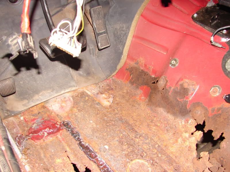

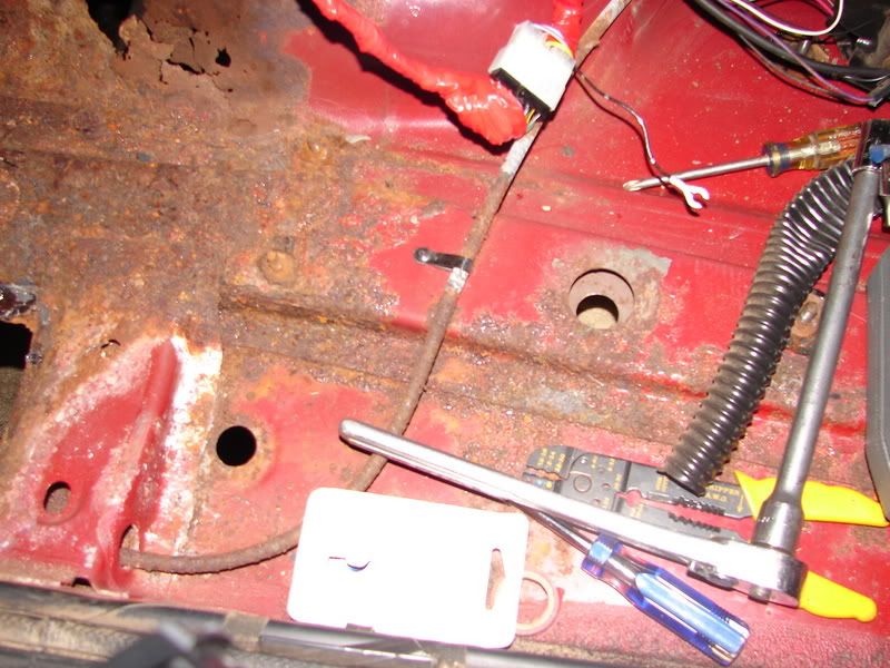

my MJ has the same problem. getting that upper brace off is a pain. lots of spot welds to drill. i cant find the replacement brace. about 1/3 of mine isnt usable. i could make it work but id feel better just getting new ones. i was wondering how important is that brace? can i just use the floor pan without the brace? i want to mount XJ seats so the mounting brackets are different. if i didnt use that brace that sure would be easier. but it would be about 180 bucks to get the front and rear pans on both sides. if im gonna do it i want to do it right.
