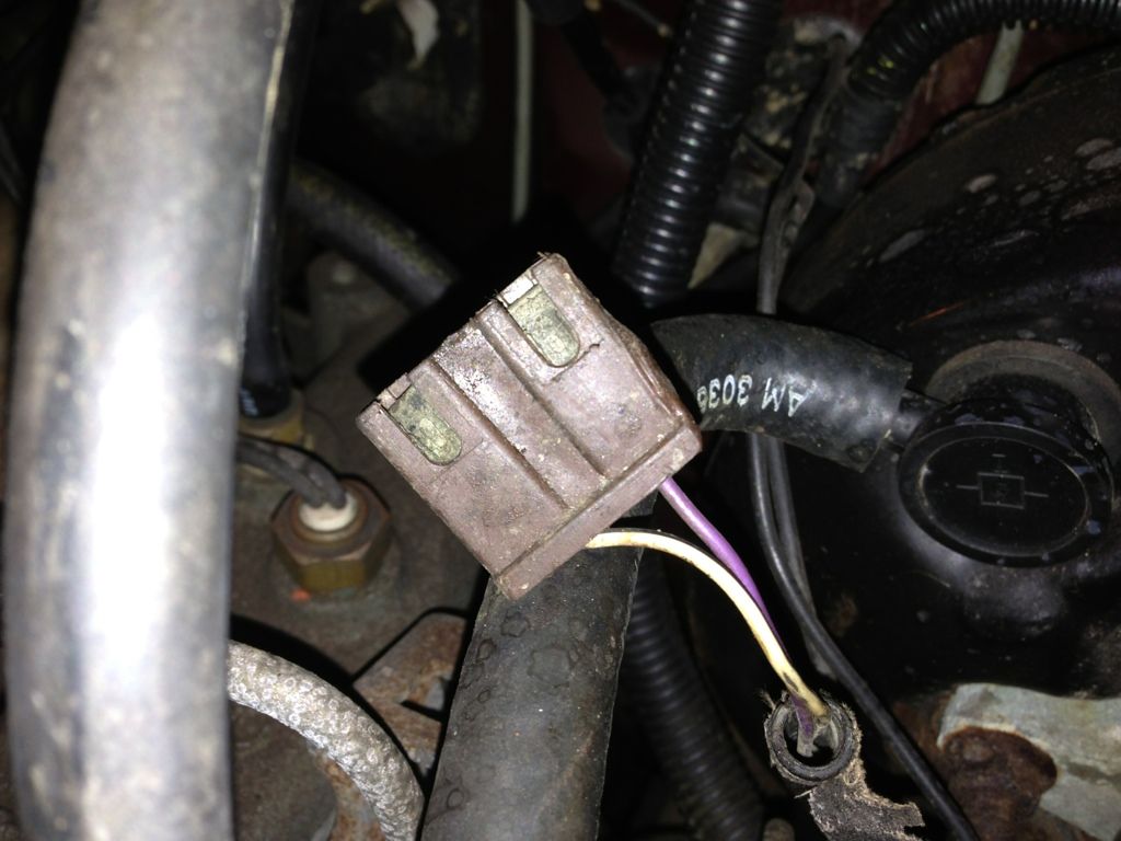

This one is hanging out by the master for the brakes:
Any idea? Engine speed sensor?
The wires are violet with white and white with black.
Thanks!
Joey

Washer bottle fluid level

Yup, if equipped that way......

Eay cruiser, if your harness has said plug why would it not work if you plugged it up? Cause my pump took a crap and my new resiviour has the connector on top, when i plugged it in nothing lit up on the dash. Yes the bottle was empty. Missing the bulb maybe?

Or the sender in the tank is crappola.....

Oh well, its not to big a deal.

Check it with a meter. I've removed those senders and screwed with tehm and got them to work before.
