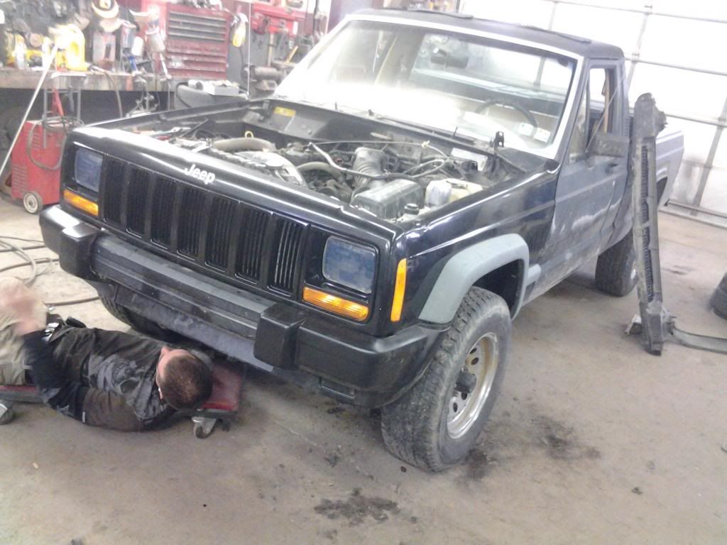

Here it is with the headlight panel. Some people splice the wire harness so the old plug fits the new harness, but i found that its much easier to just use the old harness. Youll have one empty socket in your marker light but still have all your functions. Plus no aggrevation of splicing wires and adding an extra light to the harness. [IMG][/IMG]

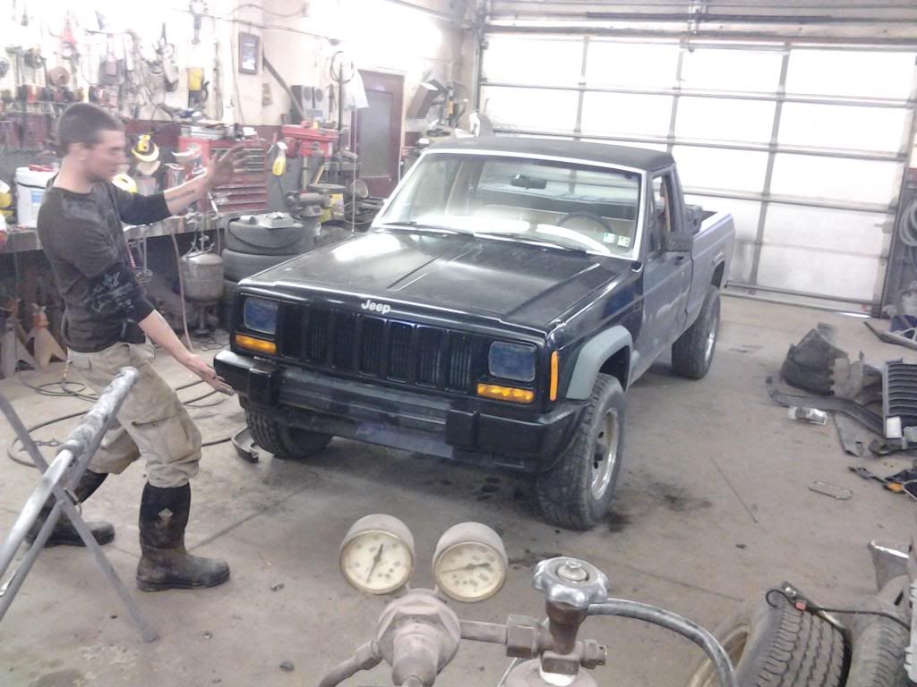

And heres Tj presenting the finished product ( I just converted him to a 93 XJ 5spd 2dr). He now wants to do the front clip swap on his XJ. [IMG][/IMG]

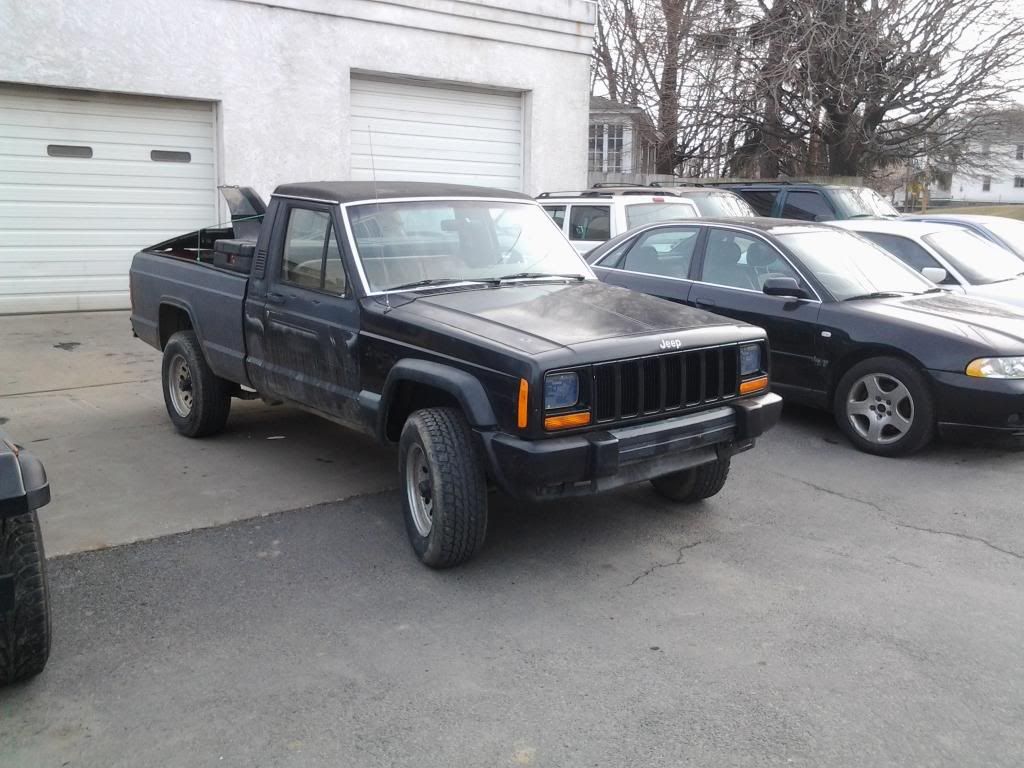

And here she is back out in the daylight, loaded up with all the old parts ready to make a scrap run. All of this was done from start to finish in less than 4 hours. Now just gotta make time to do some body work t the rest of the truck and get some fresh paint. Also updating the interior with new dash, door panels, seats and the whole shebang. But thats gonna be a while before I have time to get any of that started. [IMG][/IMG]
