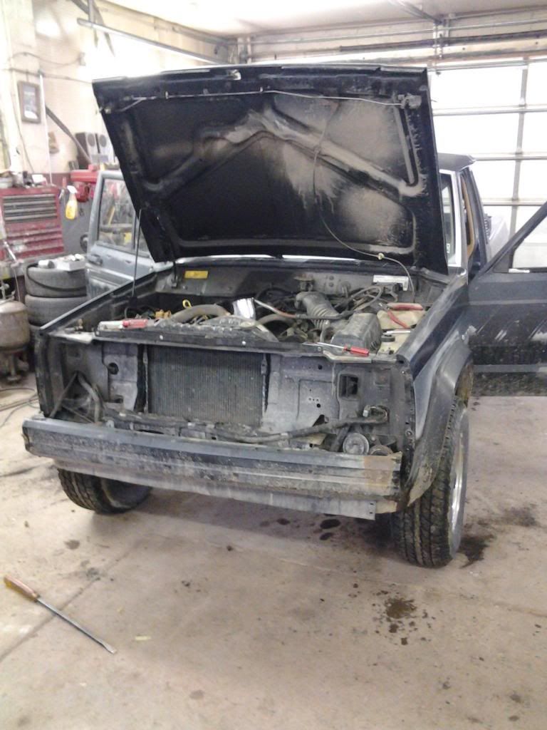

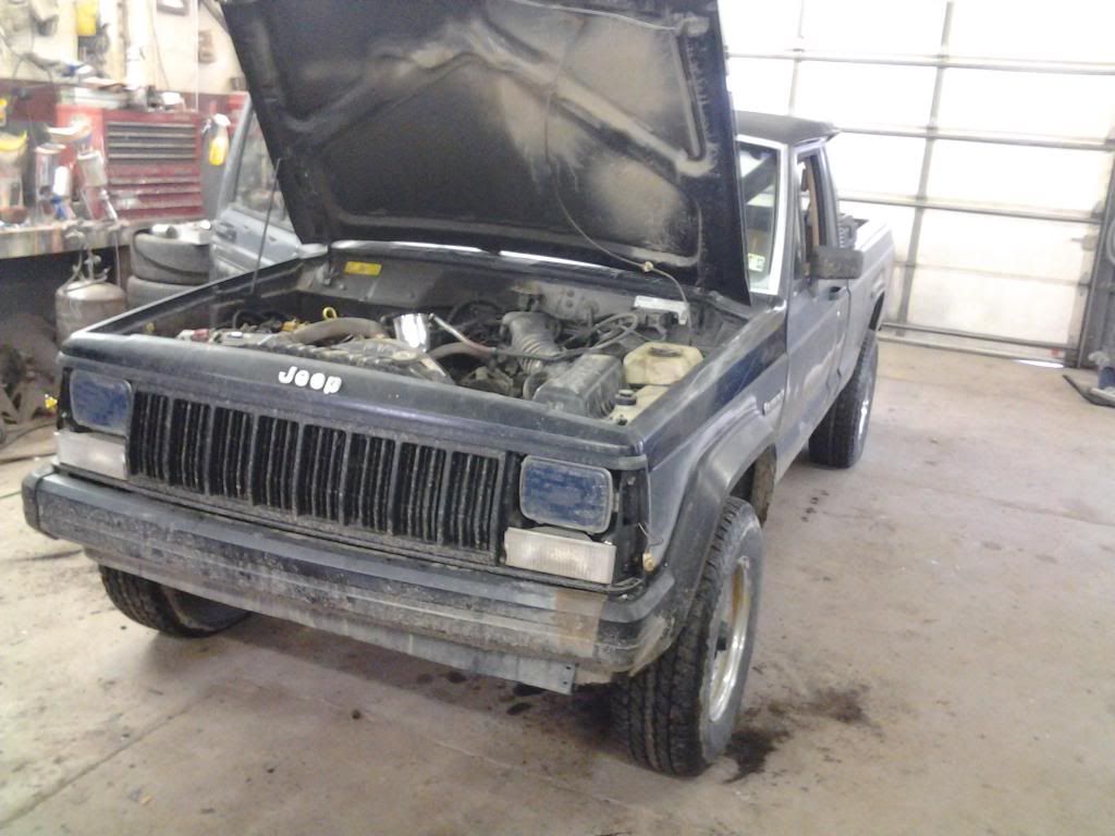

I call him carl this is what I'm starting with.
ForumRunner_20130308_172209.jpg   ForumRunner_20130308_172215.jpg   ForumRunner_20130308_172223.jpg   ForumRunner_20130308_172237.jpg

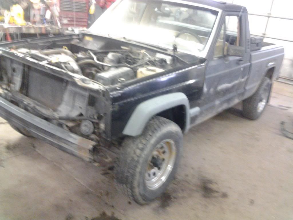

Ok so I finally did the swap today. Got all my parts together and just went for it. And I gotta say, it went pretty smooth for the most part. Heres what it looked like before I started [IMG][/IMG]

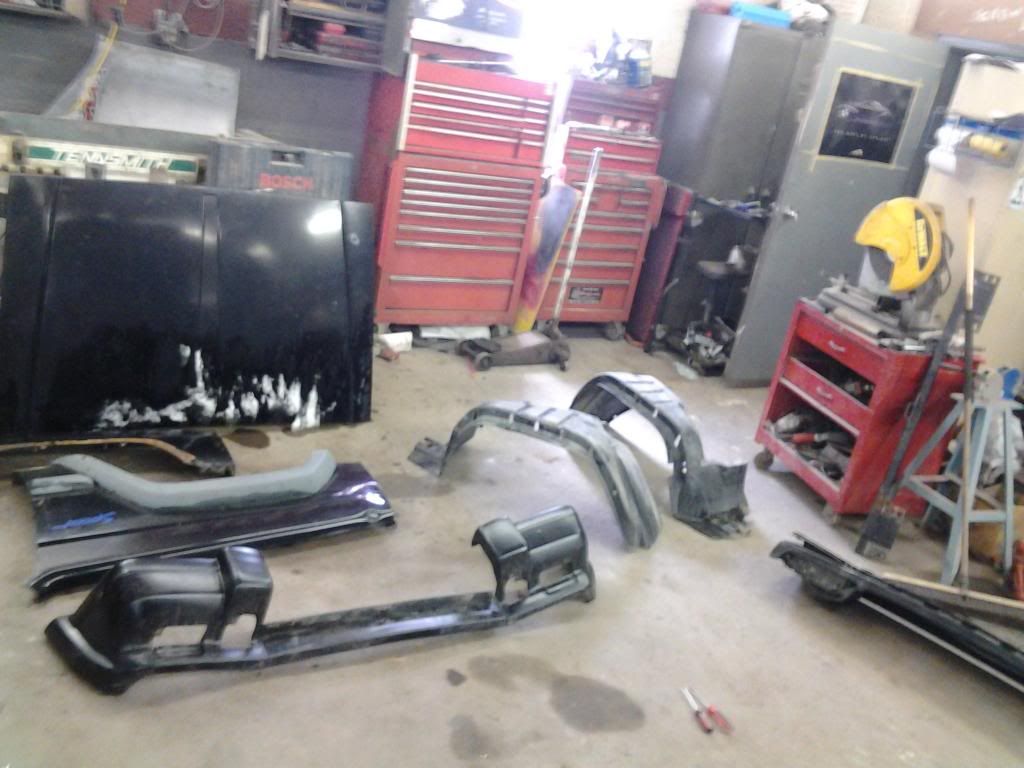

And heres my pile of parts For the swap. Its hard to see but the headlight mounting panel is on the right side. [IMG][/IMG]

So after looking over everything and making sure i had everything I'd need i ripped in to it and went right through the steps. [IMG][/IMG]

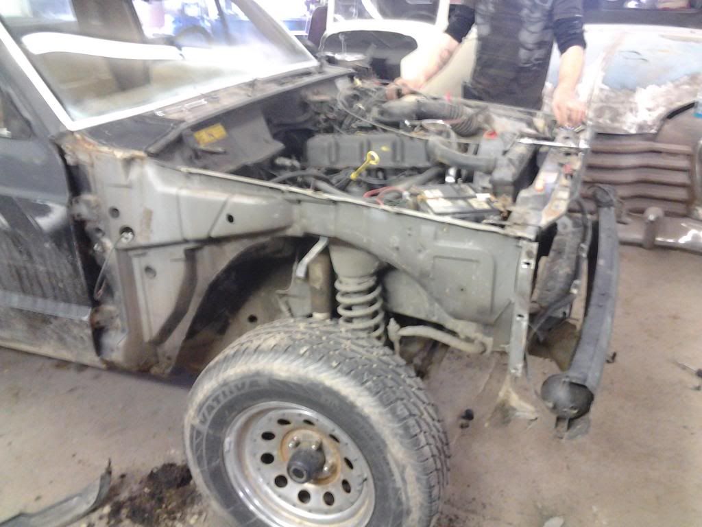

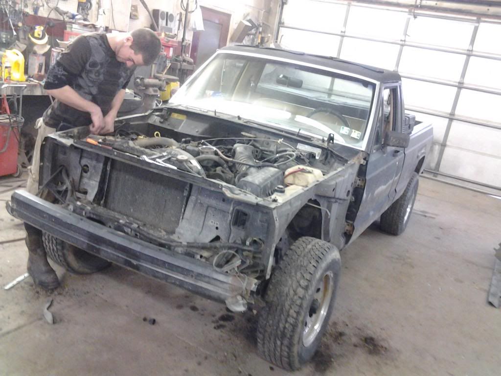

Before long i was ready for installation. Thanks to a buddy of mine we stripped it down pretty quick. Thats him in the second pic. [IMG][/IMG] [IMG][/IMG]

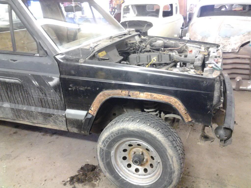

At this point I was surprised it was so clean and rust free underneath. But I figured While i had it apart it would be a good idea to clean the apron around the wheel well and undercoat it to prevent any future rust. I didnt take pics of that but you get the idea. From there It was Quick work putting it back together. Fenders went like clock work. [IMG][/IMG] [IMG][/IMG]

When Putting the fenders on I realized that where the old ones had 3 bolts going down the front, the new fenders dont even touch to put bolts in. Now if your checking out this thread and thinking about doing this swap yourself, dont fret. When you put the headlight mount panel on it will secure the front of the fenders more than enough to compensate for the 3 bolts that you wont be able to put in.
