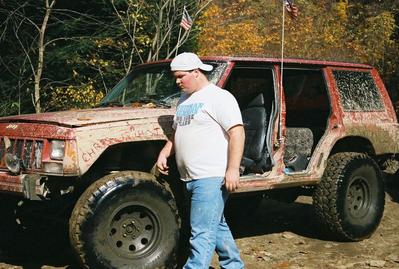

This guy has 9" lift and even with 35's they look like they almost don't fit:
Of course, that might just be me. But with a 9" lift AND trimming, you might be able to squeeze on 37's, or they might fit with ease

Hey, i'm the guy with 9" and 35's... If i wanted to run 37's it would be possible for street driving, but there is no way it would work well for the trail... However, enough cutting and you can fit anything.
In the 2nd pic posted, if you look close you can tell i have cut my flares and raised them about 3 inches( look at the fender lines), along with stretching them a little front to rear to increase possible wheel travel.
