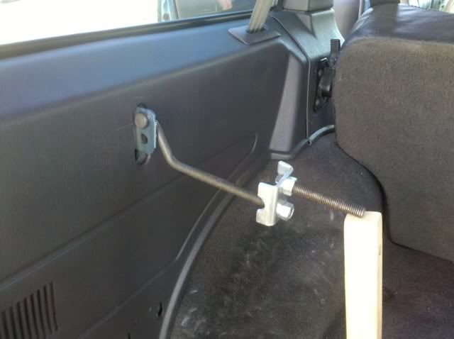

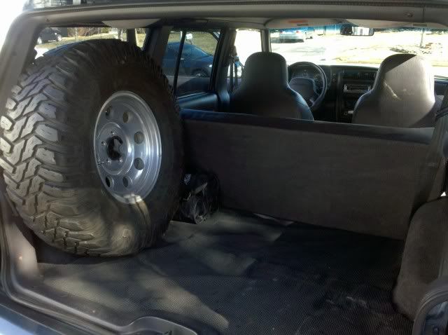

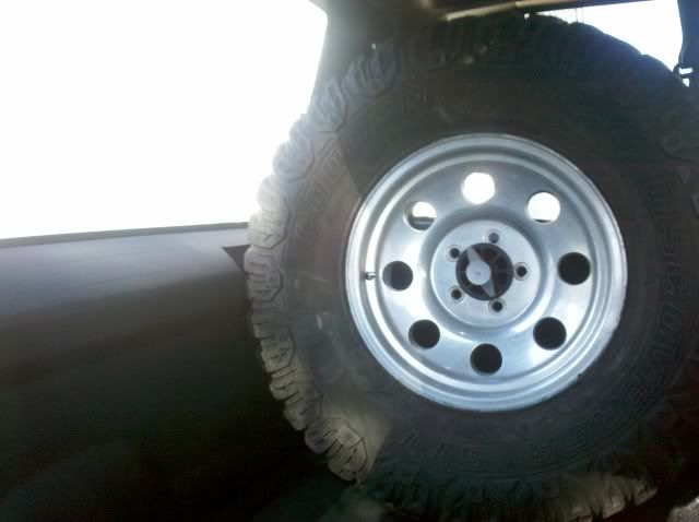

Here's one I did. For those who have a full size spare up to 32 inches and don't have the $$ yet for a tire carrier or roof rack, you can mount it inside in the stock location for only a few bucks. I had a set of old spring compressor clamps from my old cars when I was in to lowering stuff. Just double nutted them on to the original rod that holds the spare. Trimmed the plastic on the tailgate and it's good. It doesn't rattle either because it rests on the back part of the back seat. And you don't loose that much cargo room.

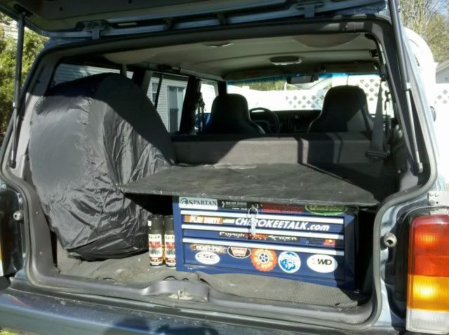

Eventually got a tire cover and changed out the tool box and now have a small work area when needed. Which is just about every damn week. LOL!
