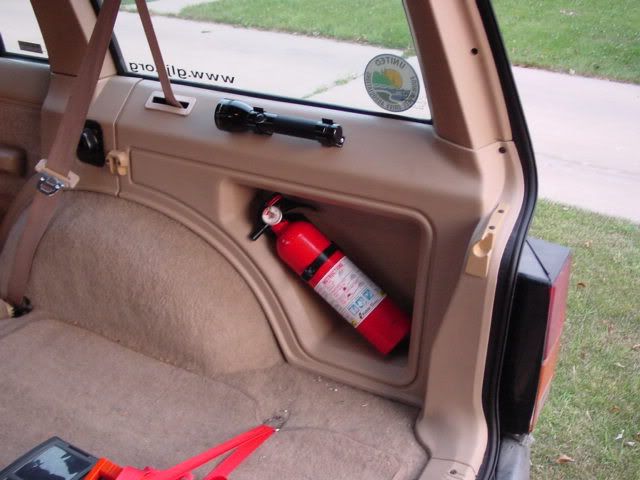

Fire Extinguisher
First, an article on the why and how of using an extinguisher in a trail vehicle.
And a thread on fire experiences/tips.
Small extinguishers are cheap ($10) & will come with a mounting bracket. You have to decide where to place it though.
Other parts/supplies: 1 screw, 1 nut (no larger than #10 x 1/2"--I bought a $0.99 packet of [8] #10-32 x 1/2" screws & nuts f/Home Depot), and a screwdriver. If you are not mounting it where I did, you'll want beefier screws, but the bracket on my extinguisher wouldn't have taken anything larger than a #10 anyway.
Generally speaking, you want to be able to get to the extinguisher quickly (obviously), so take that into consideration when you're looking for places to mount it. But you also have to mount it securely--the bracket that comes with it won't keep it in place if you get into a car accident!!... unless you mount it under a seat, in which case you might get away with just using the bracket, though a zip tie around the bottom of the extinguisher wouldn't hurt (bracket usually holds the extinguisher from the top, but not from the bottom--when you need it, yank it from the top & it will slip out of the zip tie at the bottom).
The most popular location is under the left side of the driver's seat--easy to get to quickly, & tucked out of the way. Courtesy of BlueGerbil: http://www.jeepforum.com/forum/969265-post4.html
I couldn't do this b/c of my leather seats (they're shaped differently than the cloth seats--no room under there). I didn't want it in the cargo area, lest it break loose & smash some thing or person. So, I put it under the rear seat, which, handily, has a cross brace with mounting holes already available. This is under the rear seat, driver's side (the tire jack takes up room on the passenger side) & you can see the holes in the cross brace, which I used to mount the extinguisher:
Here it is installed (the thing on top is my WalMart 0/2-guage jumper cables, so you can see there's room for more):
Other locations:
2WD '96 XJ Country 4.0 auto -- 134,000 miles
and... see my photography
xj-xile is offline   Reply With Quote
Old 08-24-2005, 10:00 AM   #5
creature
Join Date: Jan 2005
Location: Morgantown WV
Posts: 2,769
heres my infamous ping pong paddle CB mount, notice you can't see the ping pong paddle* because it was tucked away above the headliner
so it goes
Ping Pong Paddle
Headliner
CB Radio
*You can use almost anything instead of a ping pong paddle, plywood would probally also work fantasticly aslong as it can spread the weight of the CB across the headliner
And bedlined rear bumper No More Scratches!
-Shawn
creature is offline   Reply With Quote
Old 09-01-2005, 03:05 PM   #6
JIMBOJAMES
Join Date: Mar 2004
Location: Shawano WI
Posts: 861
Nice I think I am going to mount my mag light in the back. I like that idea.
[COLOR="Black"]96 Cheorkee Sport - 6.5" Lift, with 33X12.50 BFG MT's, big bumpers [/COLOR]
JIMBOJAMES is offline   Reply With Quote
Old 09-04-2005, 02:39 AM   #7
NEWtoTHEjeepLIF
Join Date: Jul 2005
Location: Chicago
Posts: 1,349
Talk about a projectile (sp).....That mag light it not that secured and sitting heavy side forward... if you get in a front in collison that will be a 3D missle instead of a 3D Mag......
JMHO Good Luck Happy Jeepin!
NEWtoTHEjeepLIF is offline   Reply With Quote
Old 09-07-2005, 12:51 PM   #8
xj-xile
Join Date: Apr 2004
Location: Wooster, OH
Posts: 939
Yeah, I'd have to say I wouldn't personally mount it in the back (unless you box it up or put it behind the spare tire, or something so it won't get loose in an accident...).
