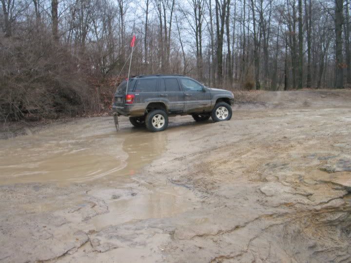

post #7 of 37 Old 11-16-2010, 08:48 PM Thread Starter
iluvtruenos
Join Date: Dec 2006
Location: Chicago
Posts: 1,345
This is 6.5" in the back, it was taken about a month after the swap.
Teraflex 4.5" in the front. The front has about two months on it. Neither front nor rear have settled, and both now have 20k on them.
