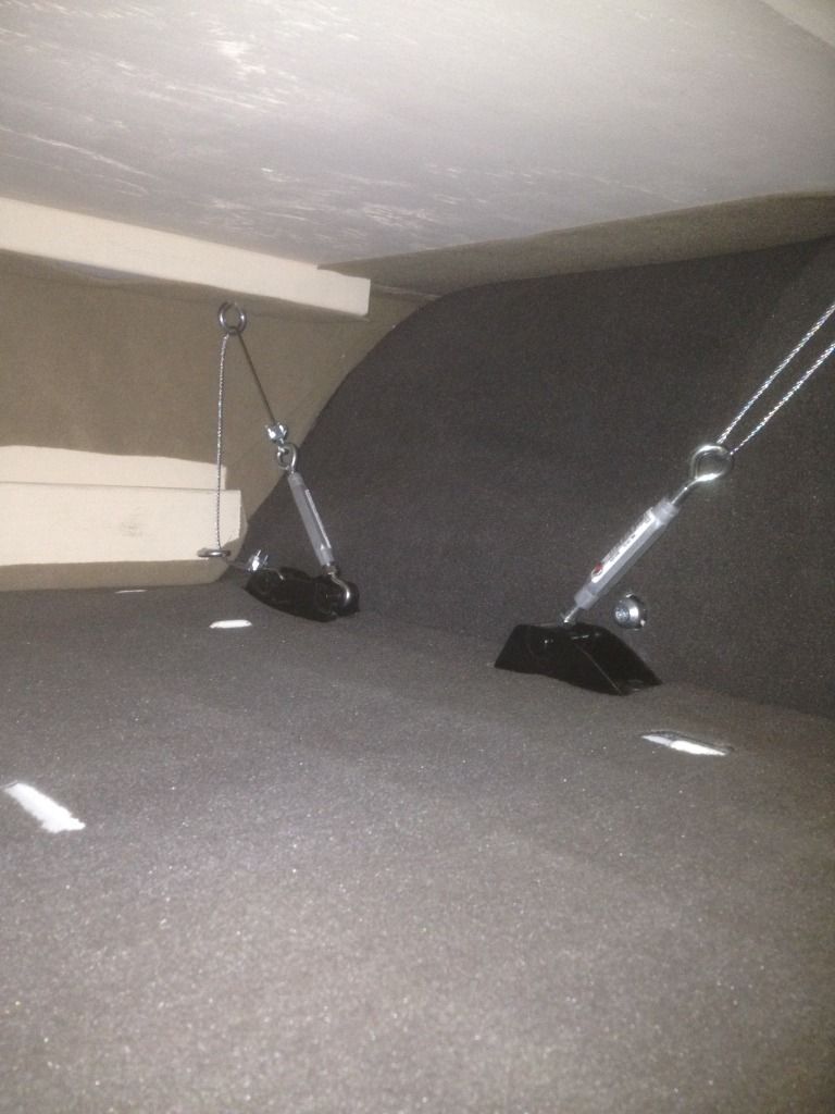

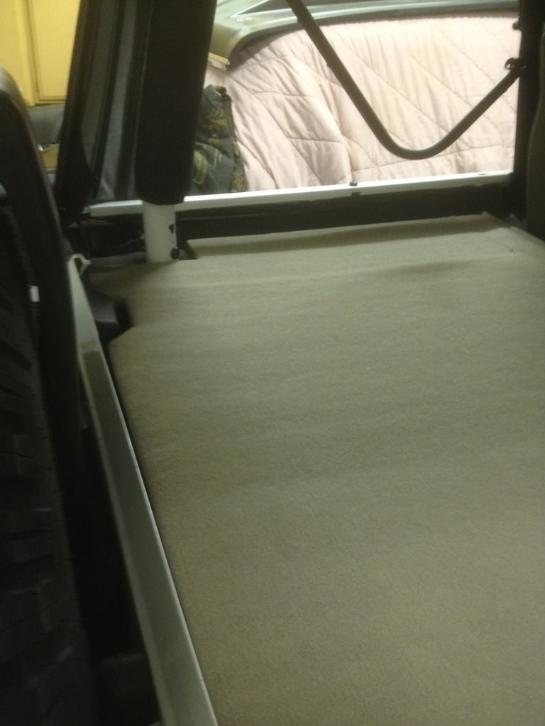

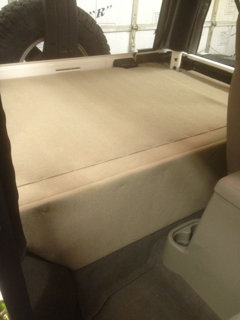

This past weekend I built a cargo cover for my TJ. I've been collecting ideas from threads I found here on JF. I wanted something that would be fairly secure so someone would have to work to steal something as apposed to just reaching and and walking away. This is what I came up.
It should be fairly secure when the back gate is locked. I can remove it in about 10 minutes if I want to put my back seat back in.

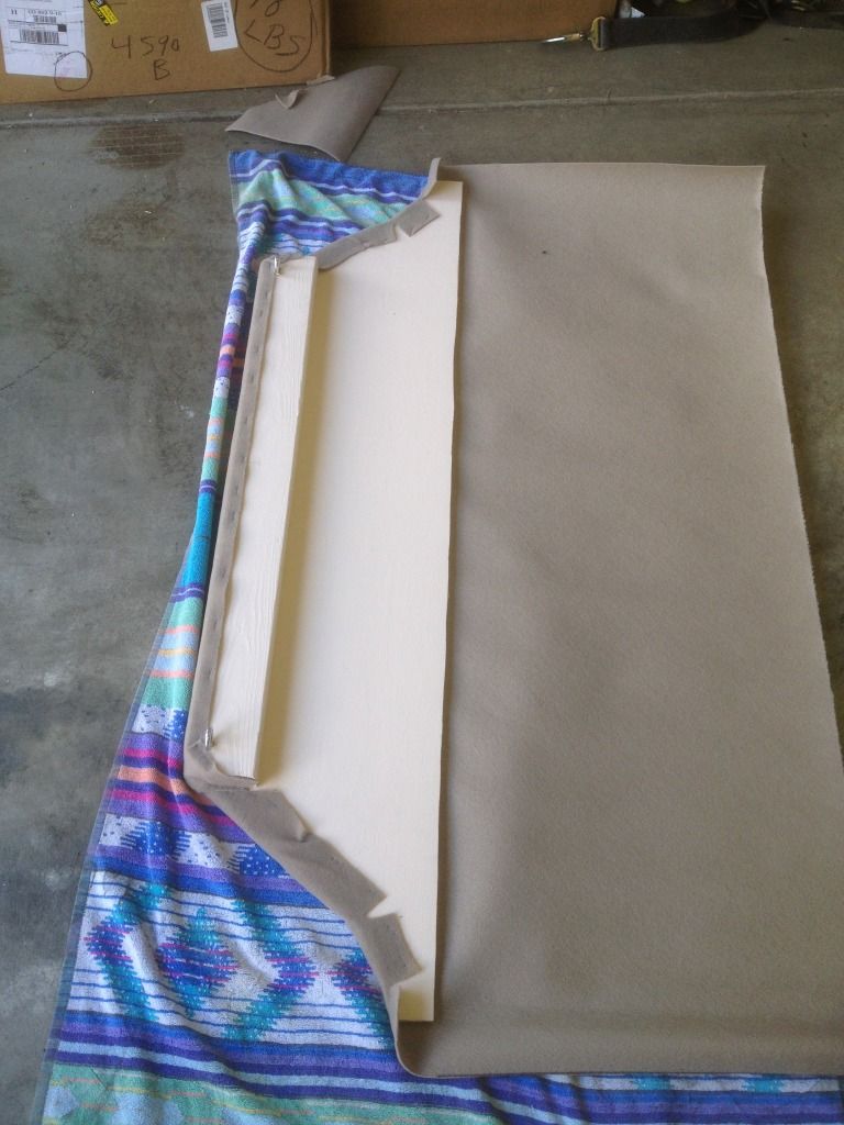

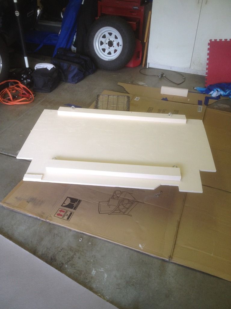

I'll give you what I have. I certainly don't have a sketch as I typically do this stuff by the seat of my pants. I used a couple of 2x4's and a sheet of 19/32 sanded plywood. The top is 54 1/2" wide and 35" deep. Of course it's cut in at the rear to go around the roll bar. Those cuts are 4 1/2" in from the side and 8" in from the rear. The front piece is 54 1/2" wide by 13" deep. The front 2x4 is 43" wide and is mounted at the leading edge of the top so the front piece has someplace to screw into. The rear 2x4 is 35" long and mounted 4" inboard from the rear to clear the door latch area. The 2x4 mounted to the front piece is 35" wide as well. I screwed this all together with some 1 3/4" deck screws.
I used two 3'x6' rolls of cheap carpet I picked up from O'Reilly auto parts to cover it. I used 5/16" staples to hold the carpet down. The whole thing can be installed or removed in less than 10 minutes if I want to put the back seat in. I have less than $75 in the whole cover.
