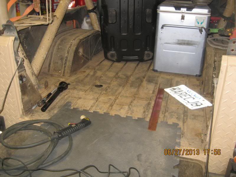

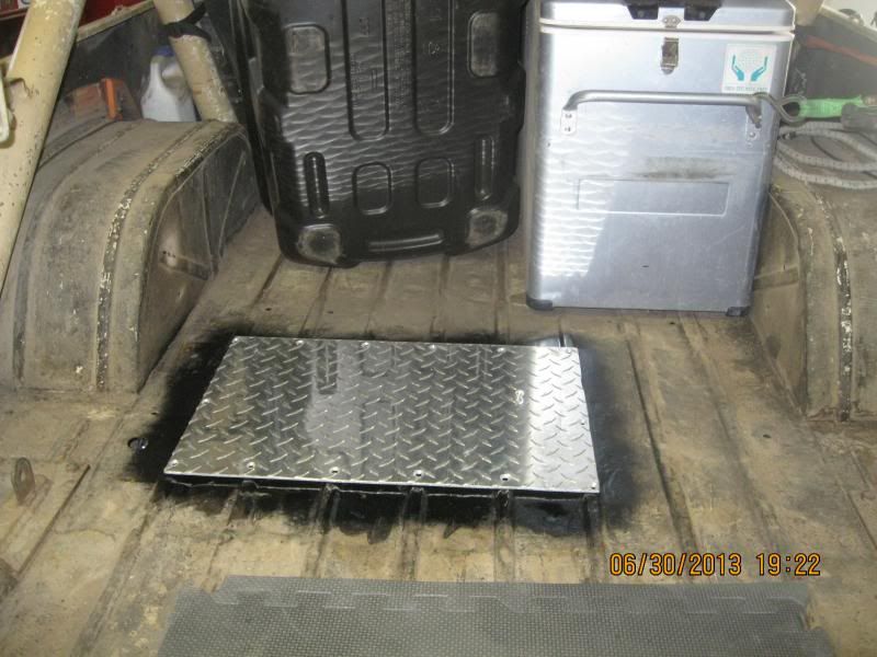

yes. Handy way to access the in tank fuel pump and sending unit, etc etc. No more need to drop entire 33 gal tank. Been there done that 3x. Enough.
Initially thought of a hinged panel but ended up just using a piece of aluminum diamond plate and screwed it down with self tappers. (not the old license place haha) then sealed with black silicone.

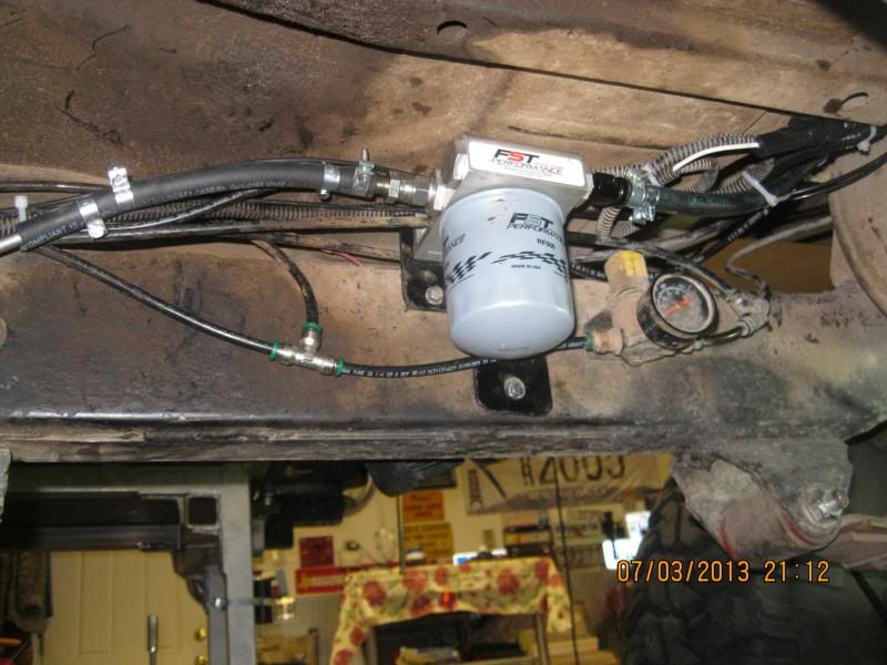

Posts: 2,031
nice video, although i have a CJ... when i did the new upgrades rather than hose clamps i went with AN style fittings. And since the full filter is external on my set up, went with a screw-on fuel filter (much like an oil filter) that makes filter swaps so much less messy and faster. The MOPAR in line filter is a PITA especially when the lines get dried and hardened. Plus hose clamps tend to cut into the line and over time may cause even the slightest pin hole that will soon cause a shut down and its a painful process to locate where the system is losing pressure. Also added an electrical fuel pressure gauge on dash. Sending unit screws onto the fuel rail on engine.
Knowing fuel pressure is priceless to assist trouble shooting.

FWIW inline spin on/off fuel filter
before i hit the floor with the plasma. just marking out the area ---yes, tank was out.
all buttoned up and ready to seal the portal
all sealed up.
EDIT: the self tapper screws are bevel headed and i sounter sunk the holes on diamond plate. flush surface. then sealed the gaps between plate and tub bottom with black silicone.
